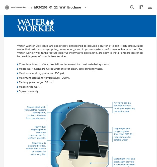

I agree with "The Goose". On the holding tank there is a tire pressure looking stem. If you depress that and water comes out the bladder is ruptured and time for a new tank.
I had heard it referred to as water logged, same principle I guess as the air logged description.
Not correct. Big misconception. Hydropneumatic tanks do not have a bladder. It's literally air over water.
   / What is causing air in house water lines? #33
Interesting. I think Water Worker the maker of my pressure tank didn't get that memo. I thought I remembered reading it in their literature when I installed mine a couple of years ago.

   / What is causing air in house water lines? #34
There are captive air tanks and hydropneumatic tanks. The OP stated he had a hydropneumatic.
   / What is causing air in house water lines? #35
Ah... Didn't catch that. didn't even know there was such a thing.
Thanks for the correction.
Yours is not a hydropneumatic tank, as pointed out. It's a bladder tank, sometimes called captive air tank or diaphragm tank. We use hydropneumatic here for several reasons, one of which is that sometimes the water can smell, and the air-over-water will help dissipate the smell.
