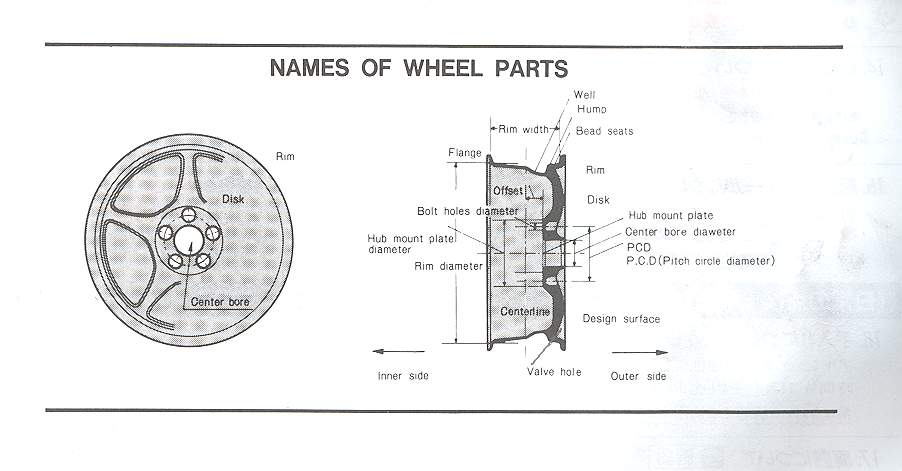

We usually say rim to refer to the wheel because we have solid wheels on cars etc. but technically it's the outer part of the wheel. Think bicycle wheel = rim + spokes + hub.
   / What is a tire, wheel, rim? #3
Wheel parts:
Bruce
   / What is a tire, wheel, rim? #4
Alot of tractors have 2-piece real wheels.
There is a rim, and a hub. Rim + hub = Wheel
Here are rims https://www.google.com/search?q=tra...ved=0ahUKEwjQutC-zsXKAhUCSiYKHZsIC50Q_AUIBygC
Here are hubs = https://www.google.com/search?q=tra..._AUIBygC#tbm=isch&q=tractor+rear+wheel+dishes sometimes referred to as dishes
Aluminum alloy wheels are typically one piece, called a wheel.
Steel automotive wheels are made from two pieces, the inner hub and outer rim, but welded together to make one piece. "Wheel"

looks like a tire with wheel, tire, and wheel to me.
   / What is a tire, wheel, rim? #6
In the industry, wheel and rim both mean the same thing. They have the pictures labeled correctly.
