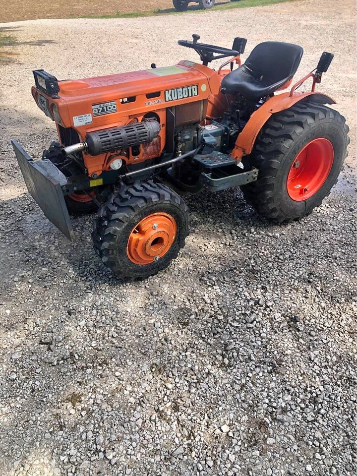

what is a good rough cut rear mower deck match for a B7100 4X4?

My B2150 is not a lot different in capacity than yours. A 5ft bush hog for mowing weeds/grass works very well. I am sure a 5ft finish mower would work well for you.

I am concerned with correct drive shafts lengths, splines ,proper speeds, three point hitch compatible
   / what is a good rough cut rear mower deck for a B7100 4X4? #4
4' and not too heavy for rough cut mower. 42" if conditions are especially tough.
Regardless of brand, you will need to verify that PTO shaft is not too long so as to damage your tractor. Shortening PTO shaft is often necessary with small tractors.
