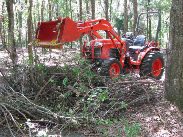

I don't have one, but from what I have seen you might want to consider a ratchet rake for your bucket to help you clear out brambles and brush for that walking path. It can even help with clearing for your garden spot. It seems the owners that have them speak highly of them and they are not all that expensive.
The Ratchet Rake, 52 in. - Tractor Supply Co.
   / What implements do I need?? BX25D + setting up homestead #3
And the Ratchet Rake does light grading with the down oriented short teeth. It will do a driveway fine.
k0ua is correct, as always, on clearing brush and garden.
Had you not purchased a Box Blade I would have suggested a Rear Blade : Angle Blade : Back Blade for grading AND light snow removal. You will certainly need the Box Blade to create the foundation area for your house.
