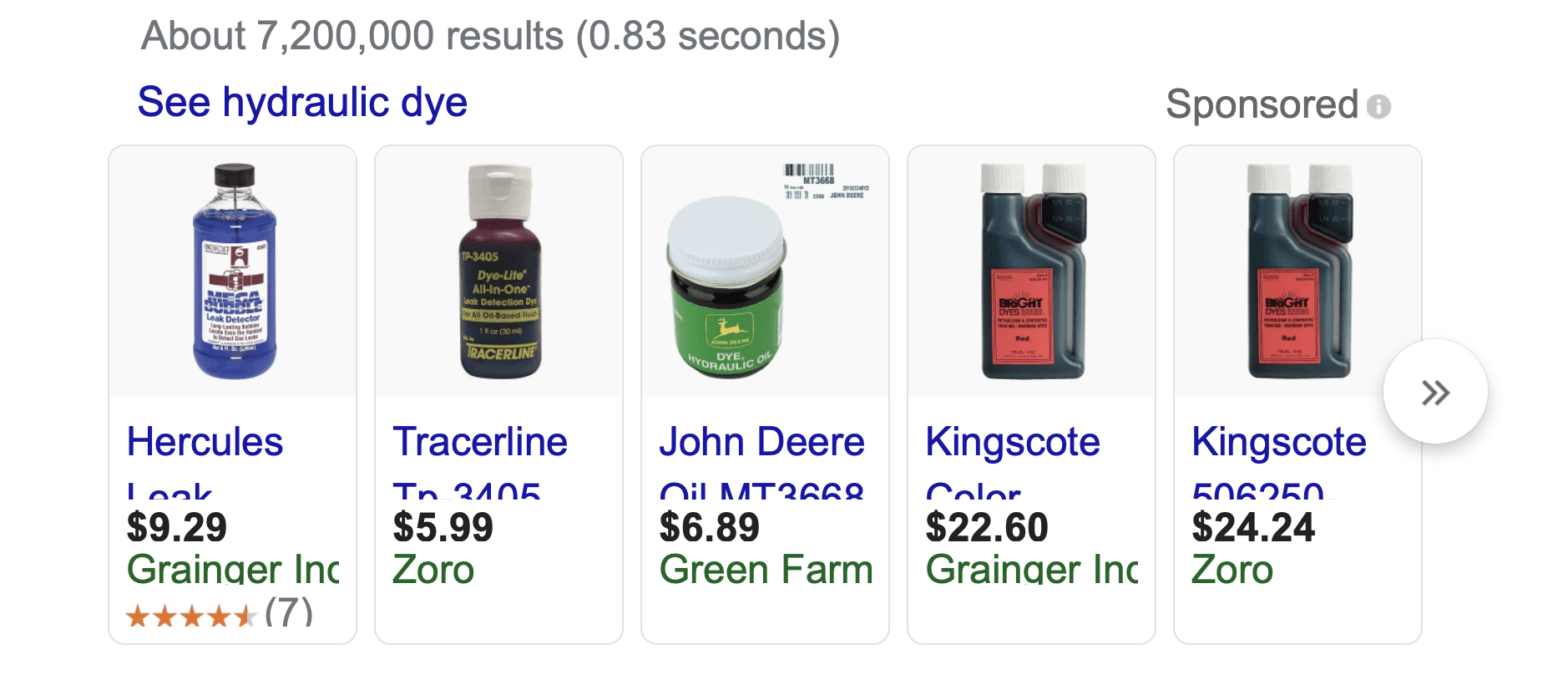

I wish I could find the red dye but no luck here
You could always mail order some.
MT3668
Part Number: MT3668
Part Price: 7.17 USD
Description: Oil - FLUID, HYDRAULIC OIL DYE

DYE.png look here try any hydraulic shop
   / What happens if I added too much Hydraulic fluid on JD 5105 #16
Having the sight glass issue with my 2320 (plow hydraulic had leaked a bit). I wish the sight glass worked better too - never could really see it that well (10 years now). I've just ordered the dye.
