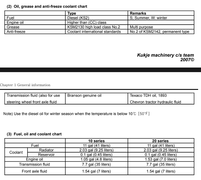

Ive got a new to me 2008 branson 2910i and am going to do a hyd fluid & filter change but not sure what to use in the front axle. Do it take the same fluid or do you use gear oil?
Would like to find an owners manual but no luck so far.

Here's a manual: 10-20 Series service manual.pdf
Interesting:
This specified hydraulic fluid for the front axle.
Here's a thread about using gear oil instead: Has anyone used gear oil in front axle (instead of the hydraulic oil that the manufacturer recommends) AND had an issue?
I suppose you can use either?
Chevron THF1000 is similar to a 15W30, and 80W90 is similar to 10W30. So I guess viscosity-wise, gear oil is pretty similar to hydraulic fluid.
My guess is that a quality gear oil is cheaper than a quality hydraulic fluid... I've gone with gear oil in my 3520 front axle.

I was reading thru that manual and saw that branson recommend the same oil. I'll see whats in the front but will probably use the hyd fluid since I have 10 gal of it.

My dealer recommended gear oil. I think it performs better under high pressure when squeezed between the gears, and has a better additive package for that use. Tractor fluid has to work well with wet clutches and that limits the additives that can be used.
   / What fluid to use in front axle #9
Use gear oil in the front axle, 80w90
Some of the older Branson's had a separate tank for the power steering. I think its on left side. So that's what the owners manual is referring to when it says to use Transmission fluid
   / What fluid to use in front axle #10
I'm using gear oil in mine. But I am using a synthetic. 75w-90 weight.
