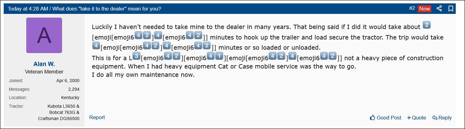

Alan,
No offense,
You may not be aware, but this is how your post appears in the monitor of my PC Windows 11!
Is that really your intention?
No emojis were used. I use the app on my phone and occasionally it freaks out.
   / What does "take it to the dealer" mean for you? #34
His posts appear the same here. Happens with only a few users, mostly Alan W. and tradosaurus.
I think they like to use emoji's from sources other than the forum.
I used no emojis in the post in question. Use the app and it goes crazy at times.
