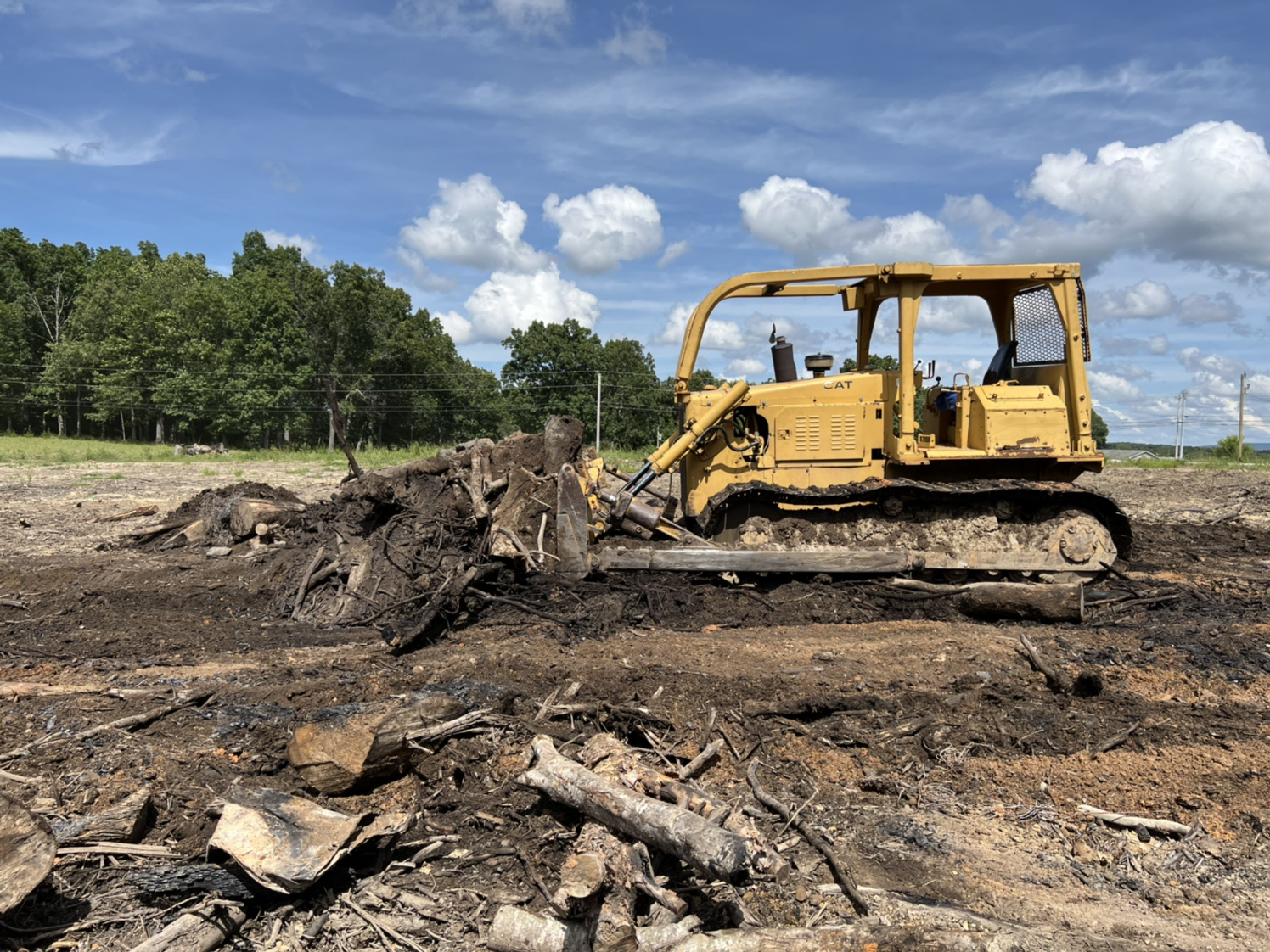

weight has a lot to do with this as well. How much does the john deere weight in comparison to that old steamer?
Weight and traction wins tug of wars. HP doesn’t really matter. Without increasing traction you could increase the hp by 10x without a big difference in the outcome. This is weight and traction at work. Think a pickup with 2x the hp could chain up and drags it?

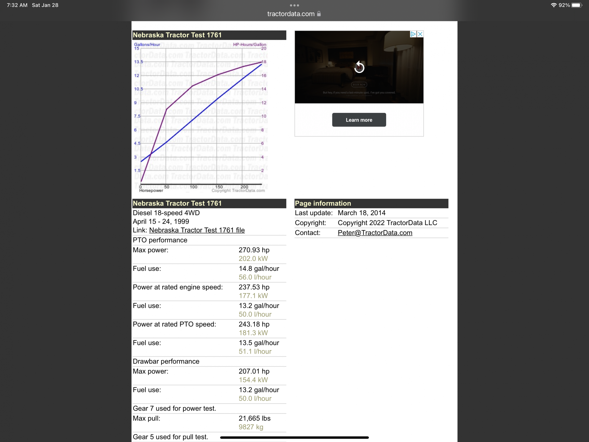

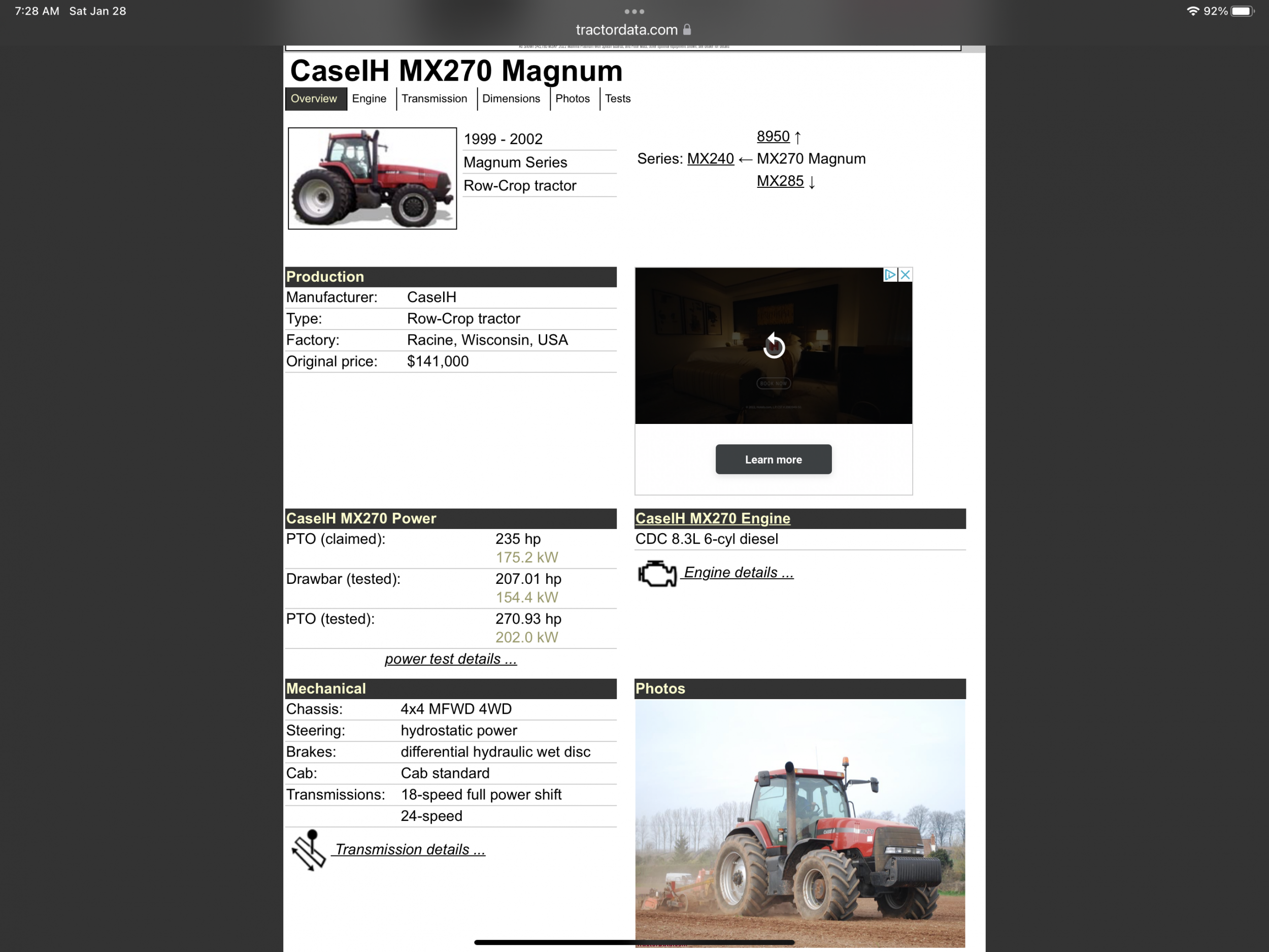

Yes, but the transmission is a huge part of the tractor package.
Drawbar HP is measured at the end of the drawbar, taking into account losses through the driveline. Brake HP is at the flywheel and does not take transmission into account. So they are not the same.
When buying a tractor, on the back end I want to know:
1. how much it will “drag” across the ground.
2. how much power is available at the PTO to run my baler, or whatever the user is running. (baler, sawmill, snowblower, etc)
IMO, on the back end of a tractor, what is most important is pulling power (drawbar HP) and PTO horsepower.
Here is the “Tests” page
On the front end (if loader equipped) what is most important is the lifting power of the hydraulics and the front axle capacity for carrying a load.
Any tractor buyer should consult Tractor Data and pay special attention to the “tests” page. Here you can compare what your tractors will actually do.
****Unknown/unsupported brands aside, I urge all of you to stop buying “brands” and start buying “tests” when you come up with your lists of comparable models.****
The University of Nebraska's tests are very useful but only performed on some tractors, and generally not the ones most people here are looking at.
The University of Nebraska currently only does its full set of tests on tractors of over 100 PTO HP that are to be sold in Nebraska, per state law. If a manufacturer doesn't want to sell in Nebraska, they don't have to have their tractors tested. Tractors less than 100 PTO HP do not have to be tested to legally be sold in Nebraska but a manufacturer can voluntarily have them tested. It is rare to see anything smaller than a full-sized utility tractor tested today and even of those, it is generally only CNH and Deere that have theirs tested. The University of Nebraska will perform an abbreviated set of tests on <100 PTO HP tractors that does not test drawbar horsepower. They hook it up to a PTO dyno and determine maximum PTO power and fuel usage, they test hydraulic pressure and maximum flow, and test 3 point lift.
Thats what i was getting at. The old steamer probably weighs twice or maybe three times as much as that deere.
Still, those tests can tell you a lot more than brand warfare comparisons.
