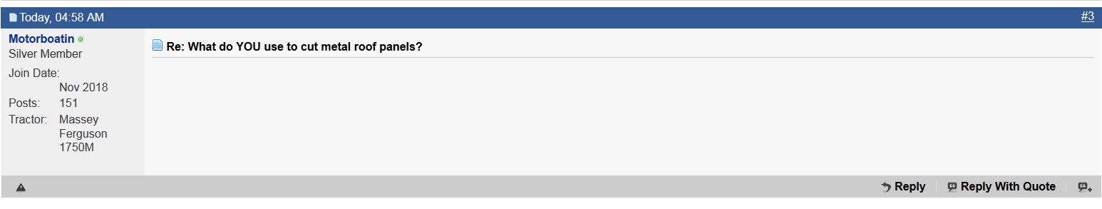

604942d1558001229-what-do-you-use-cut-blank-jpg
That doesn't tell me much.
