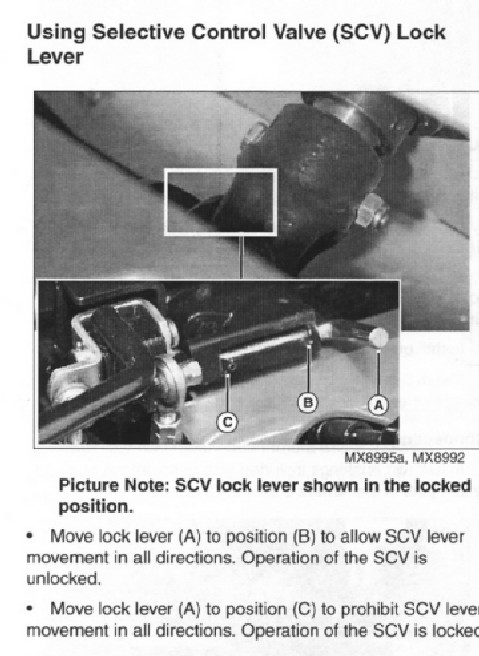

Again, thanks. Pulled the manual back out. Had read this but never did anything with it, other than lube. For the benefit of anyone who missed this in the manual (4110/4115), here's the SCV ("dual") Lock Out Lever section. I don't think this is actually related to "regen"...but all will be easier to discern in daylight.
Tomorrow I'll try position "C" to see what it actually does, and post a pic of where it is, w.r.t. the SCV and seat. It's a bit late, and dark, at this point.
Tom

Tom, That is NOT the Regen lockout, that is the lock for the whole DSCV, you would use this when the loader is off, so bumping the joystick will not send the hydraulics into relif mode.
Take a look at this POST for a good picture of the regen lockout. Also follow the link to the 210 Loader problem post for more info on what the regen does.
And this POST by member KUBMECH has probably the best explaination of regen I have read.
The owners manual does not mention regen at all, nor the lockout device for it /forums/images/graemlins/confused.gif Some dealer's do not even know about it.
