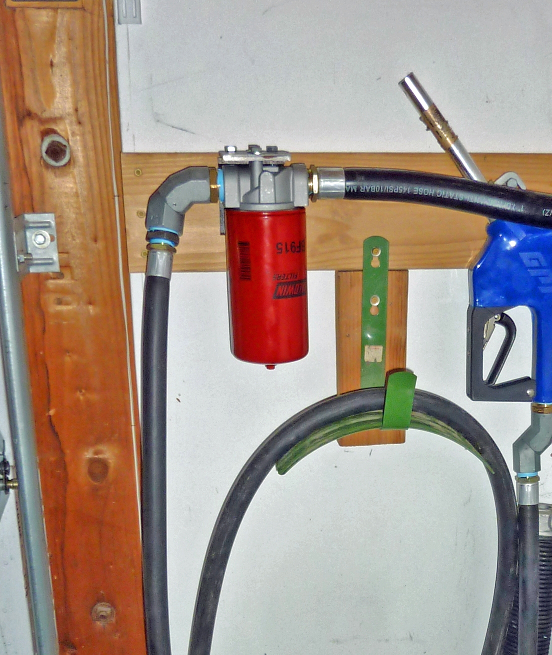

I used to use 5 gal cans and switched to a 26 gal poly tank with a hand pump when they got too awkward for my aging bones to lift. I mounted the poly tank on a cart that I rolled into the bed of my pickup.
My tractors are larger now and hauling the extra fuel became a chore. I don't use enough to have it delivered. I have oil heat and the solution was to install a transfer pump on my 1000 gal fuel oil tank. I installed the filler hose & filter inside the garage next to the door:
Of course this isn't an option if you don't have oil heat.

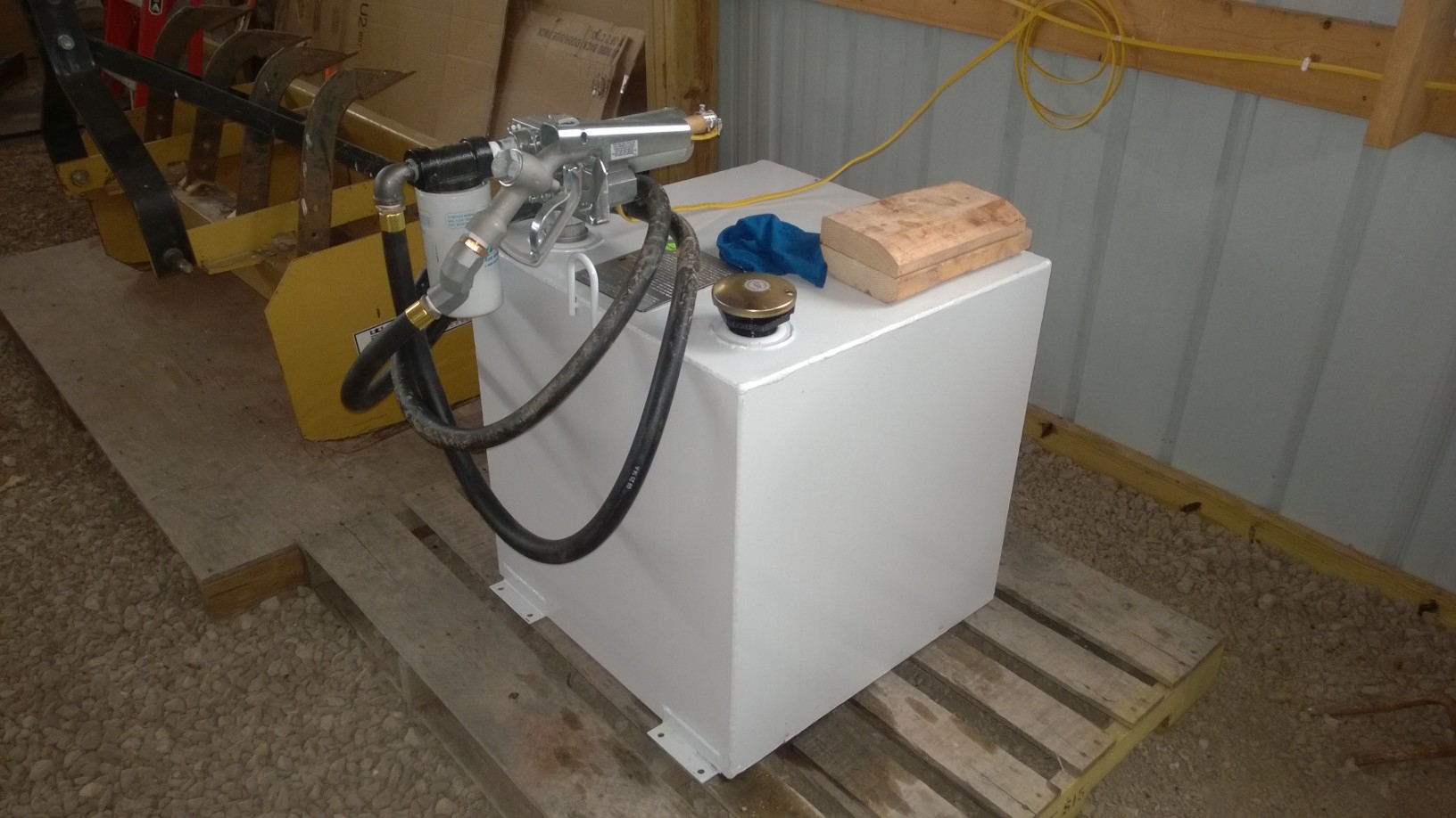

so I can fork it into the pickup and I set it on a custom dolly in the barn to roll it into the using place.

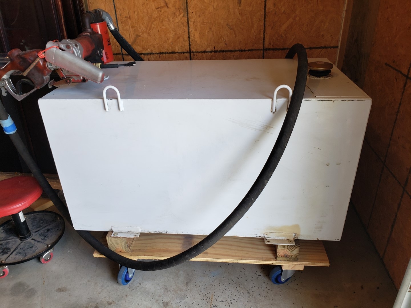

I just acquired an excellent condition Fill Rite 100 gal tank with 12VDC pump, hose, and meter. For the unbelievable price of $200 if you can believe that.
I'm trying to figure out how to move it around and see the hooks on top like your tank has. I don't usually have forks on the front -- have you lifted your tank using the hooks and a chain?

Initially I thought of doing that but the manufacturer said those hooks were only to be used when the tank was empty. Which makes sense as the tank will be considerably heavier when it's full

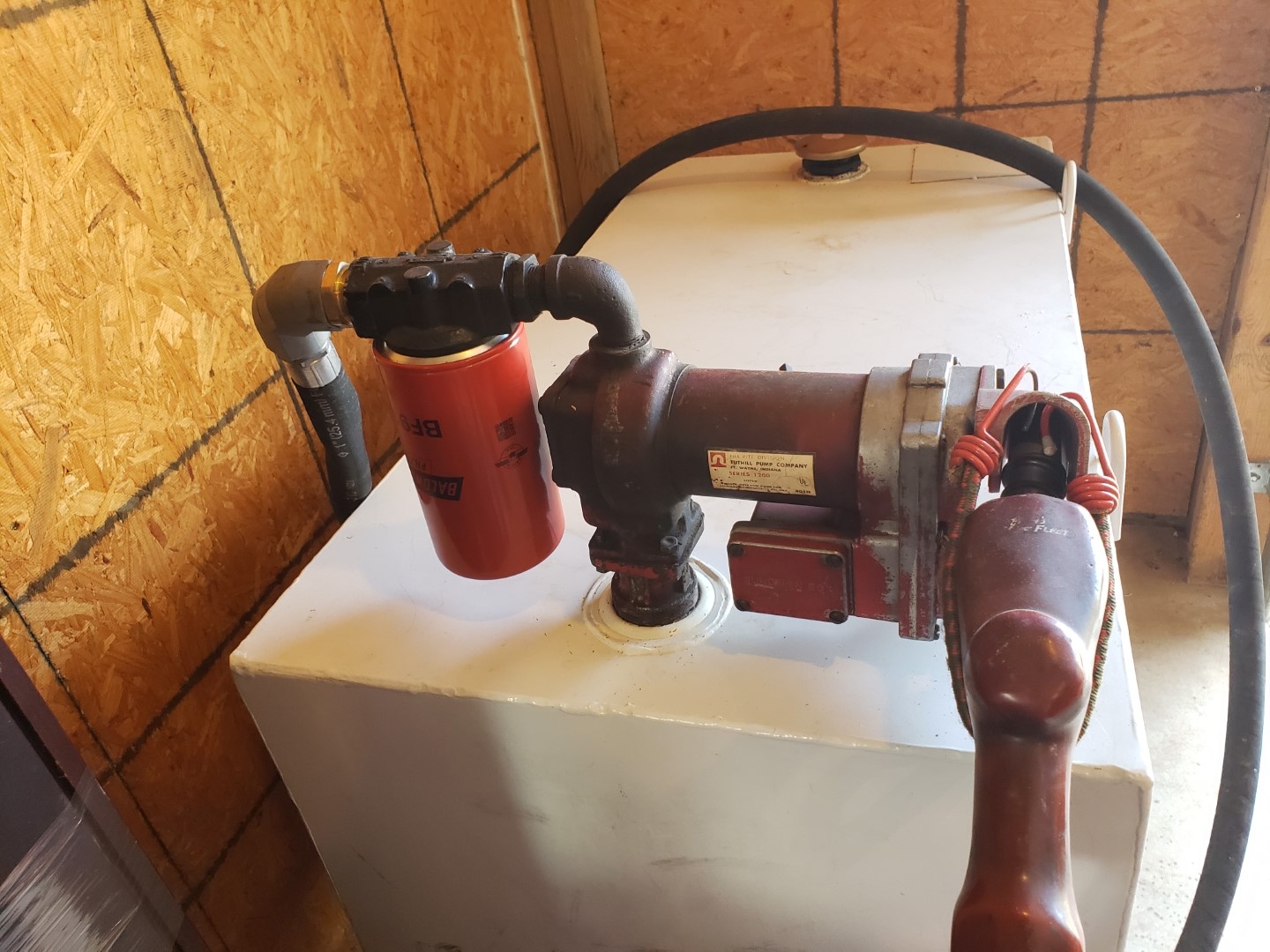

My first filup was only 50 gallons as I wanted to see that everything worked correctly. I found out the pump is old enough that Fill-Rite does not have parts for it, but it does seem to run fine. I filled up my two tractors then tucked the tank away in the corner. I think it will work out for me. I can load the tank in my truck with forks and use the dolly to roll it out of the way when not needed. I do think I will look into a hose upgrade.
