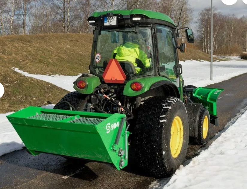

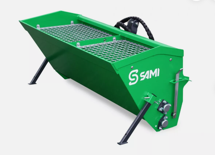

Anyone try one of these bucket / spreader combination attachments?
There are several like this on the market.
Looks like it would also solve the loading problem by letting you back into a pile of anti skid and scoop it up like a FEL bucket.
It could also be used on a FEL with a 3pt adapter and 3rd function valve.
It would work as a ballast box during the summer months.
   / What Do You Use For Anti Skid and How Do You Spread & Store it? #8
It's surprising how little sand or salt it takes to work. I'm not sure how that attachment above distributes the material but I'd estimate that it's a wasteful amount for vehicular traffic unless you were traveling 25 mph.
I do see where there's (possibly) 2 shafts down low, but any sand or stone dust that I've seen really needs to "dribble" on to a spinner and it's distributed over a 14' - 16' lane in one pass and I have a feeling that it's a more city sidewalk foot traffic attachment designed for municipalities.
But that's all a guess! 🙄

I's a drop spreader that uses a rotating shaft with paddles. The drop rate is adjustable but would require several passes to do a wide path. The drop shaft might be preferable to help chew up material clumps which can jam a disk spreader.

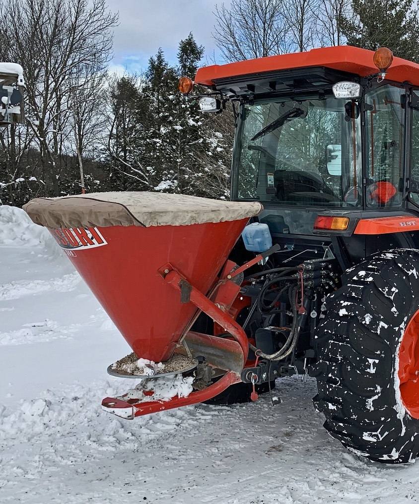

I looked at drop spreaders like that this fall, and they were surprisingly expensive. I opted to add a deflector cone to my existing 3 point broadcast spreader.
If I were just doing my driveway, I would be satisfied with a commercial walk behind broadcast spreader.
All that said, if money were no object I would be running a 4-5' drop spreader similar to what the OP is looking at.
