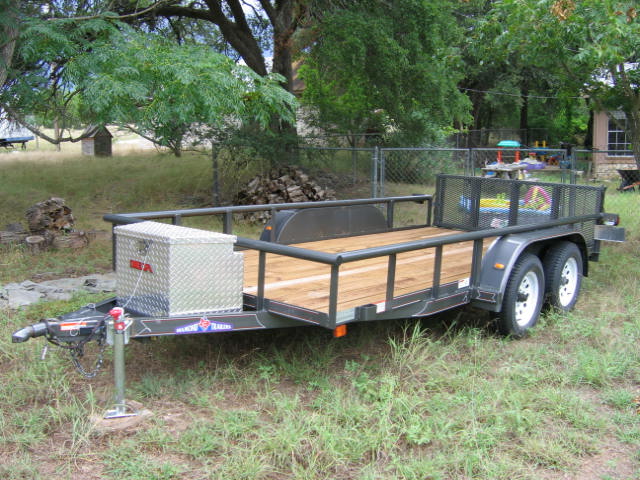

Since we have this new forum I thought we should introduce our trailers to each other. I am also in need of a trailer so I figured this would give me some ideas. :D
I currently have a 5000# trailer that is just a little to light duty for my tractor.

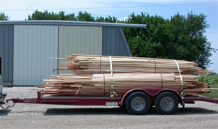

Tow vehicle: 1996 Ford E-150 conversion van, towing package, w/ 8 ply tires, cat III/IV hitch, 2" ball,
Trailer: Target brand, 18 ft, w/ 2 ft dovetail and slide in the side ramps, dual axle, dual brakes, stake pockets, no side rails, 7000# gross weight, trailer weighs 2200#.
Tractor: Kubota Grand L3130 w/ FEL , ~4800# approx.

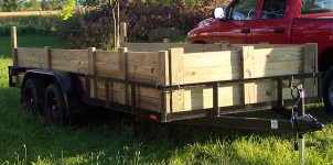

I have a 2003 Dodge 1500 Hemi and a 7000lb GVW utility trailer. Trailer weighs about 1500lbs, so that leaves me 5500lbs for weight on it. I put the sides on it to make it more useful for hauling lumber or gravel. They also help with visibility. Without a gate or stand up ramps it is very hard to see this trailer from inside my truck if it doesn't have a tall enough load on it.

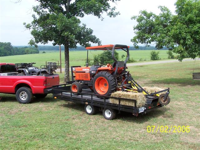

Truck is a 99 F250 4x4 crew cab long bed v10.
Trailer is a home built sled, 7.5' wide deck with removable sides and is 14' long. Trailer is 5c 6.71#. I love the big wide deck. If anything I should have gone 8' deck. Lenght might nave been nicer but 16 wouldn't have done me much good, 18 to make it worth my while but this works fine.
It's first trip home for a 4th parade and some BHing around the neighborhood clubhouse. Worthy of note in the pictures, with a long bed truck and a TSC 12" toolbox, I can still get my Rancher in and close the tailgate.

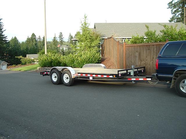

I have a 1998 chev 1500 4x4 with the good ol' 350 that gets about 11 mpg towing the tractor and has 147,000 miles. I equipped my pickup long ago for towing RVs and this tractor with trans temp gauge, vacuum gauge, high rated LT tires, stainless braided brake lines, etc. I tow my tractor a lot and this setup works very well. An RV of less weight tows much worse since there is greater air resistance.
I have weighed at closed weigh stations a few times and have found 6500 on the trailer tandems and 6500 on the combined truck axles. I shoot for about 10% tongue weight and this PJ trailer tows like a dream with no sway and no porpoising. The trailer weighs 2500lbs with two braked dexter 5200 lb axles for a GVWR of 10,400 and a cargo capacity of just shy of 4 tons. The trailer deck measures 18' long including 2' dovetail. Slide in from the side ramps, recessed trucker style sealed lighting, and removable diamond plate fenders. I use a 10k# rated WD hitch, a 3/8" chain and binder at each corner, and carry the spare trailer tire in the pickup until I can figure out a way to mount it to the trailer. The trailer tires are big and E-rated.
I bought this trailer with a decent safety margin and room to grow. The 7000 lb GVWR version was much cheaper but would have been nearly maxed out. I am very proud of this trailer and have yet to find a fault.
