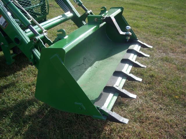

I hang 6 suitcase weights on mine and use it in lieu of a ballast box....as it's fairly compact (5'er). The weights help it to penetrate when grading too. The weights hang securely on the frame and on the sides of the BB. Add about 300 lbs out back plus about 350 lbs ? for the BB.
I have a receiver hitch on the BB and on my loader bucket for towing trailers. I have a ball mount with a 6" drop (shown) which works pretty good on either end of the tractor.

foggy1111 said:
I have a receiver hitch on the BB...
Good idea. I could use my winch with that too.
