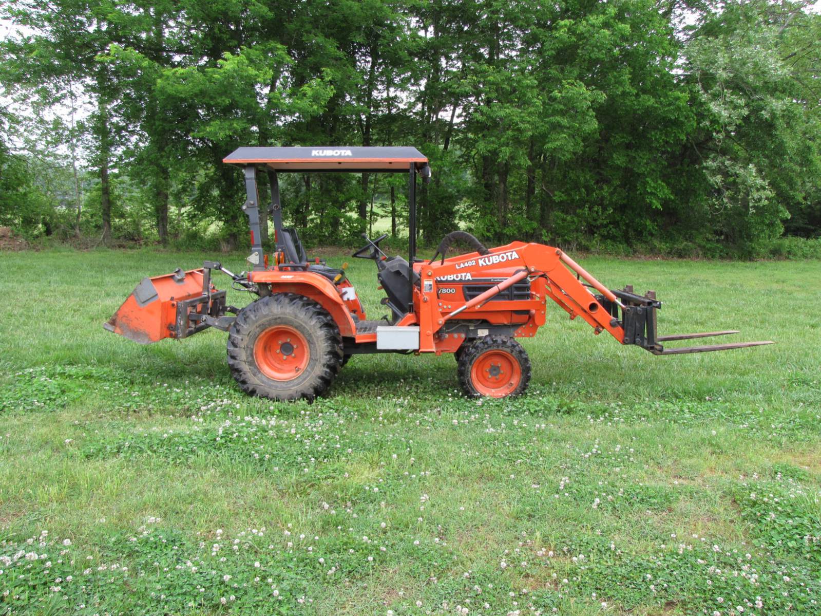

Here is how I did it.

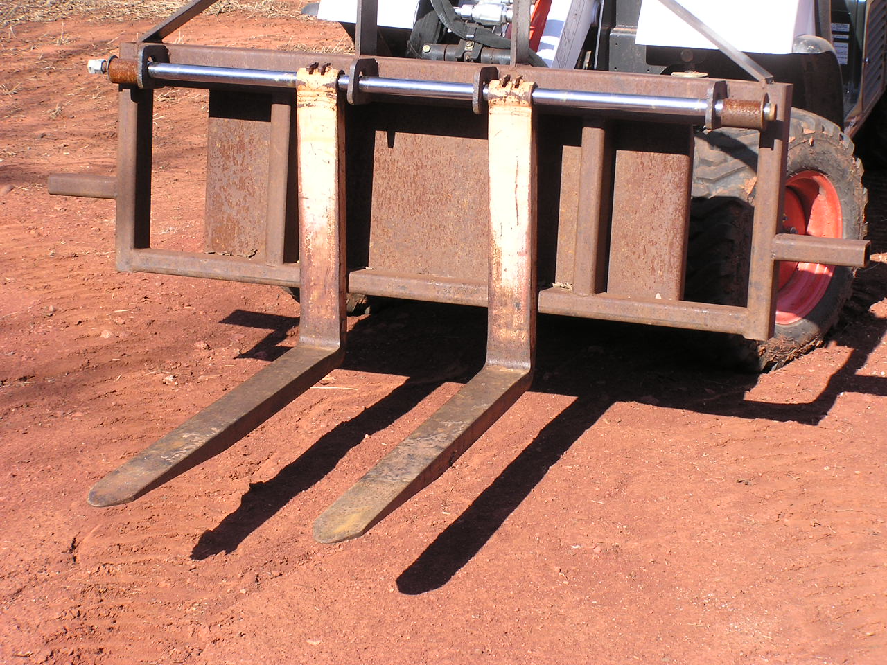

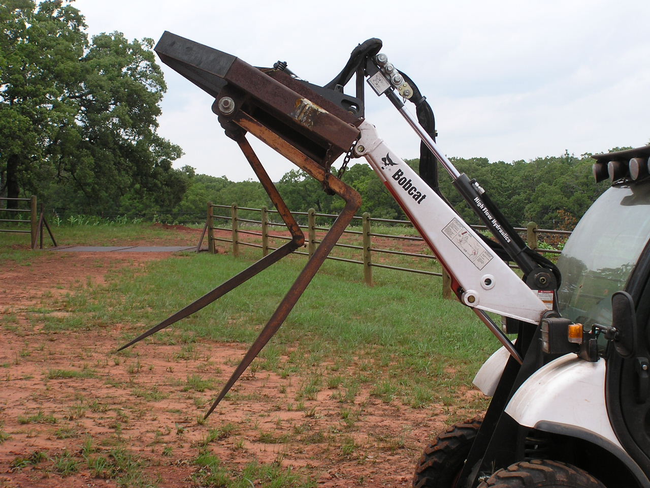

I prefer the pin style forks, they work better on uneven ground and are easy to adjust sideways.
These are 42" long, on a SSQA. Wrap a chain on them for dumping the load.

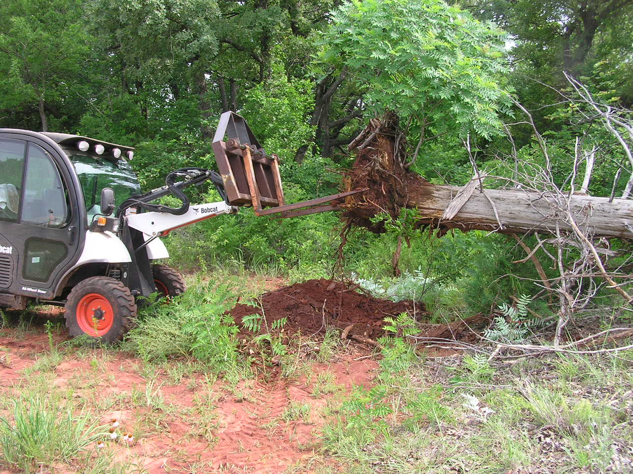

Used the tips to scrape dirt off of the root ball, then raised it up and dropped it to get more red dirt off.
Picked it up with the forks, headed toward the brush pile.
Leejohn-
Thanks for the photos. I am very interested in learning more about your set up.
Where did you buy them, how are they installed-pin on, etc.?
Thanks-John
   / What do you do with your forks? #20
The clip on forks I have are made by Payne and are a very good quality they are the light duty ones. They are extremely heavy for light duty forks. My quick attach forks are made by ansung. I purposely purchased this brand because they were some of the lightest weight quick attach forks with the highest capacity that I could find. If weight would not have been an issue I probably would've purchased the Titan brand. Whichever ones you choose make sure they are very easy and quick to put on and off. I switch back-and-forth a lot for what I do and would not want to have to deal with changing pins on a pin on style. I would look into converting to quick attach as my first choice and then clamp on forks as my second
