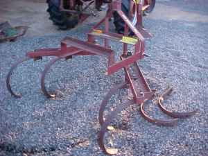

Tillers work wonderful for turning pasture into beautiful smooth gardens and I used one for many years with great success. The problem with them, though, is that they create hardpan, a virtually impenetrable floor of hard dirt below the fluffy soil. Roots have a difficult time getting deep into the ground, and drainage starts to become an issue. For that reason, I stopped using a tiller several years ago.
My favorite tool by far for preparing new beds is a chisel plow. I bought a used one for $200 and it works wonders. It digs deep and roughs up the soil. 3 or 4 passes with it, and the gardens is completely ready for planting, and there's no hardpan issues to deal with. Here's a picture of my plow with two of the shanks removed. Here's also a picture of a new garden that I just broke ground on a few days ago. That was about 3 passes with the chisel plow there.
