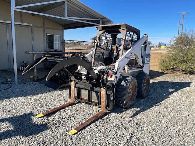

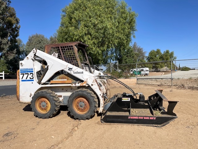

I bought a used 2005 773 Bobcat yrs ago. First thing I look at is the hr meter. If it's high or not working I walk away. Next I look at the general condition and care of the machine. Signs of abuse or neglect are deal breakers. Mine was about 10 yrs old with 3500 hrs, all new filters, fluids, and tires. I have replaced the seat and a couple of hoses in the time I've had it. Right now I'm sitting on all new filters and oil waiting for a major service.
I used to use mine for manure handling but now it's mostly used for brush mowing. You can do most anything with a 4wd Tractor and SS on hand.
