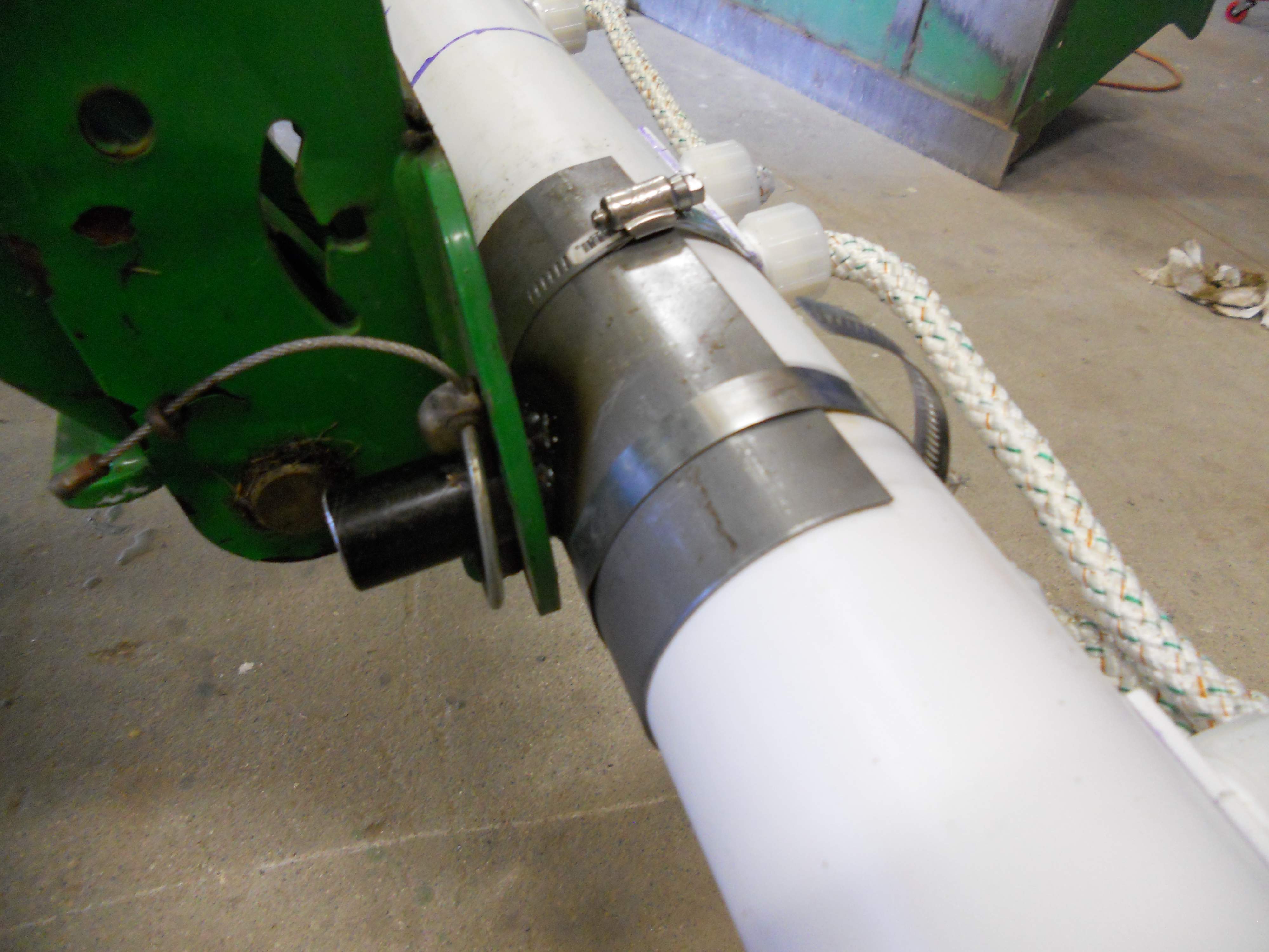

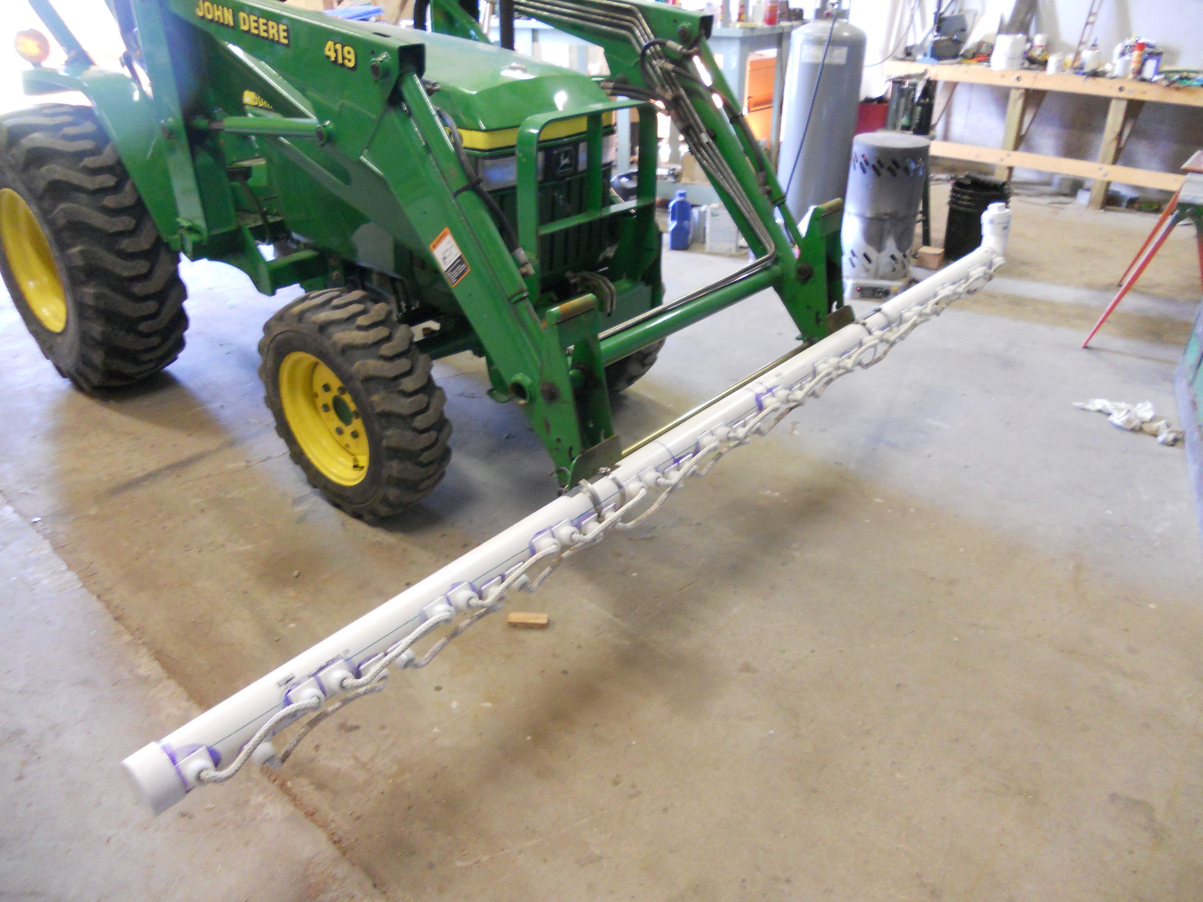

Rodgers Sales Co company in Lyon Ms is where I got mine. Its in kit form an you simply buy a piece of pvc pipe and some glue, layout the position of the holes and drill away. The kit has excellent instructions. I did find it better to drill the pvc pipe with a step drill. It does the job a lot easier and cleaner. I also added quick attach brackets for my wiper as I wanted to run my wiper from my bucket arms. It is a lot safer to get close to fence posts with the wiper in front and you can also curl the wiper putting the wicks facing down causing more roundup to be applied.

Hmmm, might have to setup one of those if ours comes back.
