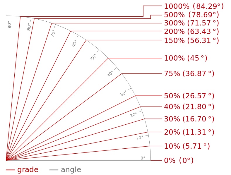

How steep are you talking? I have 118 ac of prime WV hillsides, only flat spots are where the house and barn floors are... And at 100+ years old, a marble wont sit still on that!
Ive found that I can climb/descend 45 ° slopes, and sidehill 30 °. If I cant get on ground with the tractor at those slopes, it isnt going to be useful to me cleared as pasture or hay fields. What can you use ground for thats so steep you cant clear it with your tractor?
What about making your current tractor more slope friendly? I spaced out my rear wheels 9" wider, built a full roll cage ROPS, and carry railroad track in the loader bucket for front ballast.

Are you sure about that? And is it really degrees instead of percent.
   / What do I get to mow steep fields [while sitting down] #6
This may help.
Bruce
   / What do I get to mow steep fields [while sitting down] #7
This may help. <img src="http://www.tractorbynet.com/forums/attachment.php?attachmentid=484601"/> Bruce
That's more believable, but he had it marked as percent.
   / What do I get to mow steep fields [while sitting down] #9
Yes, i measured my slopes in degrees, with an angle finder. 45 degrees feels like straight up and down, even though its only half way to 90 degrees !
   / What do I get to mow steep fields [while sitting down] #10
Man, I'd like to see pictures of that. Are you sure it wasn't reading in percent.
