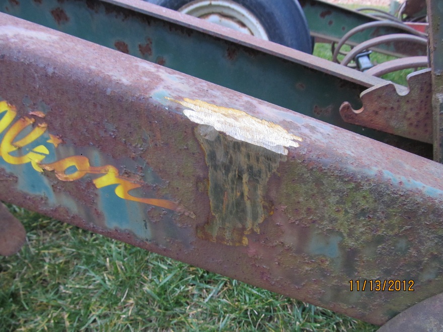

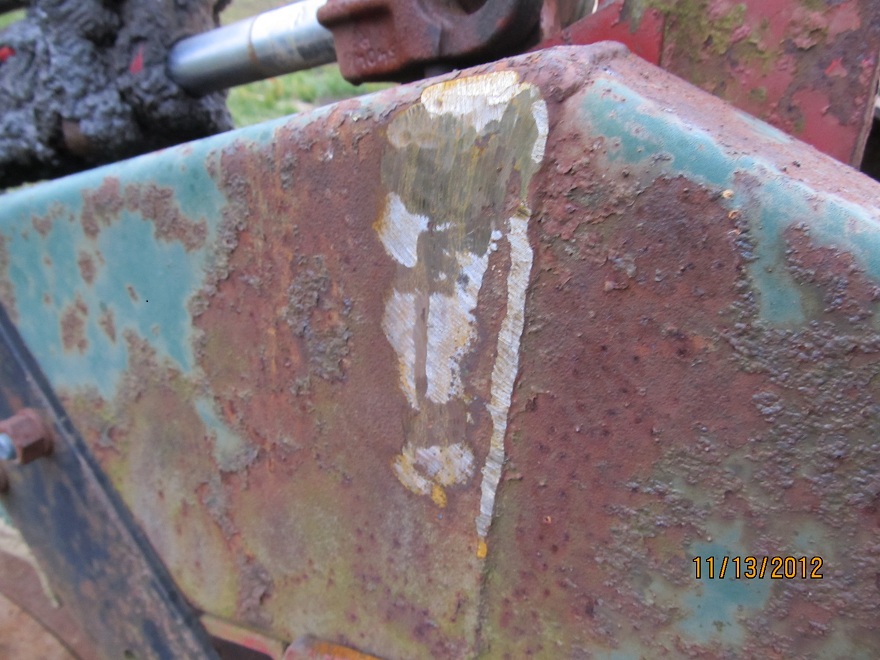

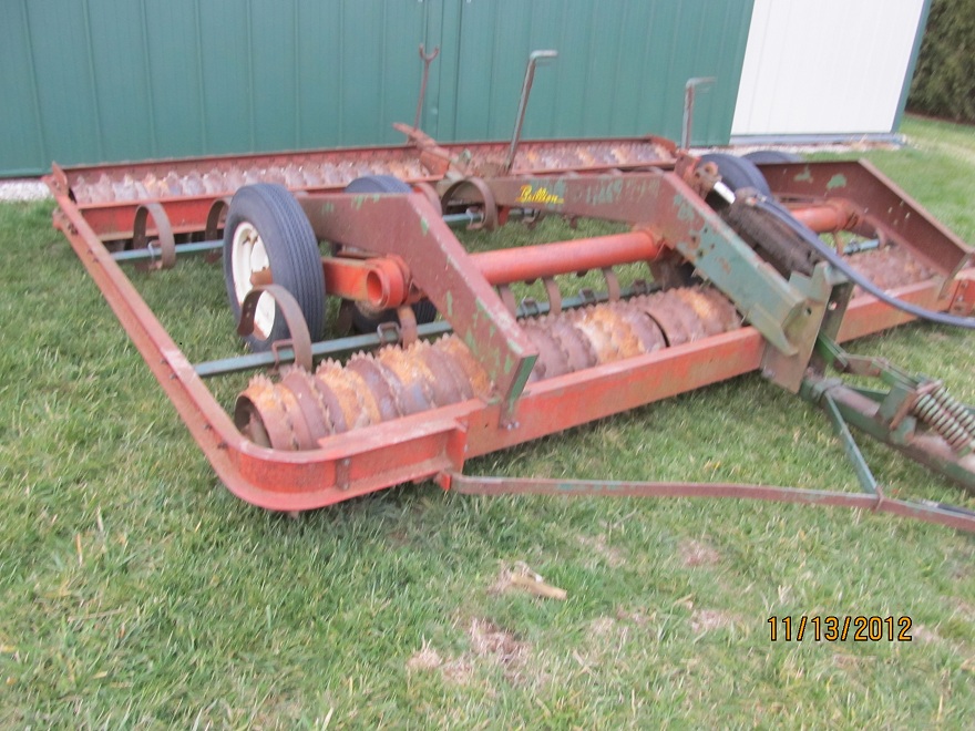

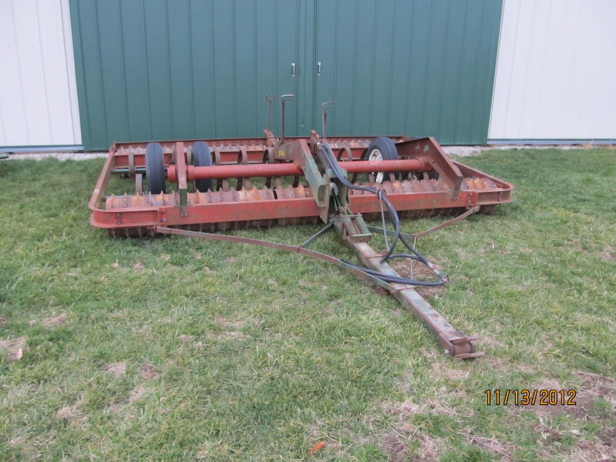

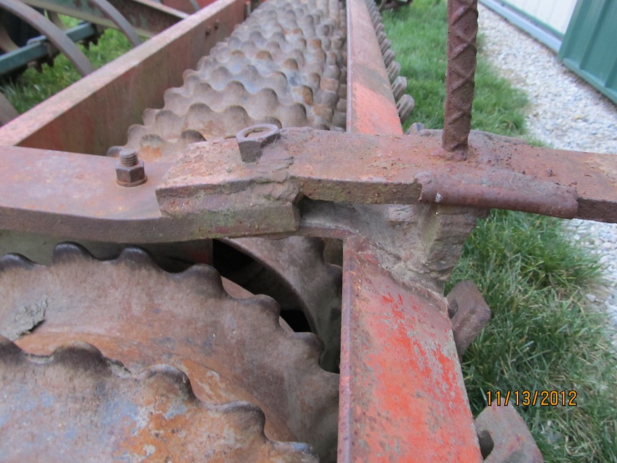

Went to an auction and this followed me home. Brillion 14 ft cultimulcher. Kind of crappy now but I'll clean up, cut off the sloppy welds and paint in the spring.
Checks photos of messy "hitch" welded on the back plus some spots where I already hacked or ground off some really bad welds.

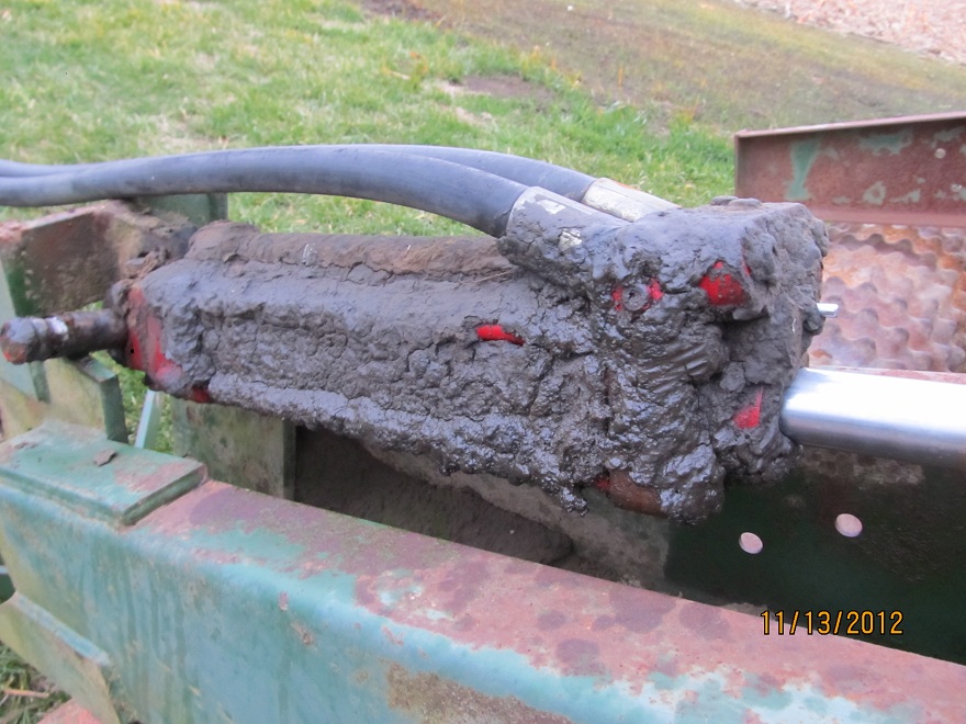

Hydraulic cylinder is the greasiest I have ever seen.

I agree on the cylinder, greasiest I have seen too. That is a very nice piece of equipment overall though; hope it serves you well.

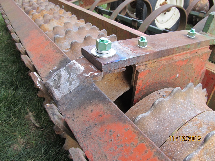

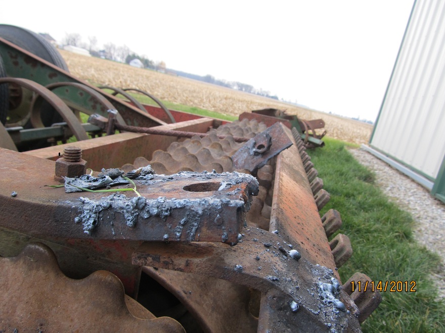

   / WHAT DID YOU DO TODAY ? #613

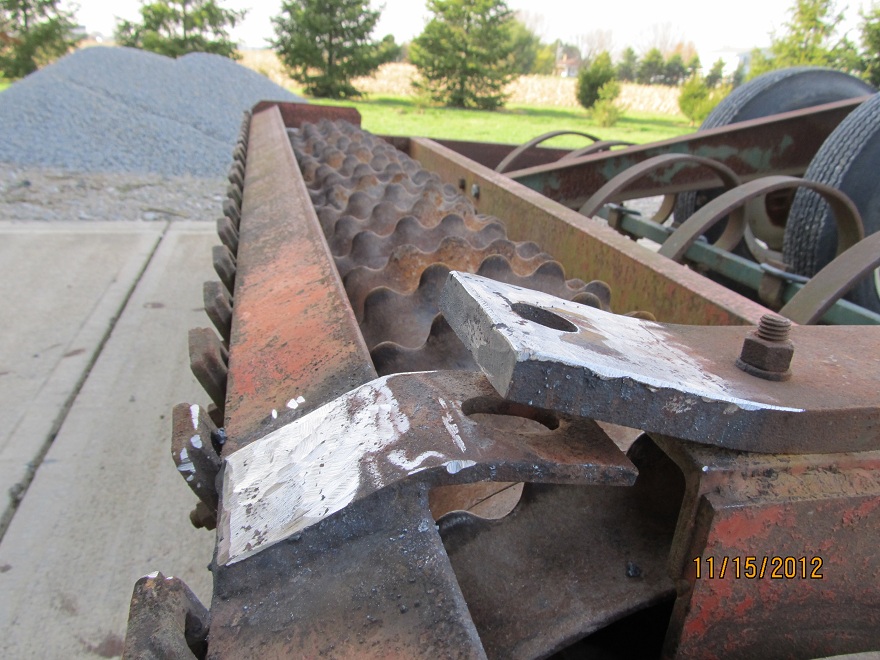

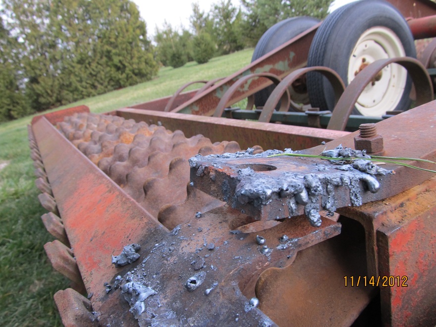

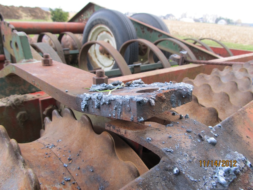

Torched off the poorly welded add-ons shown in the photo a couple posts earlier. Really thick metal but came out OK.
Tomorrow will clean off the weld slag and see what happens. Paint in the spring.

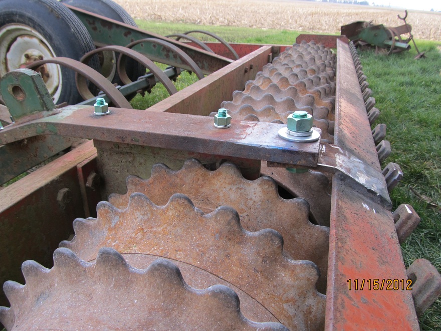

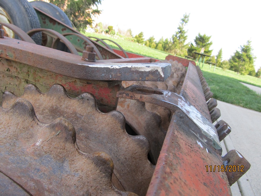

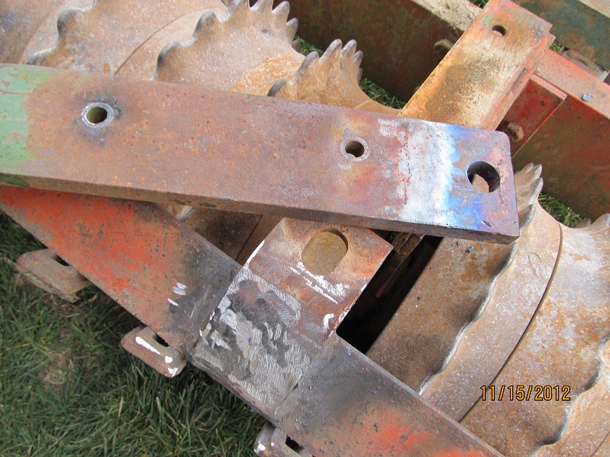

   / WHAT DID YOU DO TODAY ? #614

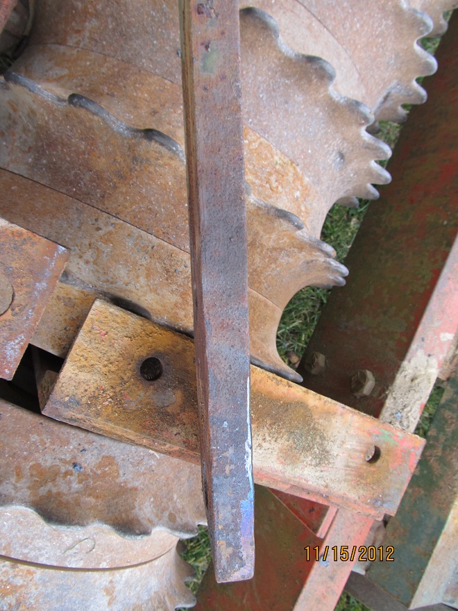

In the above posts I learned I needed to straighten the 1/2" plate on the cultimulcher to put things back to the way they were. Photos show the piece not fitting right with a before and after. The prior owner must have bent it up to weld that mass of metal on. After researching, the right way was to bend that plate back so I torched the bolts off, removed it and heated and hammered the thing flat on an anvil and put it back together. Also added a different hydraulic cylinder and called it good. I'll come back to things in the spring and repaint plus change the tires for something more dependable.
Before, ill fitting...
Straightened piece
Done and back to the way we were...new bolts and all.
Nothing beats rebuilding old equipment...try it.
