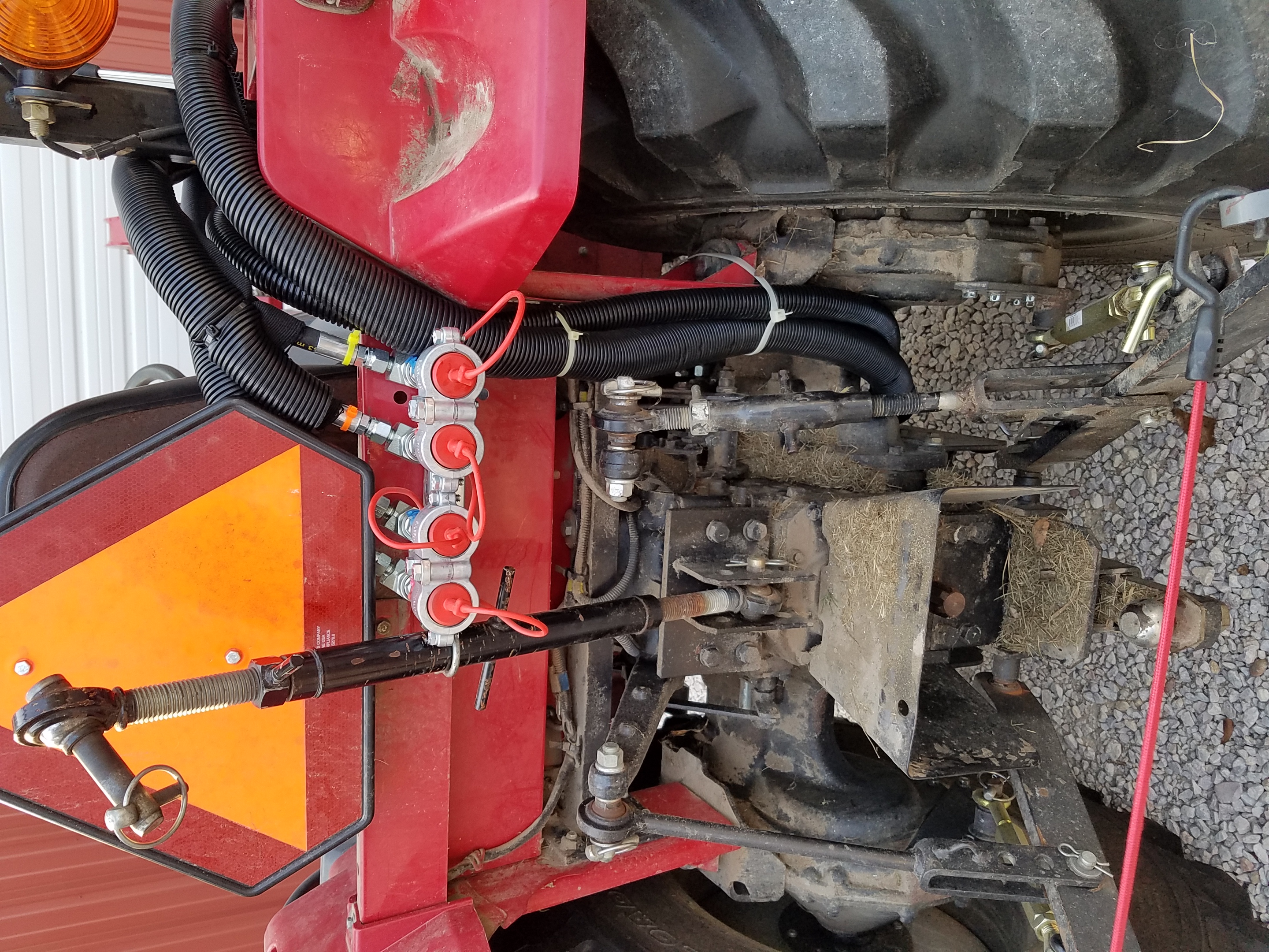

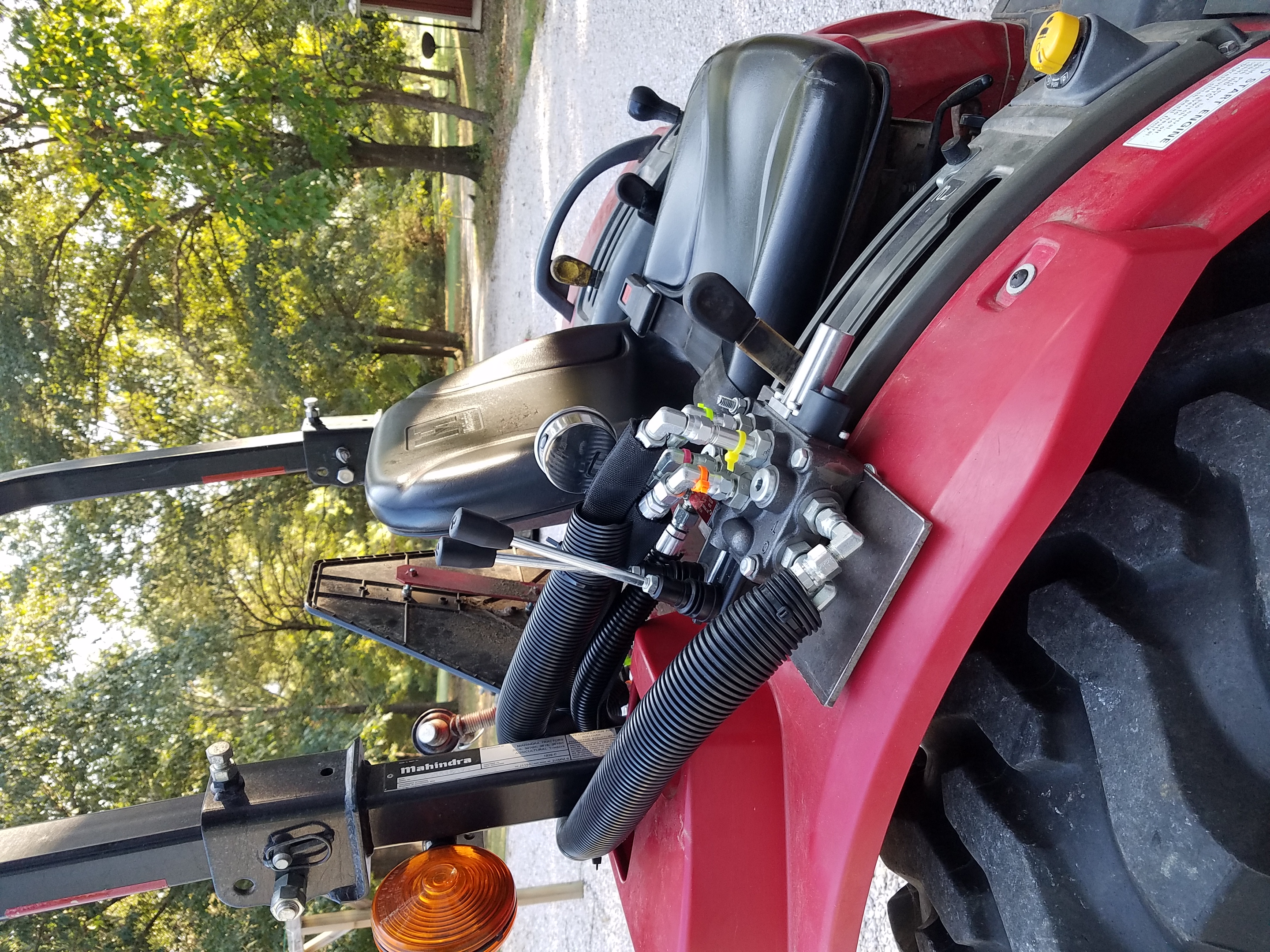

Finished Rear Remotes
I finally finished the installation of my two rear remotes this afternoon. This is the first time that I did any hydraulic work, so it took a while longer than it should have. I installed a pressure gauge to set the RV and decided to leave in-line for now.
Where the operator could exposed, I used plastic wire loom over the nylon hydraulic line protective sleeve to give an extra measure of abrasion / leak protection. I also used the two-wire braid which was probably overkill (5000 psig hose in a 2205 psig system). After reading about hydraulic injection, I got a little paranoid about leaks. I may see about building some type of enclosure for the valve and gauge.
My primary use will be for an offset flail mower, so one spool is float. I also have long hoses to run up front for a grapple. I plan to get a detent kit for the non-float spool for possible Lane Shark use.

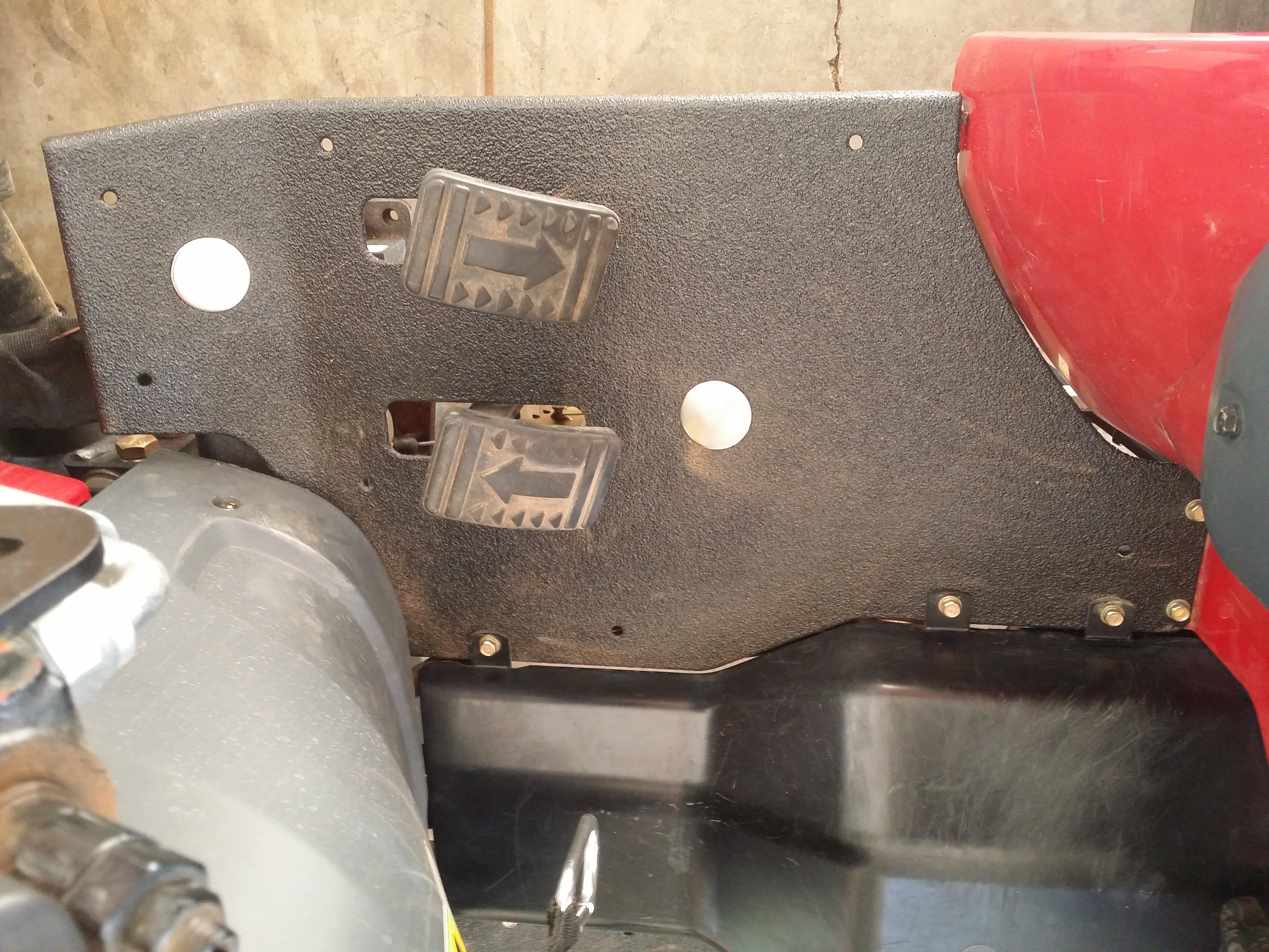

Over the last couple of weeks, finishing up today.
Replaced the rubber mats that always shifted and trapped dirt/sand. I had some warranty work done on the truck bed and took the two foot rests off the tractor and had them sprayed. Went to Lowes this morning and picked up some 1.5" chrome (bling) press in hole covers. Now the bolt holes won't fill with dirt.
