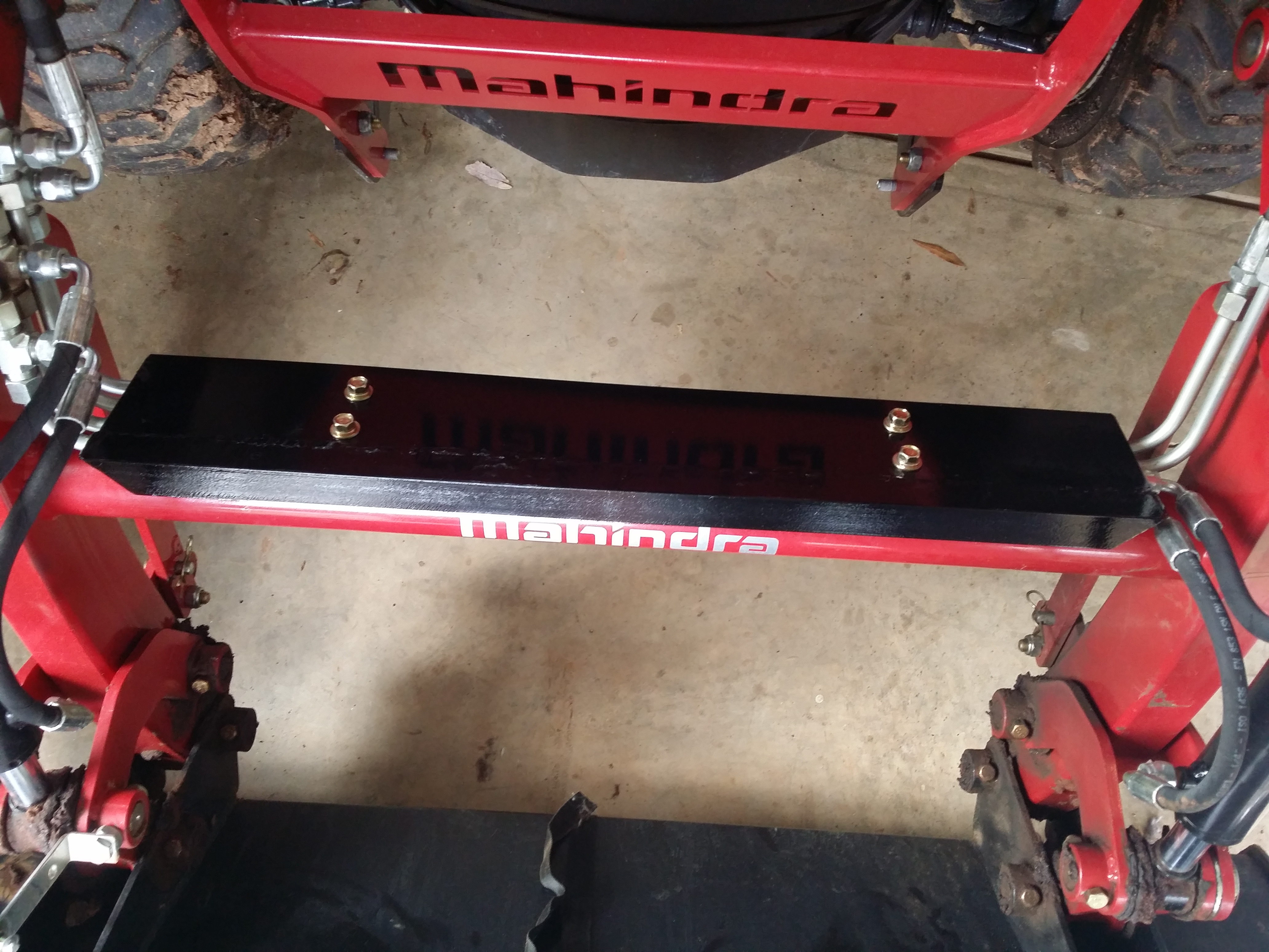

The loader hydraulic lines run across and above a tube. I've ocasionally have rocks and such roll over the top of the bucket. Nothing has hit the lines yet, but a few times it was close. I just keep imagining the lines getting dammaged. Using a 4" wide 3/16" thick scrap sheet I cut it to 25" long. For the front edge I used an 3/16" 1"x1" angle. Welded the angle on top of the sheet metal to form a protective lip that covers the lines. The welding is not the best but I was able to clean it up and paint it. Turned out to be real sturdy.

:thumbsup: Good job! Painted red, folk would think it was factory.

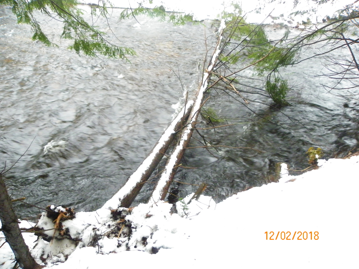

It was raining hard so I didn't take the camera but we (the wife helped) took the trees in the Brook out this morning with the Mahindra 4540 with a cable,d-shackles,snatch blocks with two tree savers. Once I made a cut in the trees it was very easy to drag them up the bank with the tractor.
The rain has turned over to snow so I'm heading back out so I can check our property for any downed trees across the trails.

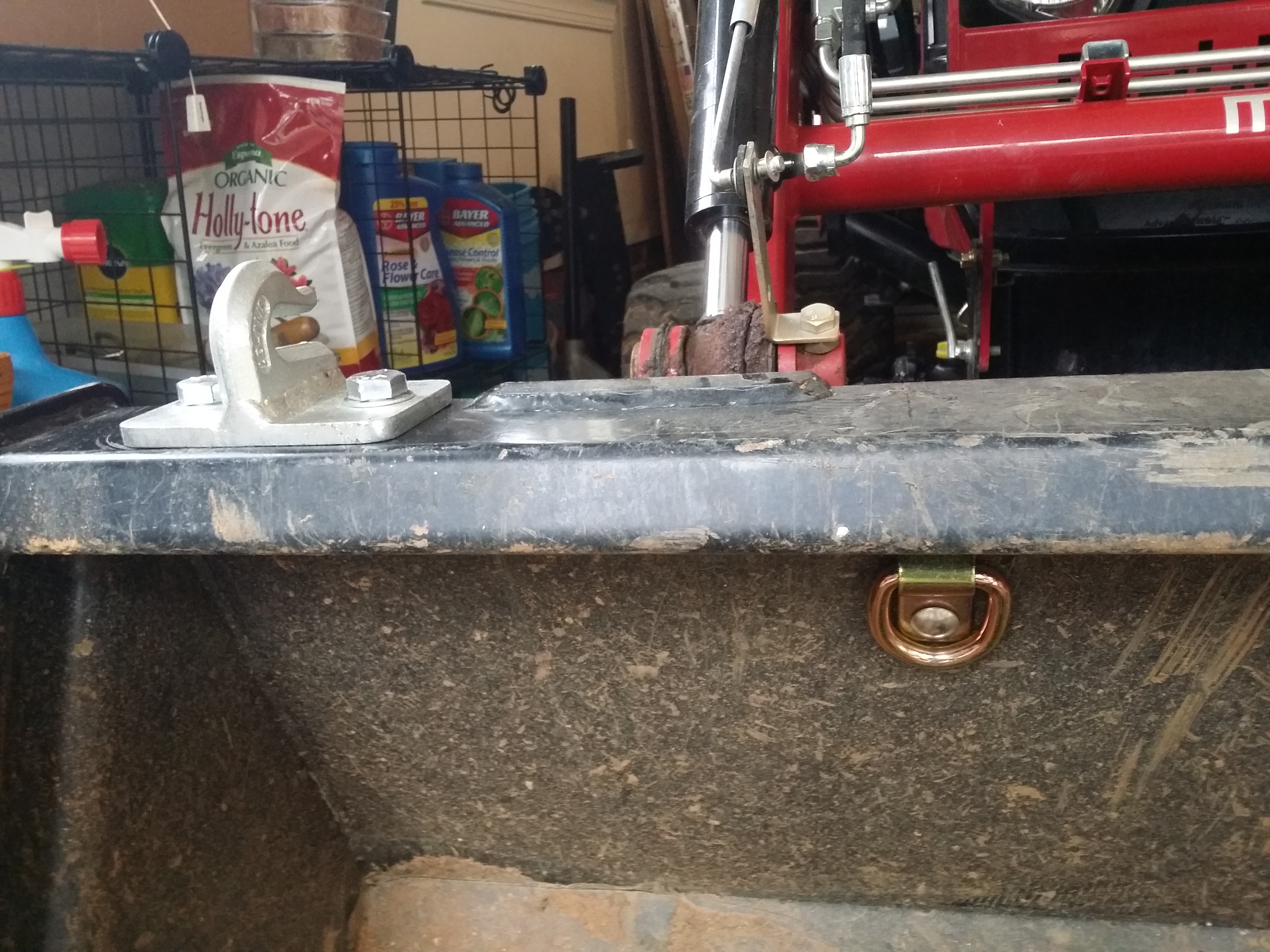

Completed the FEL accessories: Hooks and D-rings
The 3/8" hooks I bought earlier this year, the rings just last week. For the hooks I used 1/2" bolts and backing plates. The rating is way above the loader capabilities.
The D-rings are just to keep large items in place while in the bucket. They are light duty rated at 3k lbs but they'll only see about 500lbs. The pic is just of one side...
