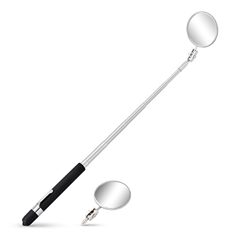

Noticed another fuel leak though. Not sure where this one is, somewhere above the fuel pump on the left side. Bugger to see with the fender on and that's a bugger to take off. Might be the banjo fitting on what appears to be the fuel rail Might try to tighten that up a bit.
Have you seen the mechanics mirror with a short handle you can see behind things with a flash light very handy to have
willy
   / What did you do on or to your LS Tractor today? #1,783
willy
I just put my old cell phone with long pliers under or behind things with video camera going then just watch it! Really works good when by yourself and need to move something to see what is happening!

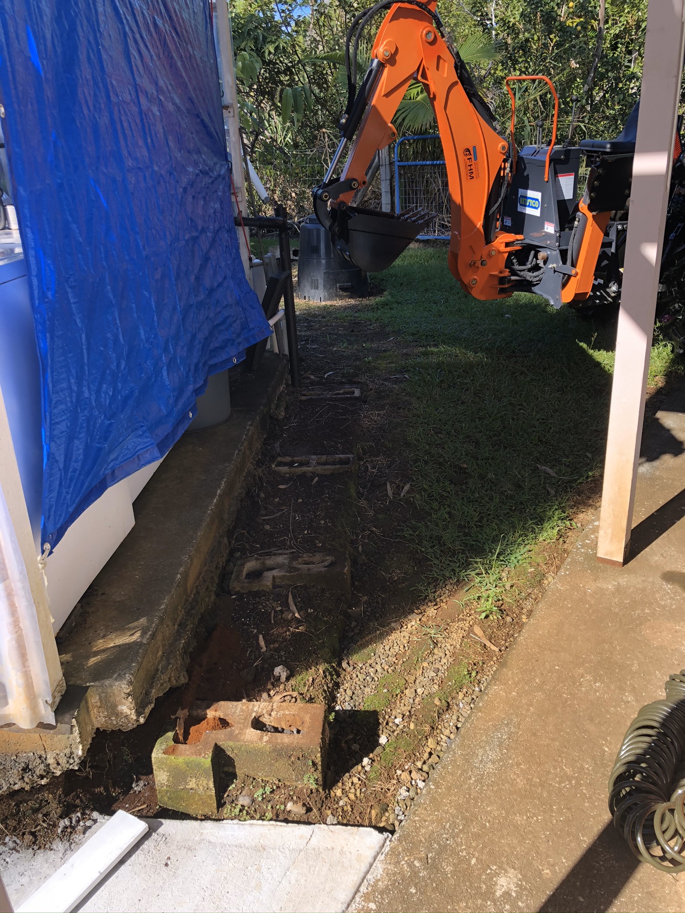

Broke ground on the new shop today. (i know it's not an LS but my MT125 would have taken a month to get this done....)

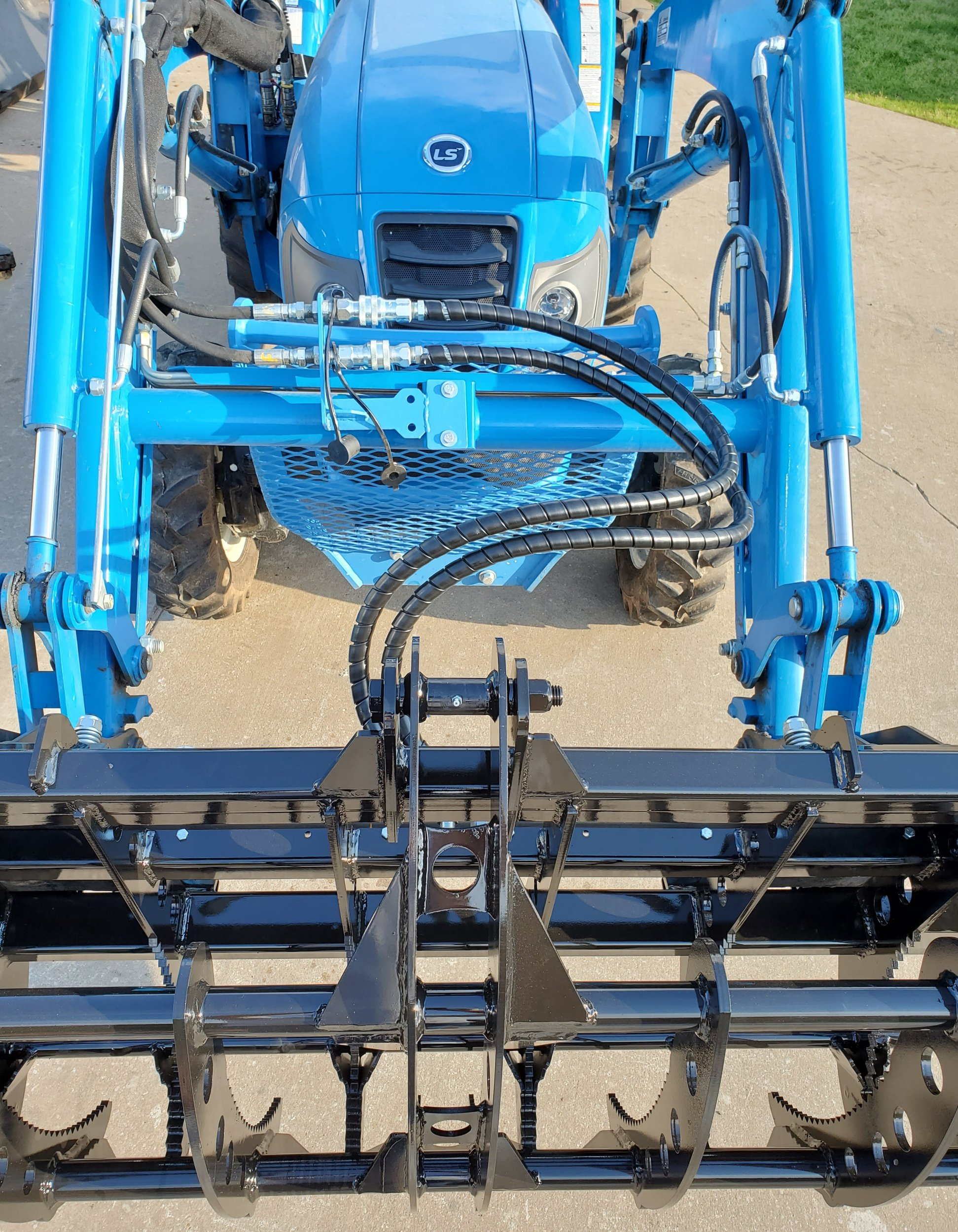

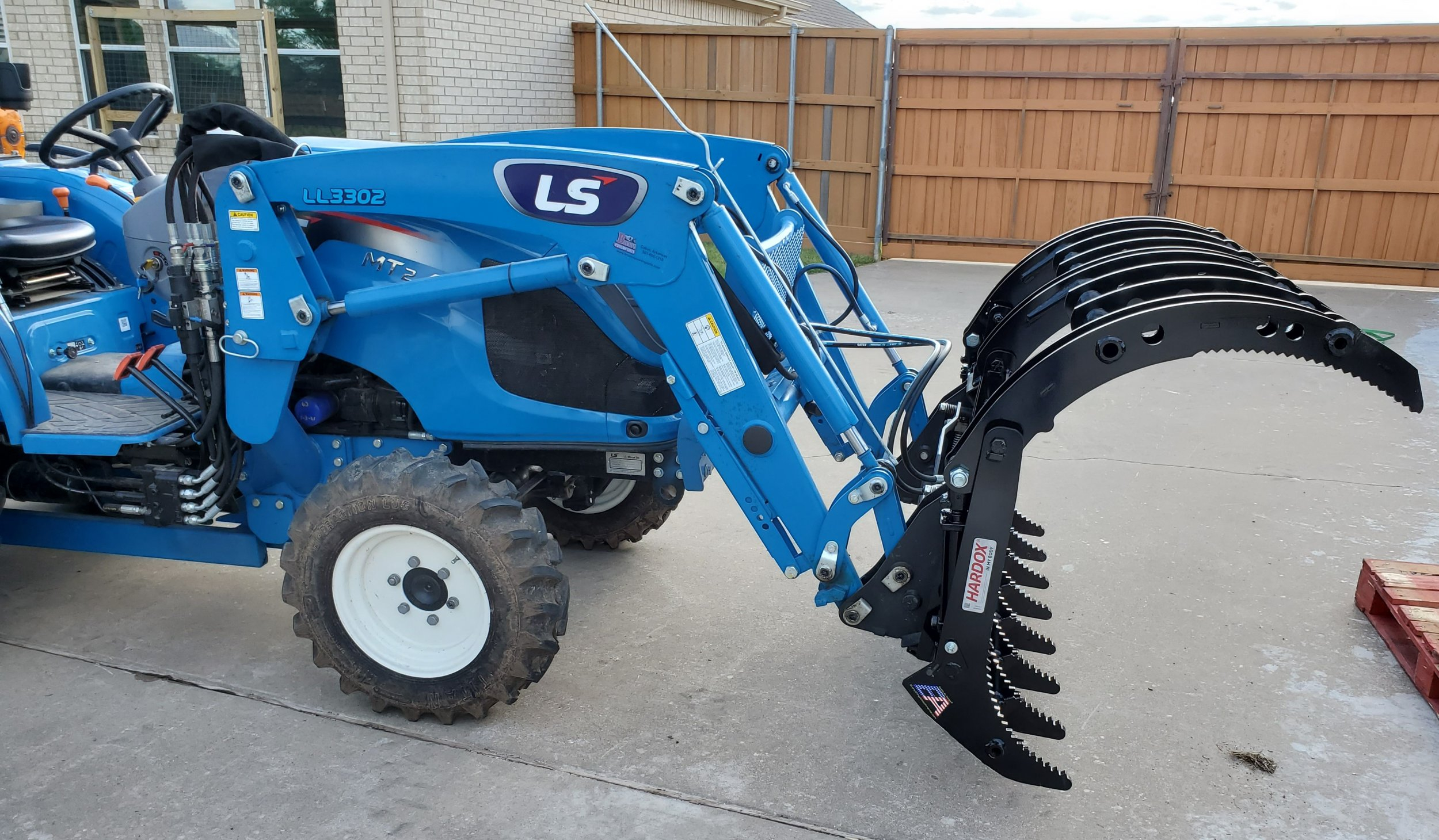

This finally arrived so I could pick it up.
Added some spiral wrap to the hoses.
