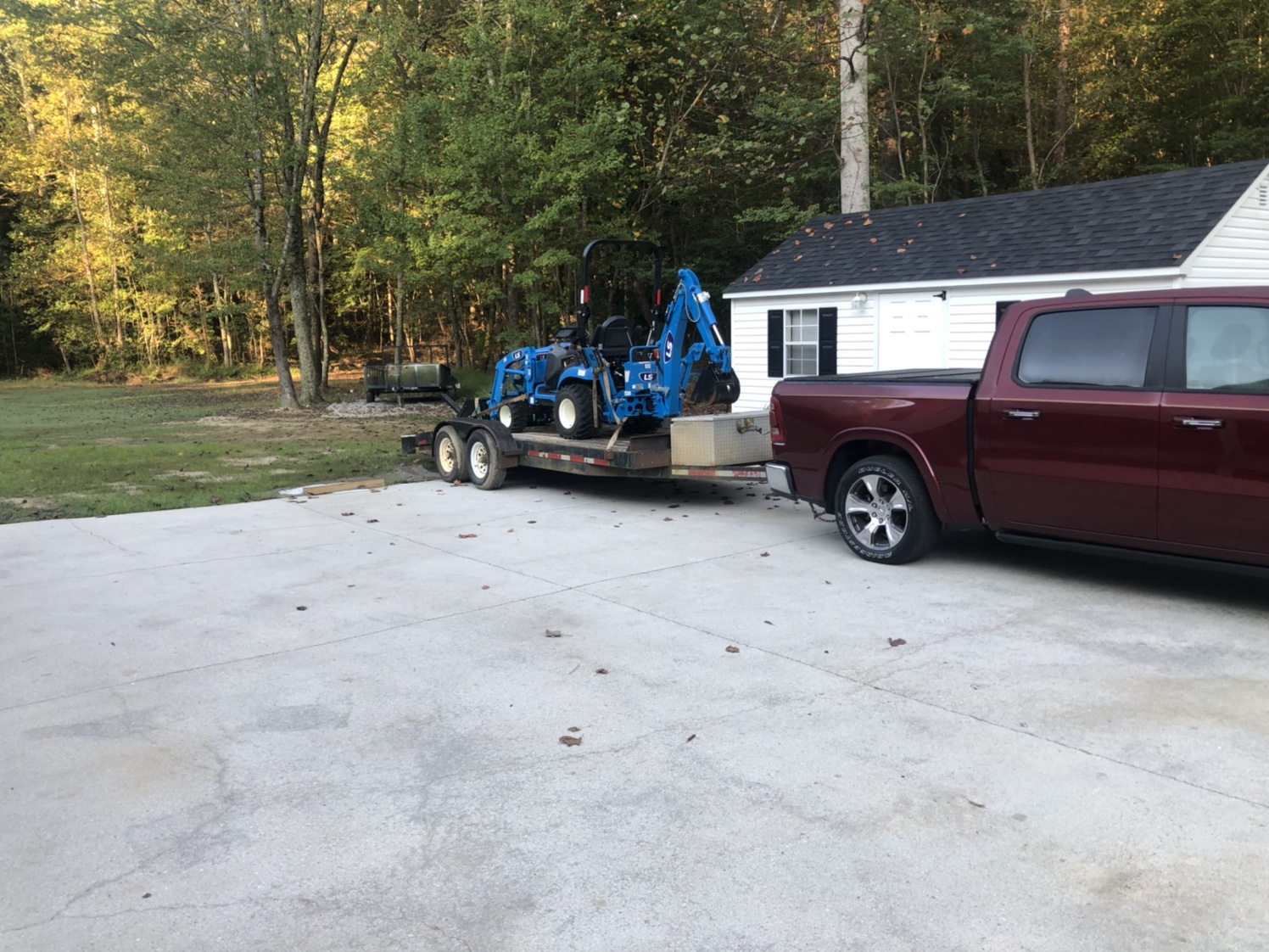

Loaded my MT 125 on a trailer and headed out to my son’s house. I removed two stumps, moved a railroad tie, dug a hole and buried a cement block, moved dirt and filled in some holes, dug up and moved some brush and small trees, and leveled an area for a shed. I didn’t even use a quarter tank of fuel. The borrowed trailer was a little over kill for the size of my tractor, but my Ram 1500 handled it well..

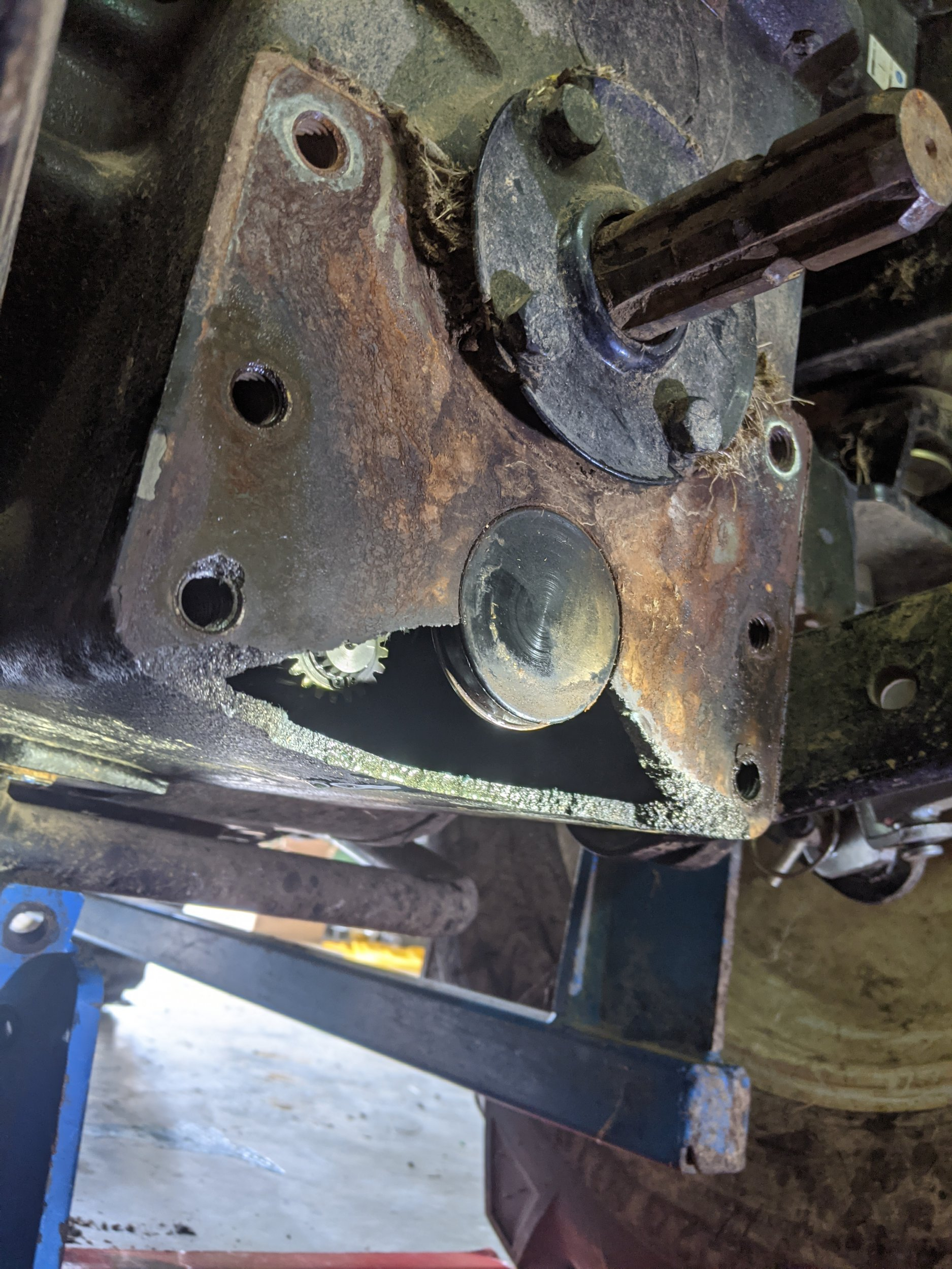

Tried to move a rock that was stronger than the 3037 with the backhoe.....

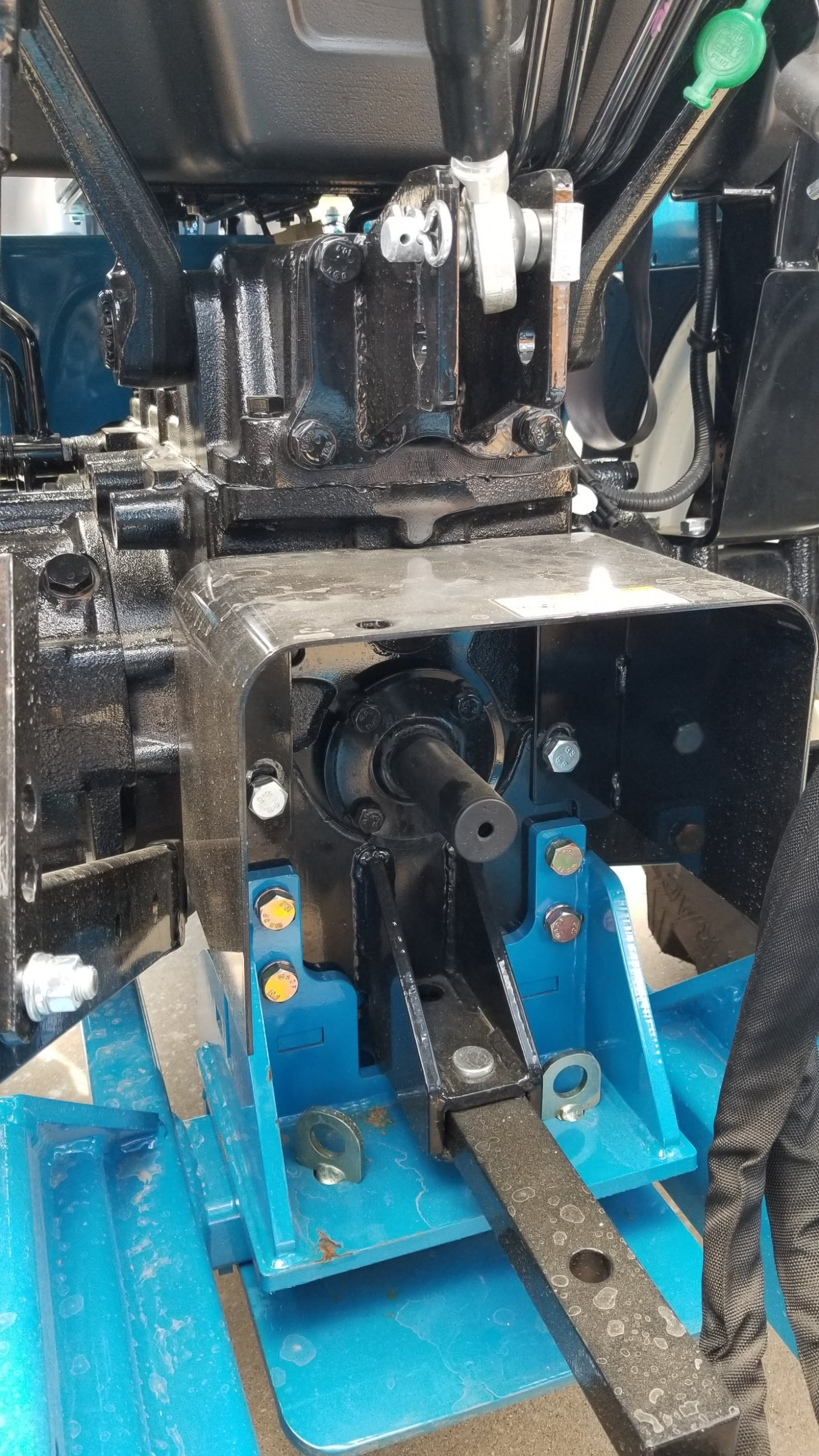

What are we looking at here? At first I thought that was the top of the 3 point hitch with the picture posted upside down but upon further looking apparently not.
   / What did you do on or to your LS Tractor today? #2,067
Wow! That is where the subframe bracket attaches? Strange that it would break off that part of the case.
   / What did you do on or to your LS Tractor today? #2,068
I believe this area, this is on my MT240HE
   / What did you do on or to your LS Tractor today? #2,069
That is exactly where it broke. Cleaned everything up with some gasoline dried it all out, little grinding, about 8 Muggy Weld rods, some 3/16 plate to reinforce everything, back in service and finish the hole in less than 24 hours.
   / What did you do on or to your LS Tractor today? #2,070
Expensive mistake !
Not really, I repaired it myself, about $60 worth of specialty rods. If you look really closely you can see where some of the casting is pretty darn thin. But then that's why this tractor is $10,000 less than a comparably equipped green or orange tractor.
