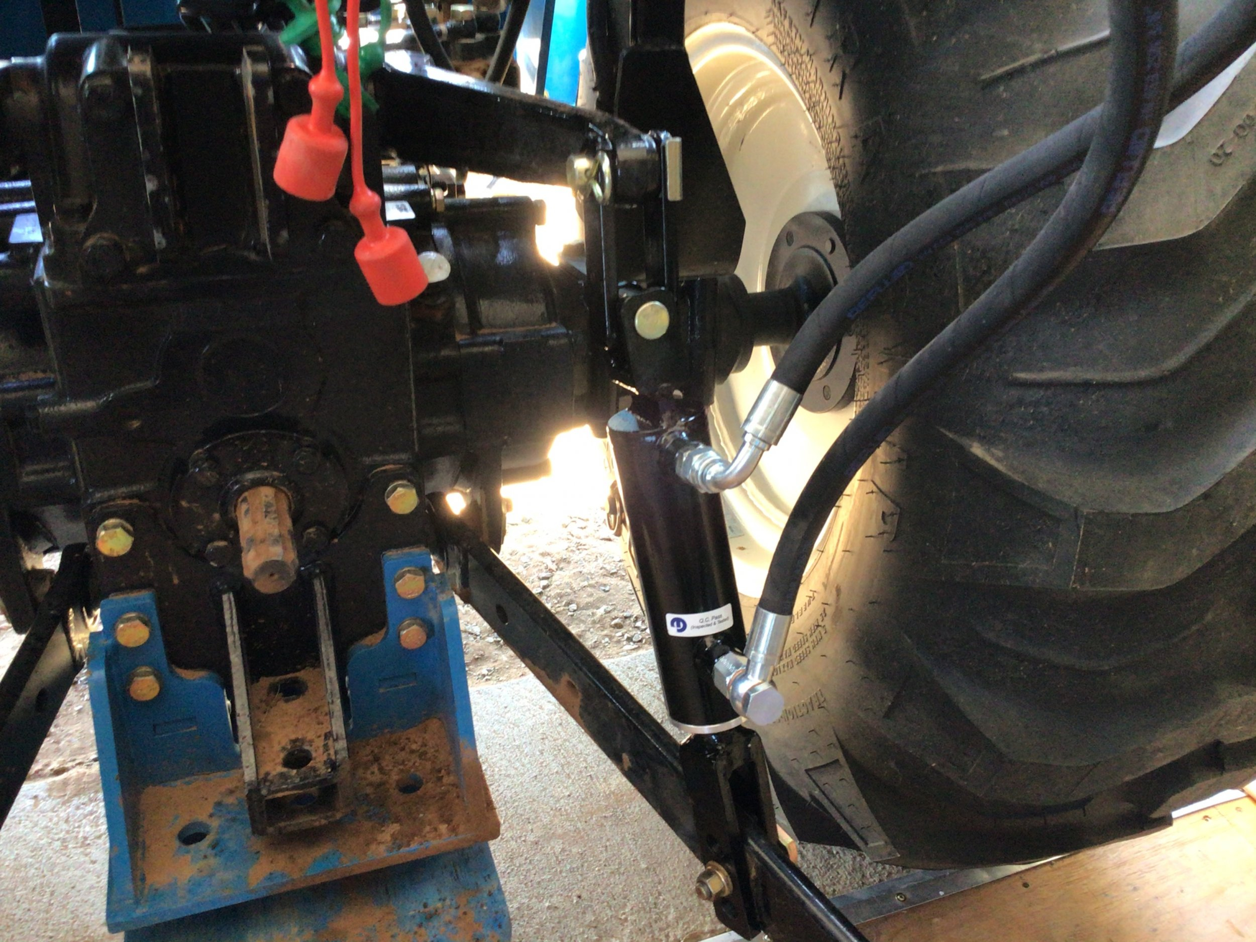

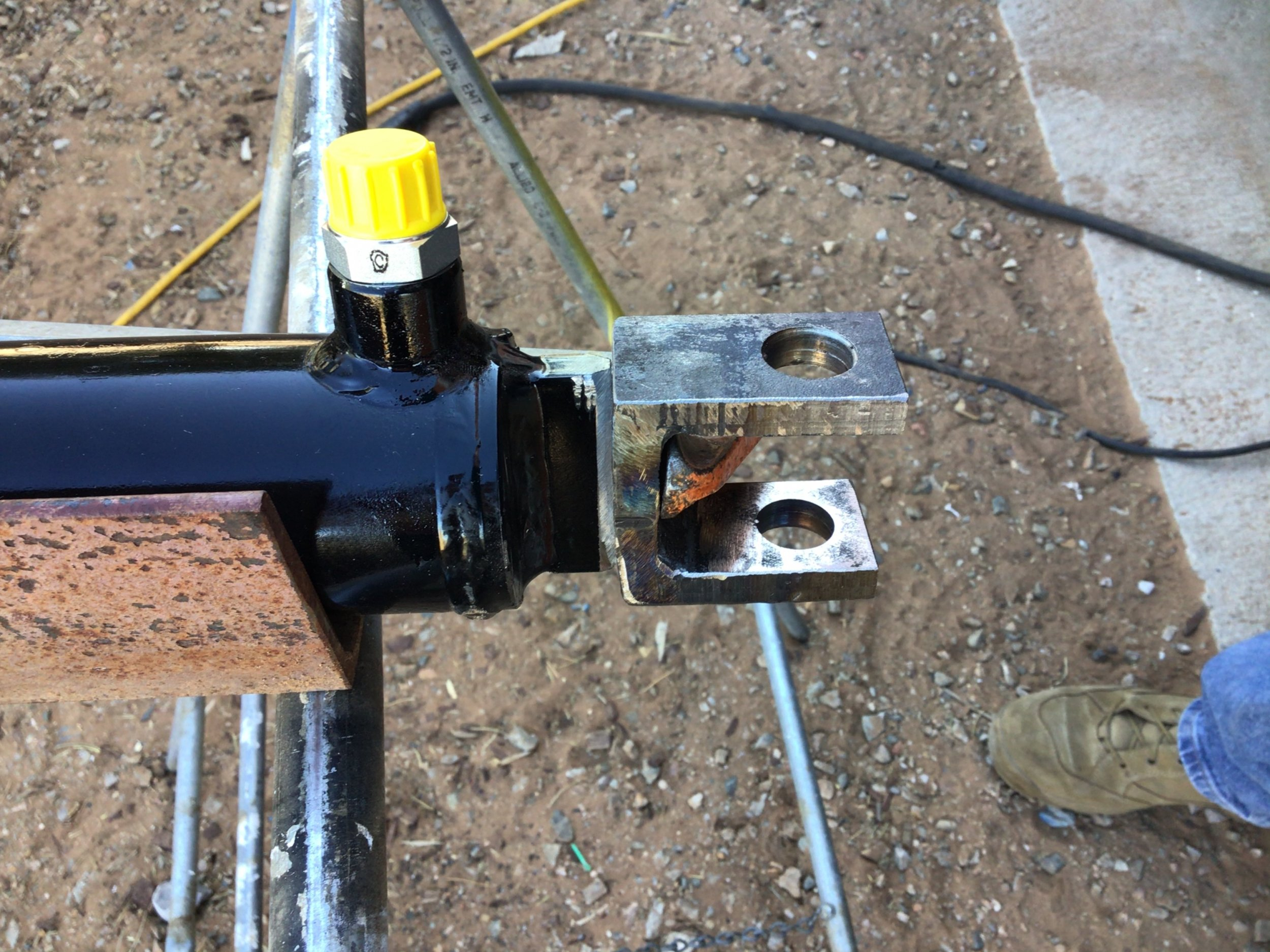

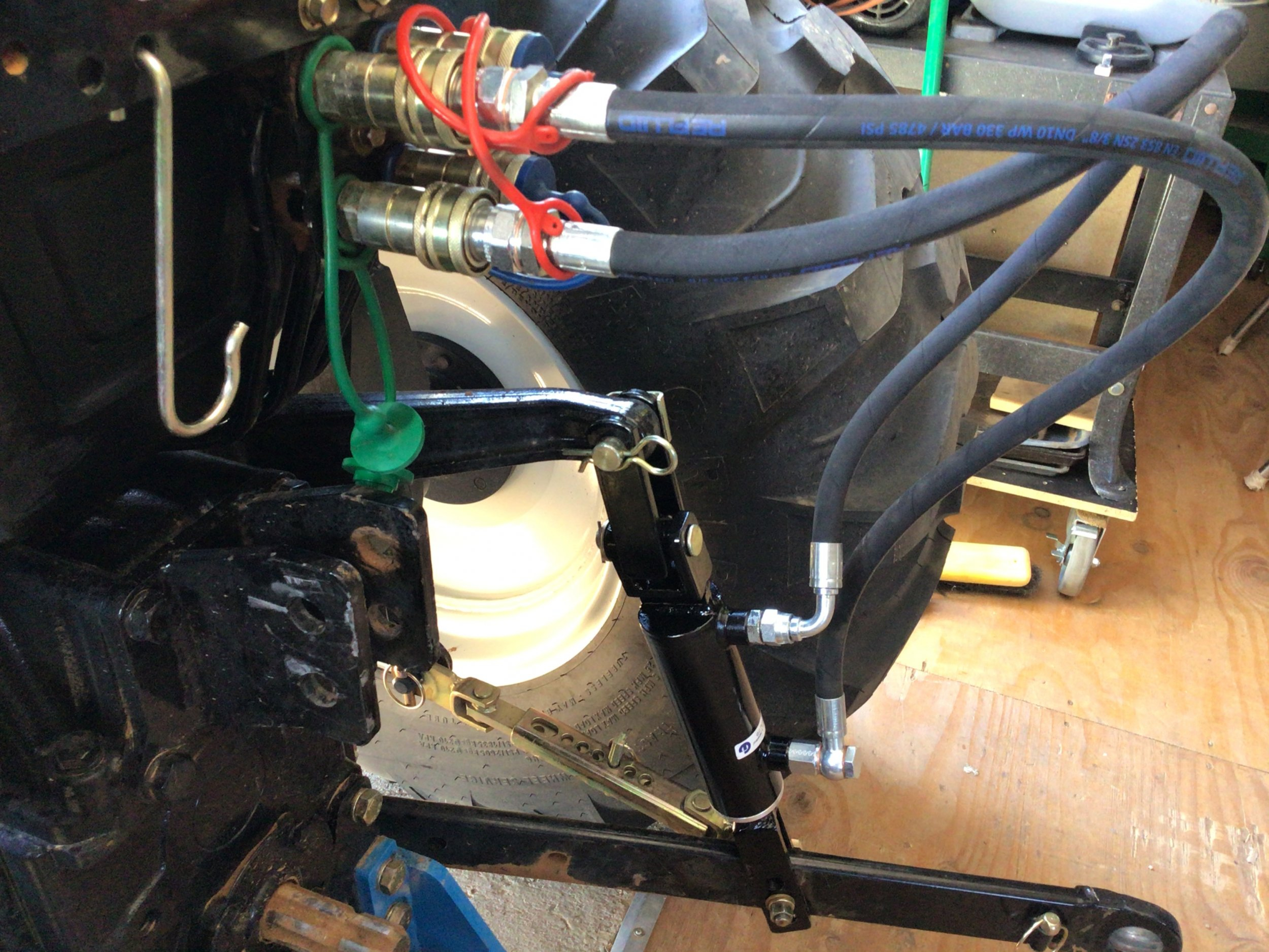

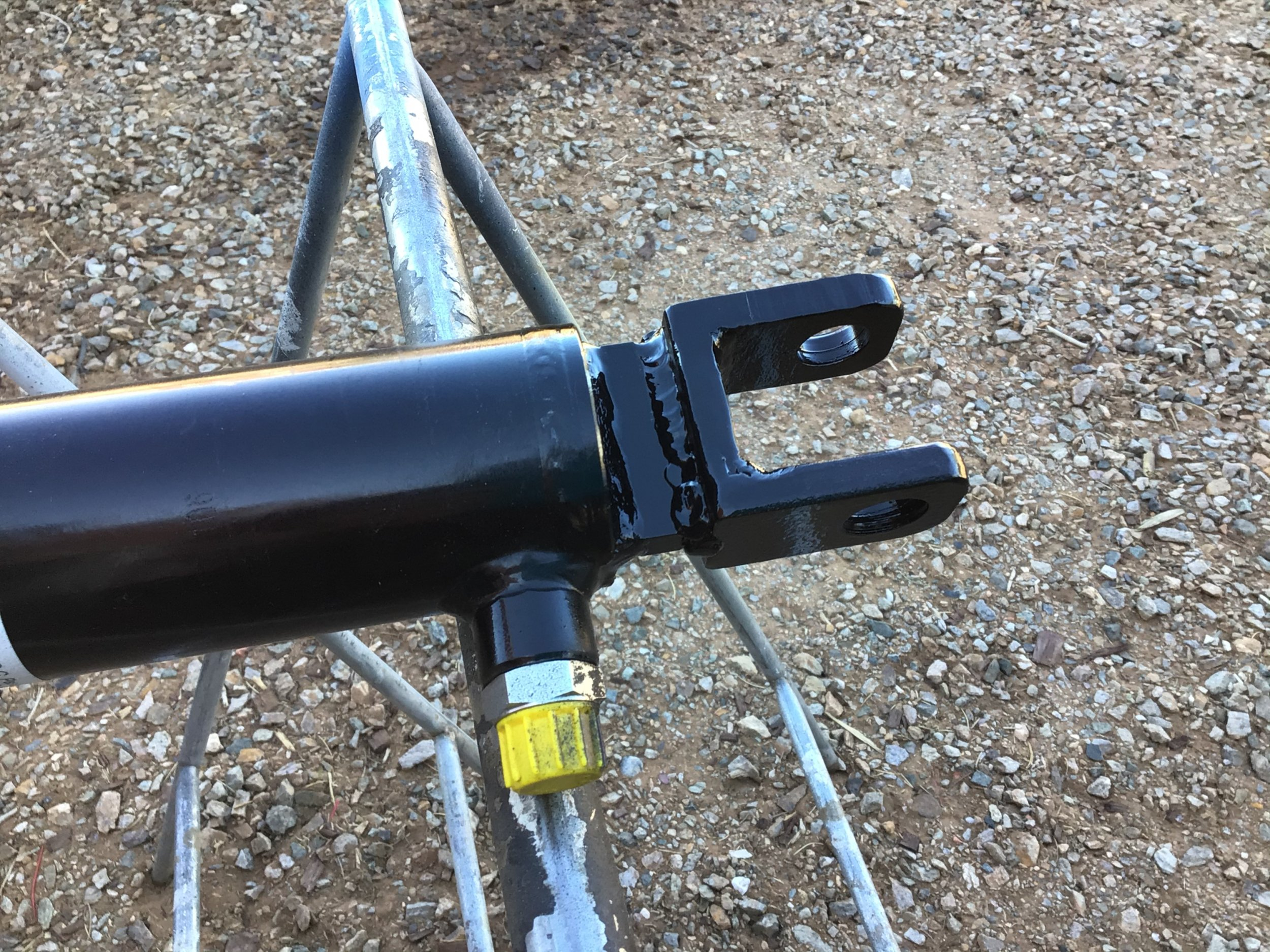

Finally got the hydraulic side link installed! I had to modify the top cylinder mount from a ball swivel to a clevis. Cut and welded the clevis to fit the factory swivel, then welded it onto the cylinder. Perfect fit! All-in, cost $250 with the hoses.
Here is welding the clevis onto the cylinder:
88048494-EA58-4660-8326-3CA59544D3D0.jpegB68C1308-3DCF-4CC5-88E3-8D29E8F1C991.jpegAC1BF552-DA4C-43F4-BFEF-6E16BBDC57C9.jpeg
And installed on the tractor:
I hope it works as well as the hydraulic top link!

Looks great! Where did you get the cylinder and how long of a stroke is it?
Sorry it took so long to reply.... it is an SLH01 cylinder, 4" stroke. Here is where I got it from: A&I Products Link A-SLH01
There are other places too, here is one that lists the specs:SLH01 - Hydraulic Side Link Cylinder, Cat 0 Base End w/ Clevis Rod End (2" Bore) | Up to 60% off Dealer Prices | TractorJoe.com
hope it helps. This is a short link, but is the same one that my dealer was quoting.... plus another $175 to modify it.

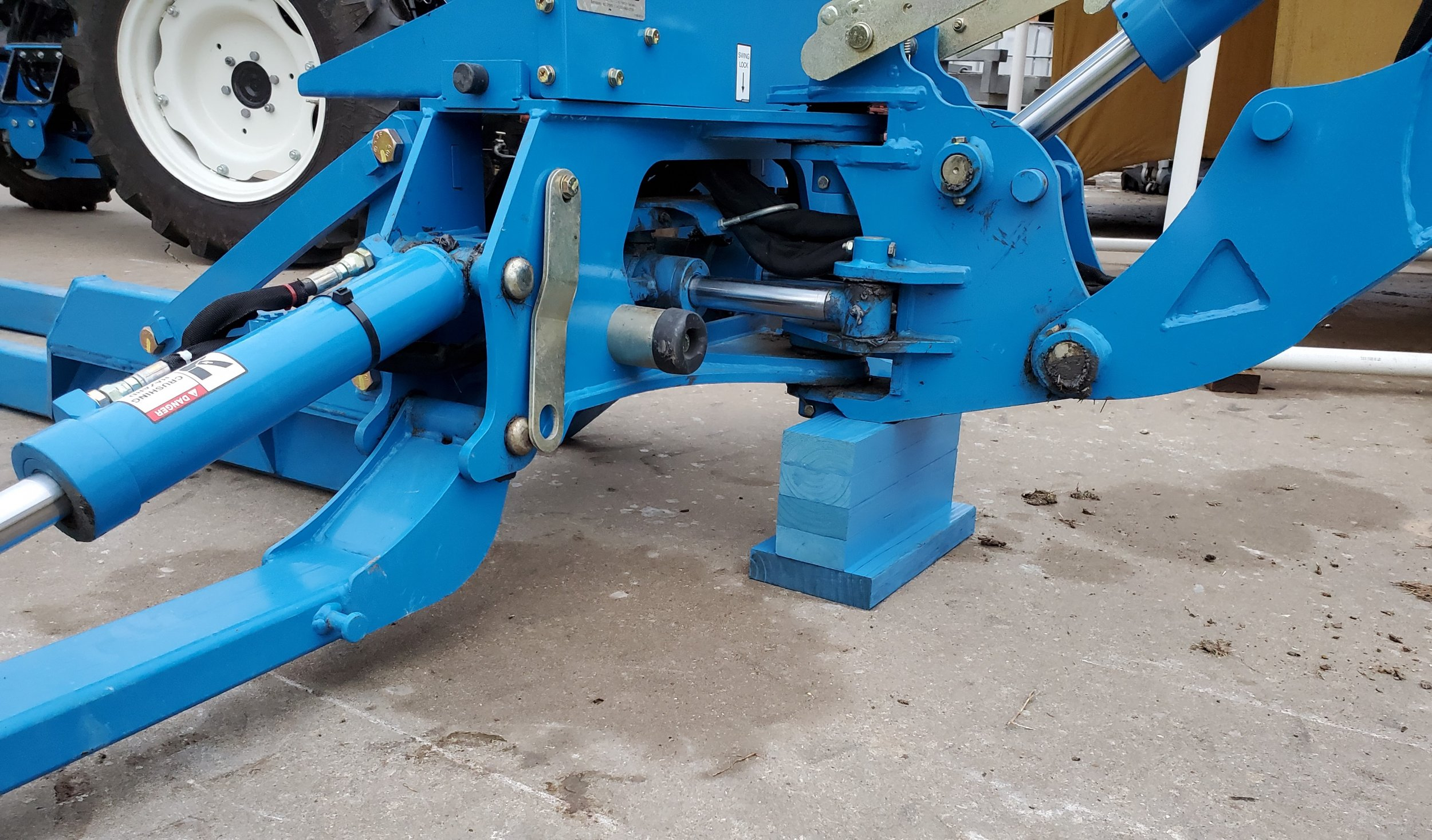

Perfected my Backhoe support block for when I remove it. Even color coded it so I (and hopefully others) will know what it's for when it's just laying in the shop. :)
May have to put an LS sticker on it.

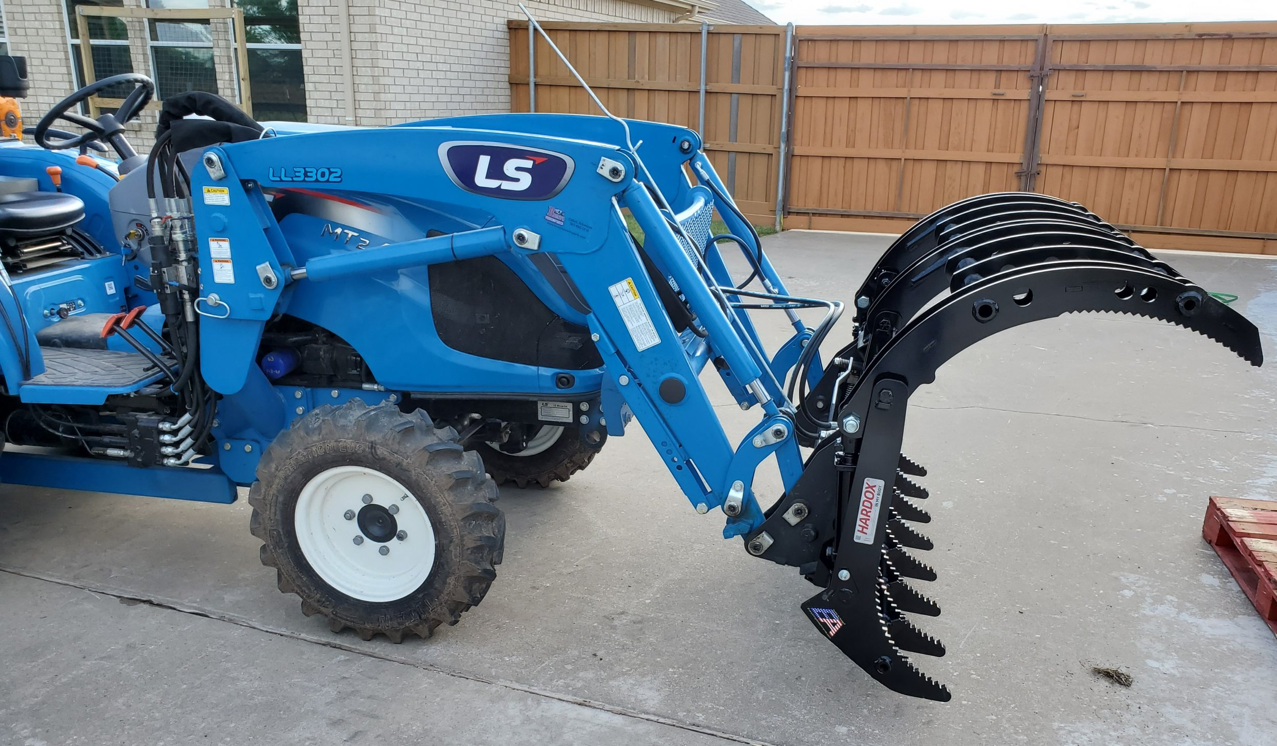

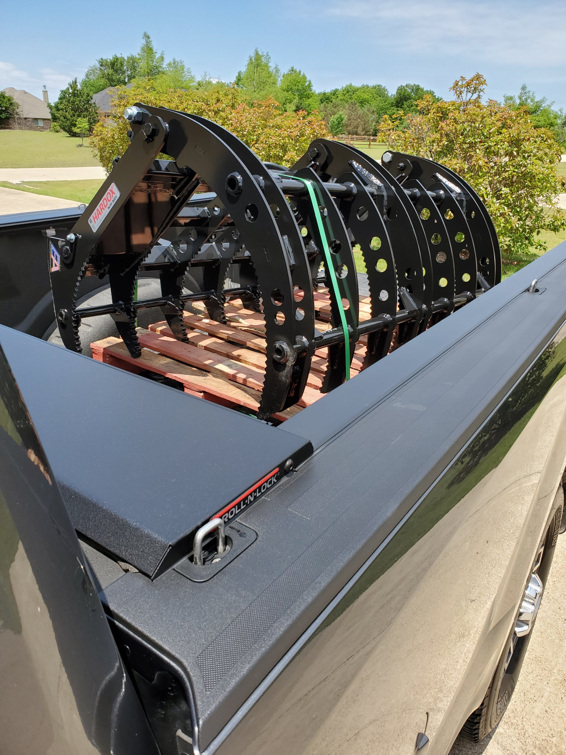

This finally arrived so I could pick it up.

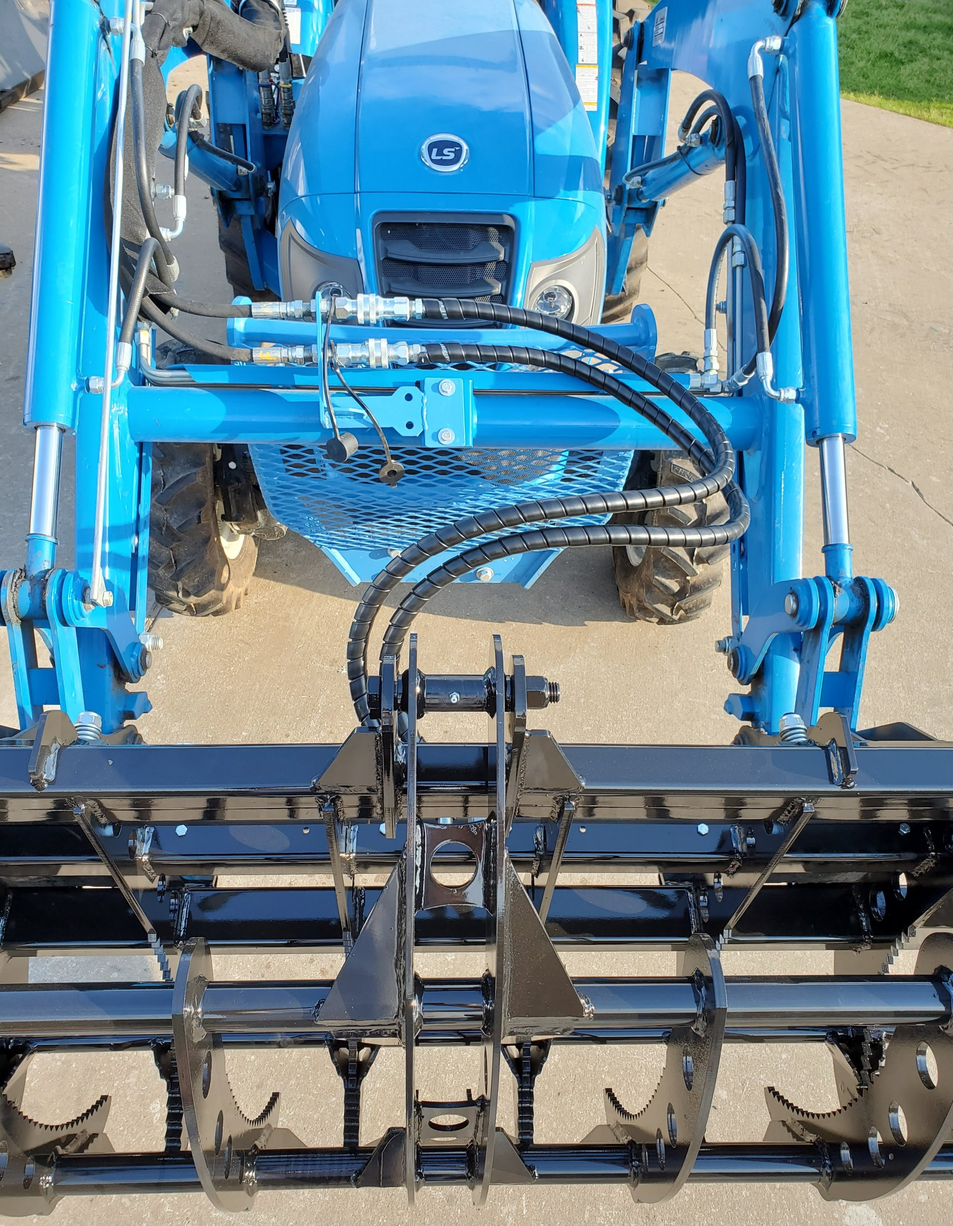

Added some spiral wrap to the hoses.
