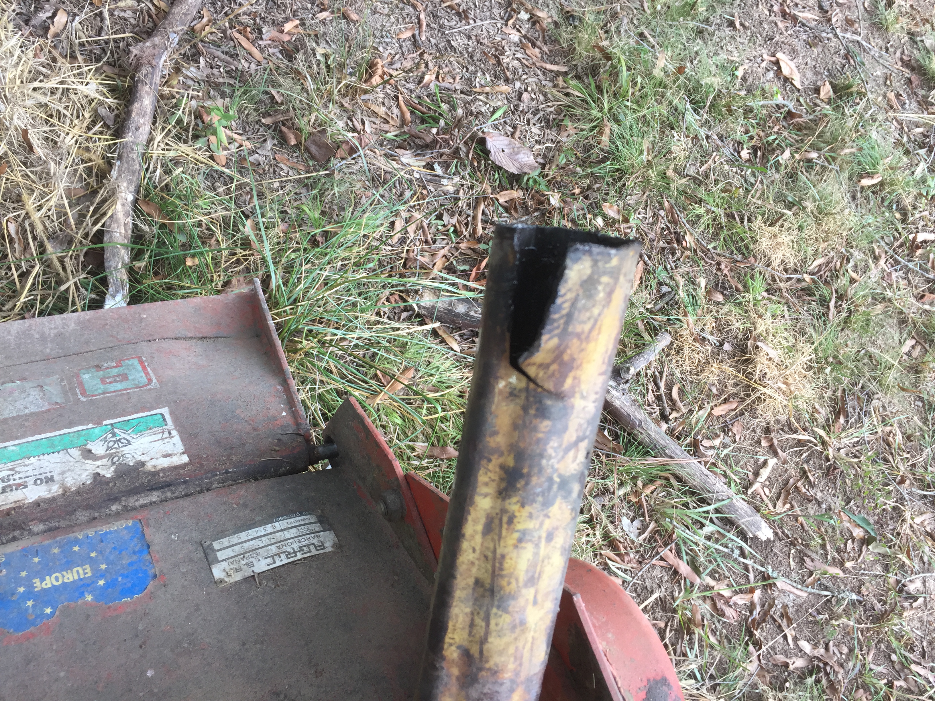

If you do get a QH, keep in mind your tiller driveshaft may to short now..
you and I have had this discussion ;)
but for his benefit, here's what happens to a too short PTO shaft. If it's too short, they can be sleeved and lengthened, just check it BEFORE you do what I did

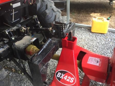

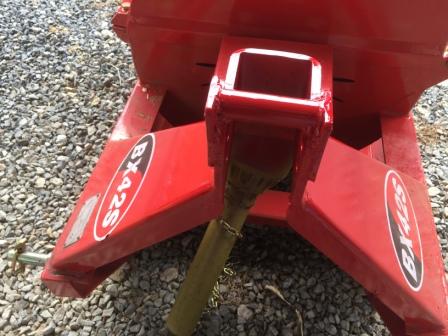

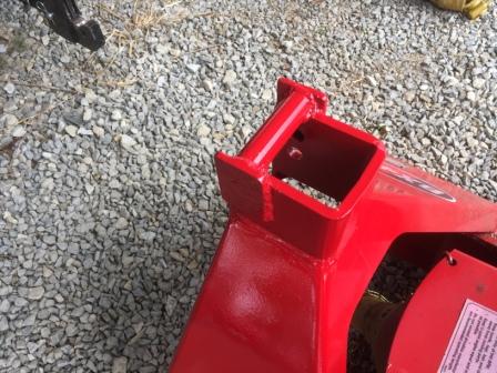

ok speaking of quick hitches, and modifying things to work with them. Today, I got out and did mod my limb chipper so that the quick hitch would fit it. since I was making it fit the way I want, I made it fit the same setup as my tiller, bush hog, landscape rake and box blade. BUT, just in case I have to move the top hook, I did away with the bolts, bent a piece of rod to make a u shaped pin, drilled a hole for a pin to go in it, no more fighting the thing to adjust it now!
the chipper:

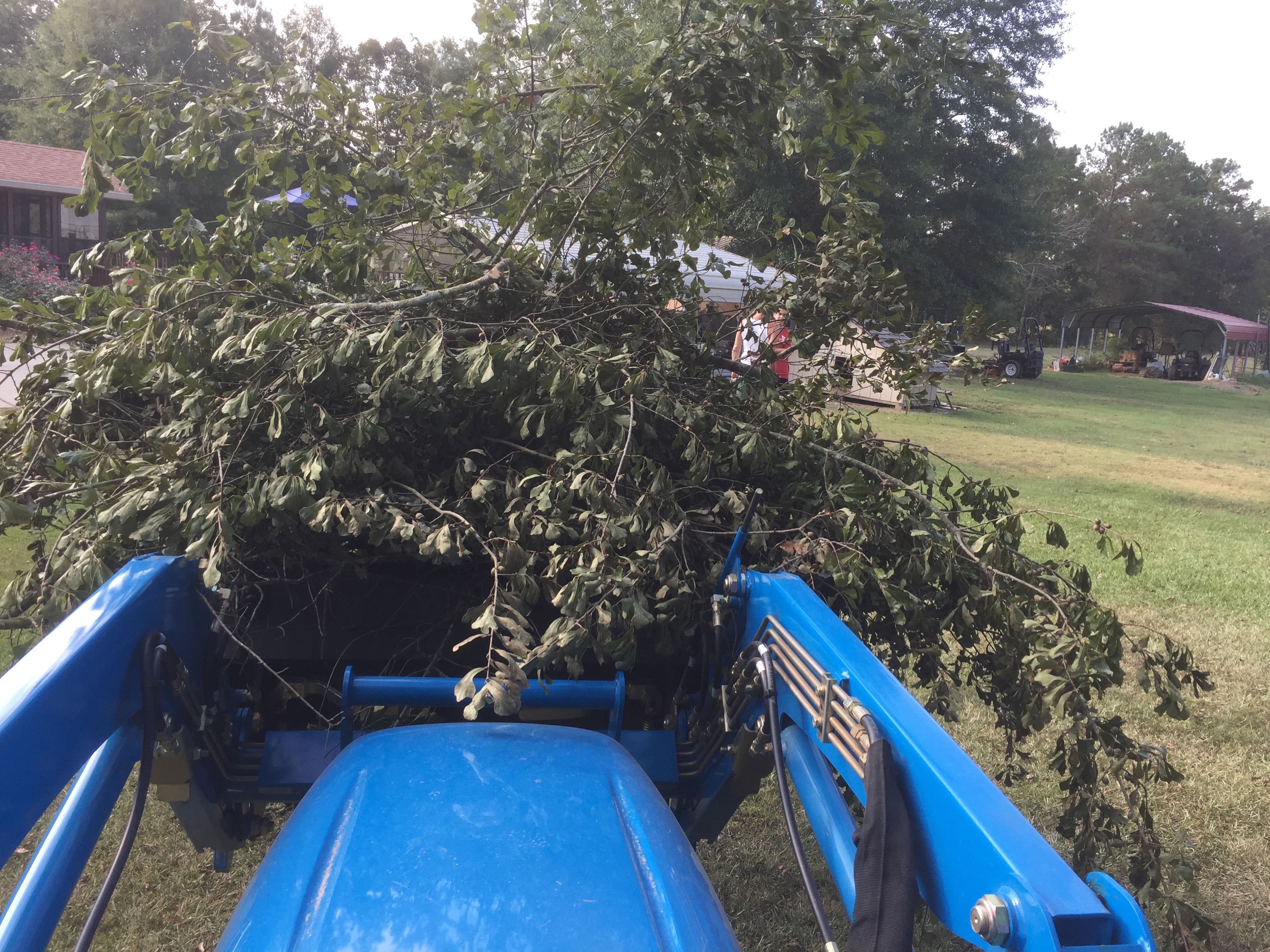

something else I did on mine today. That neighbor across the road from me had his nephew come and trim a bunch of low hanging water oak limbs. The ones that'll take your hat off while you're cutting grass....thinking he wasn't home, I went over and loaded up the limbs to bring back over and chip up since I had the chipper on the tractor. He surprised me when I looked up from tying them to the loader bucket. He just looked at me and grinned, and said "I bet I know who got those other limbs cleaned up now" ;)
I told him I wanted any limbs that come down, so I can add them to my mulch/compost pile ;)
