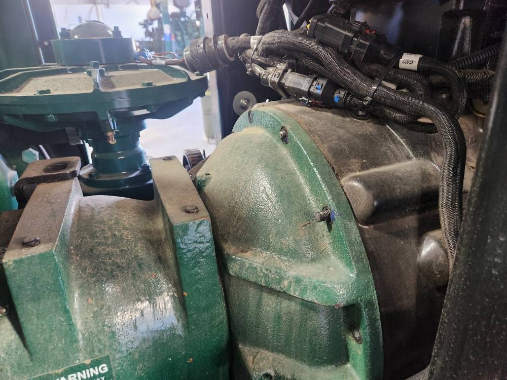

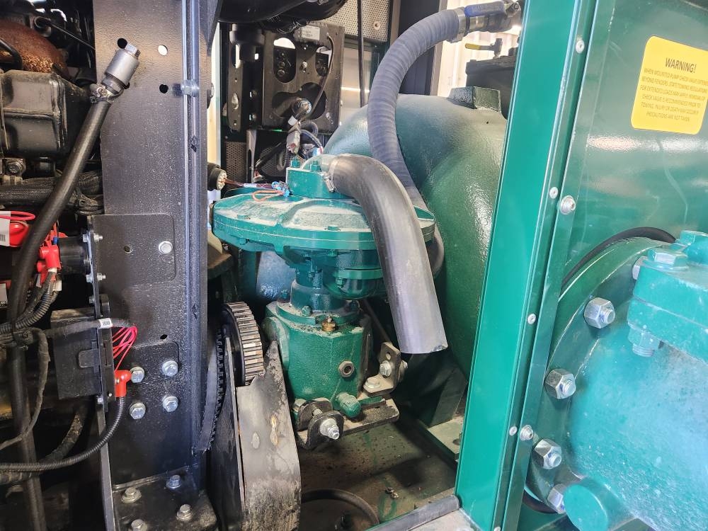

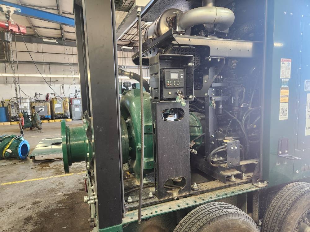

Snapped bell housing bolts on a 12" pump. Dropped the belt guard and wiped out a drive belt for the vacuum pump.
Gonna be a fun day

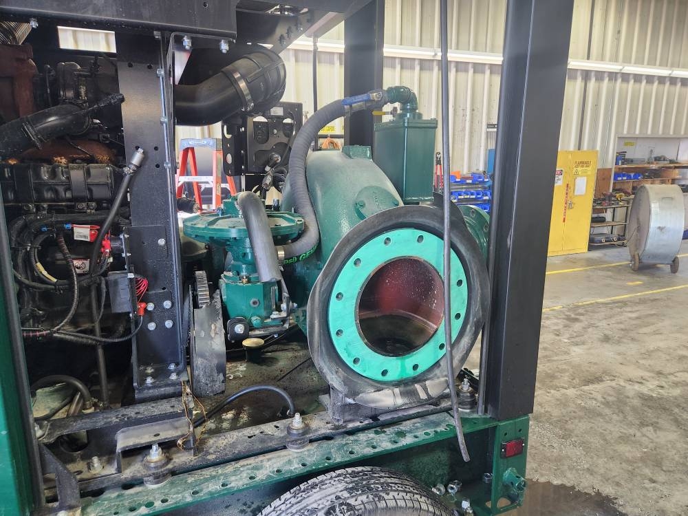

This one has been sitting for a few days. pulled it out of the jobsite Monday. But put off tearing into it until I ran out of other projects
Today I had to put my big boy britches on, suck it up and tear into.
I actually got the pump end removed. The bolts that snapped off flush extracted already. Fixing to get the vacuum pump belt replaced. Then after lunch, I'll run over to a bolt vendor, get some grade 8 or 10 bolts to replace all of them for the bell housing. Then I can put it back together.

Maybe tread lock blue which has always provided easy removal years later if you can't use antisieze?
