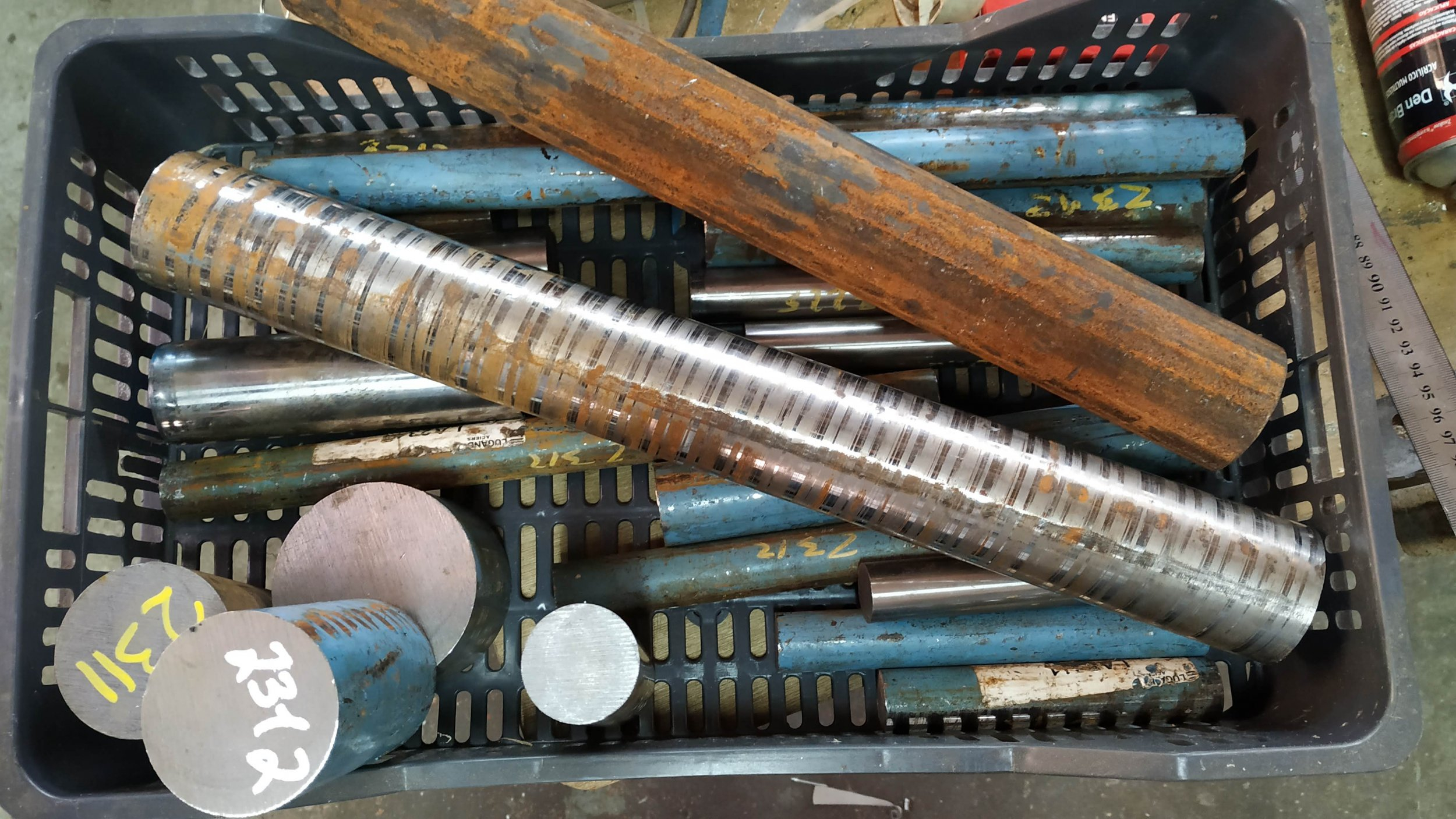

Drops are awesome and often can be found at a very good price.
I have a steel supplier close by that also sells drops from round stock, flat bar, etc from all types of grades of steel. Last time I went there for the loader project, I paid €50 and got a bunch of drops.
Here is a picture of what I got. From 100 mm in diameter, down to 20 mm. All kinds of grades, some pre hardened stuff as well.

You have a lathe if I remember. These cheap drops of different grade steel are invaluable for you.

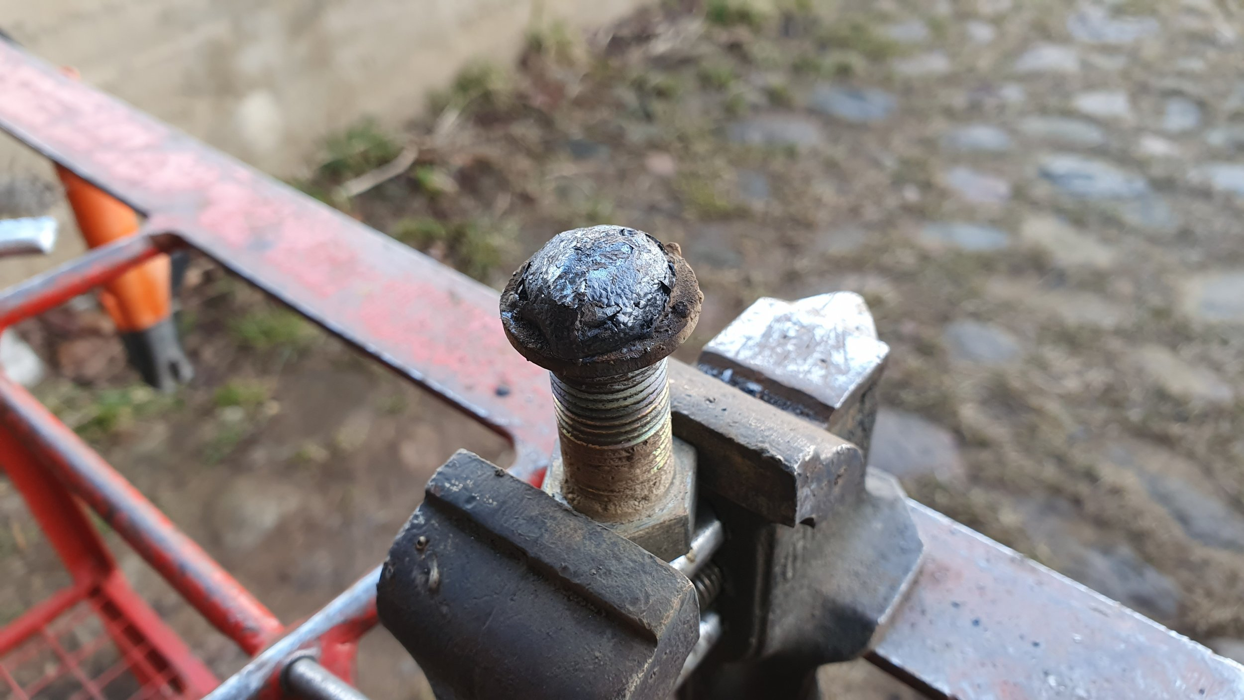

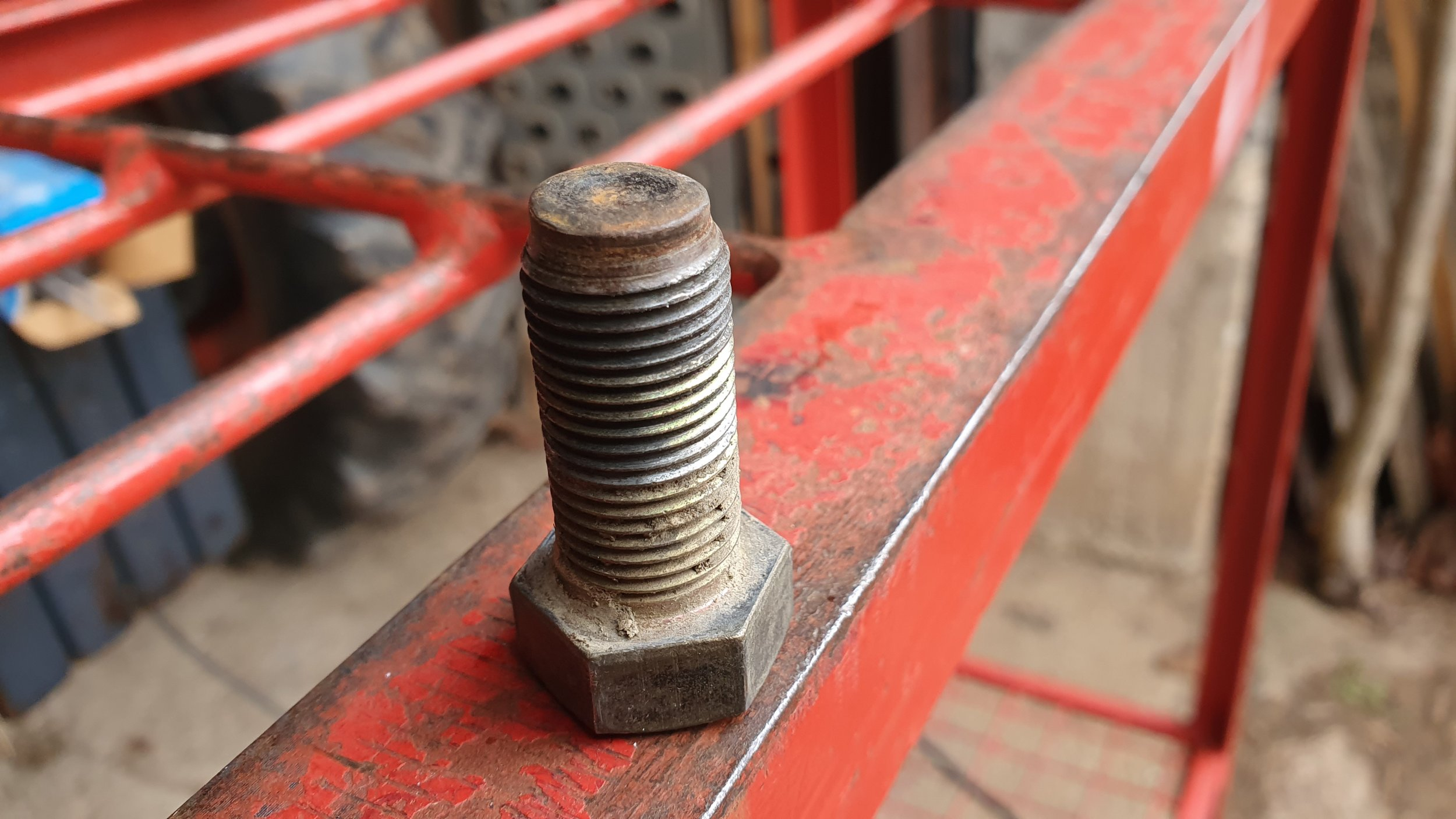

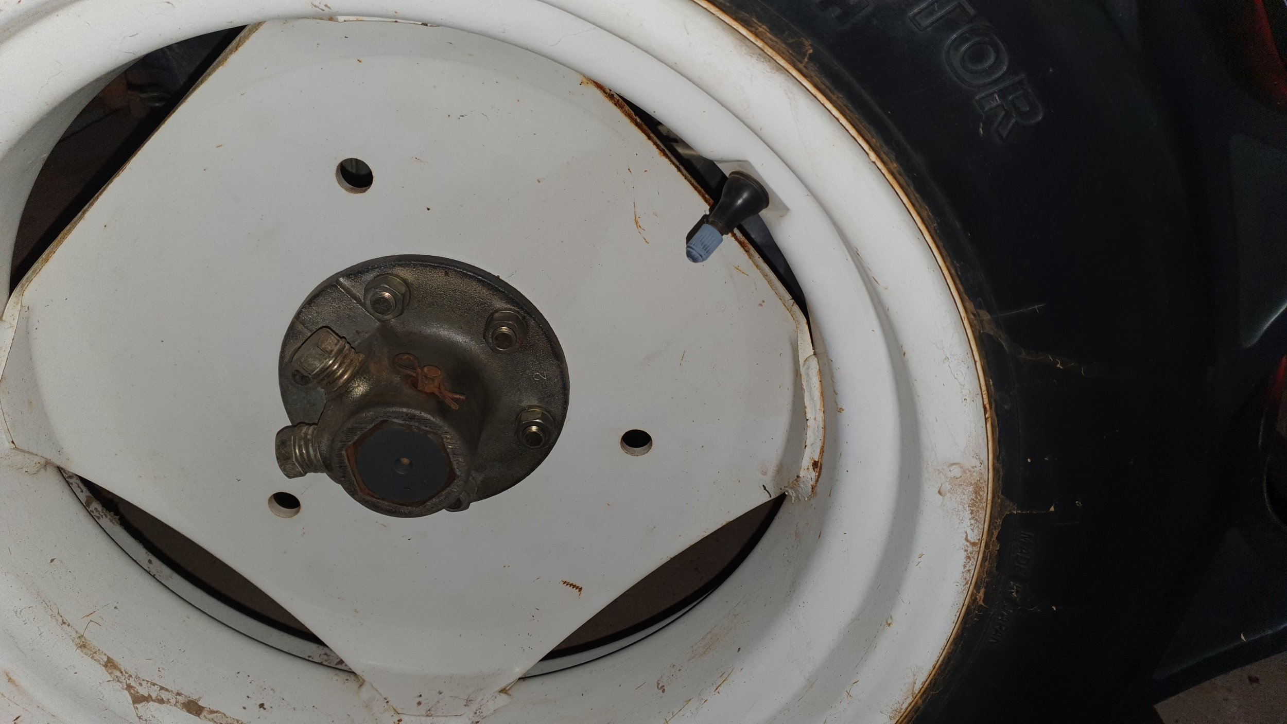

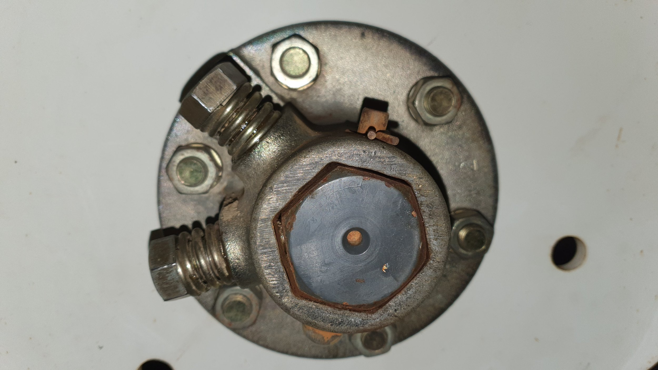

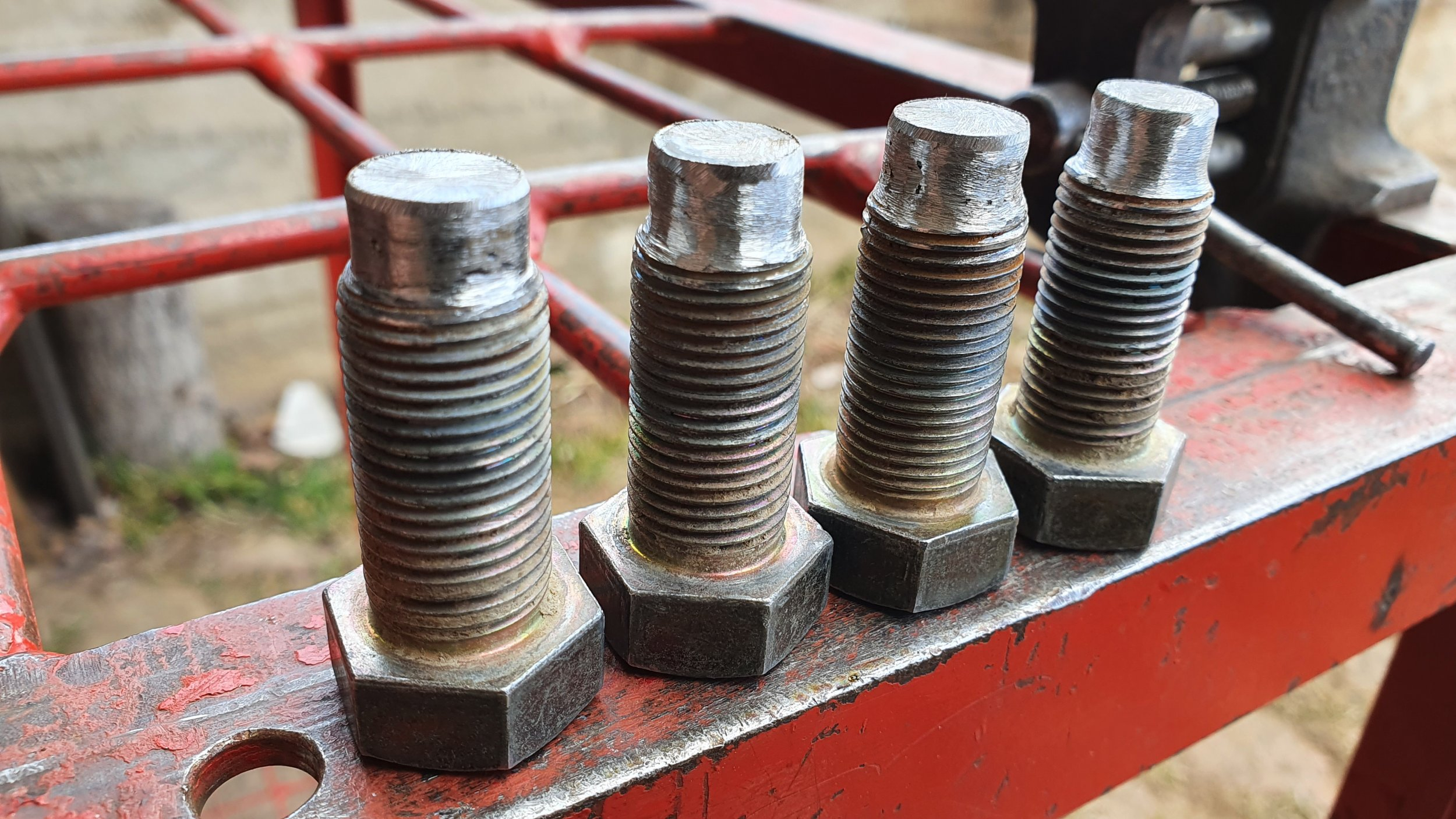

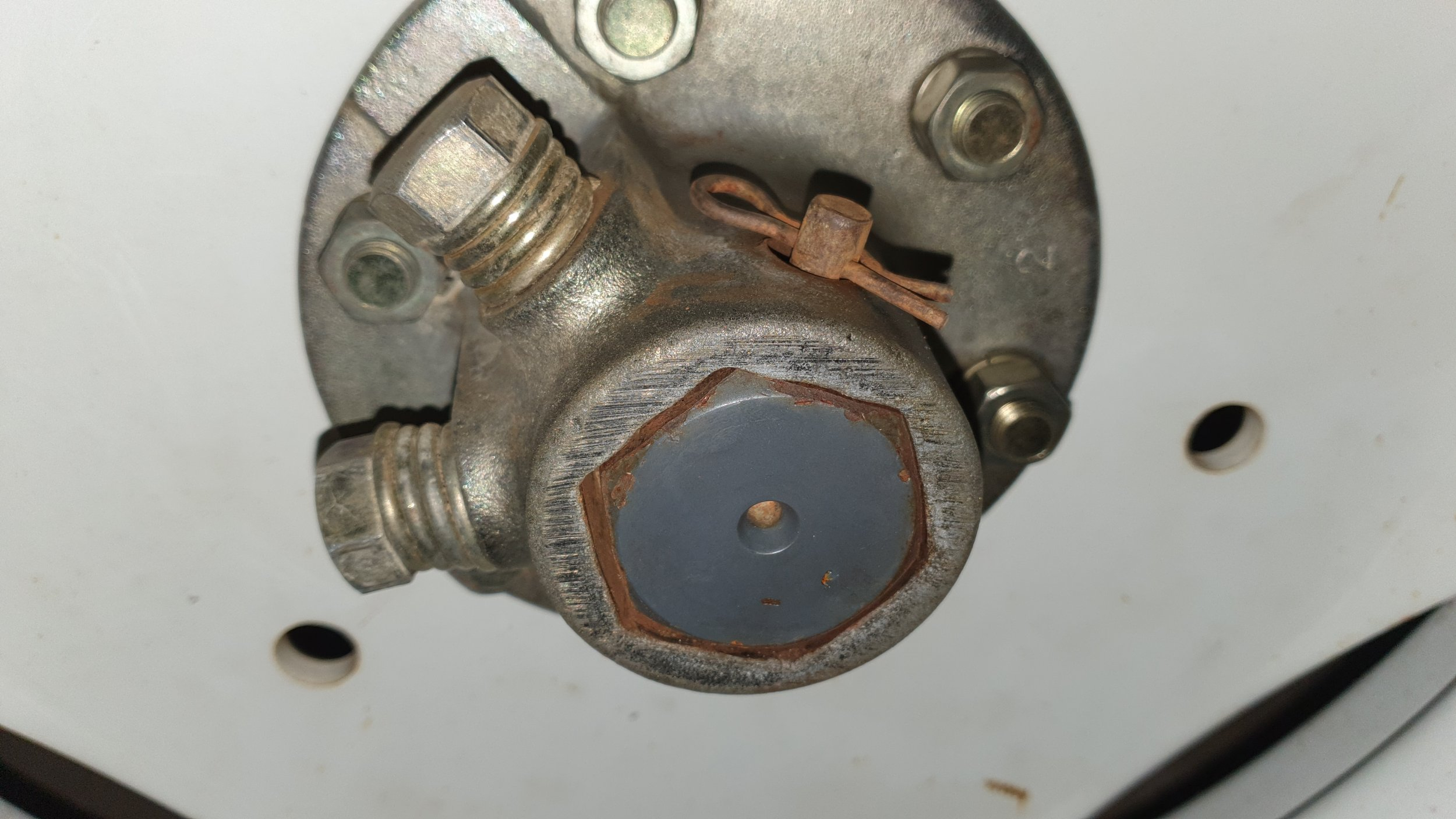

The '70s B7000 I had did too. However the set screws would come slightly use and the wheels would just wobble quite a bit. Mostly due to wear on the shaft and hub. Who knows hour many hours that thing had before I bought it 22 years ago.
I took into consideration your remark and did the job you were talking about. Yes, the springs were completely pressed down. All four bolts were sitting too deep in the hubs, so I decided to make them longer by welding up their tips.
Here's how I did it.
   / What Did I Purchase? #75
Great job! That definitely does the trick and should keep it tight for some time. The bolts do get loose over time, it's the nature of it. My tractor was like that too, probably with more wear since it was a much older tractor.
