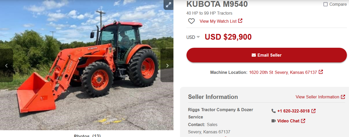

What state do you live in? It's counterintuitive, but sometimes bigger Utility Tractors are cheaper that a 60hp Compact Utility Tractor. A Kubota M9540 for example ...

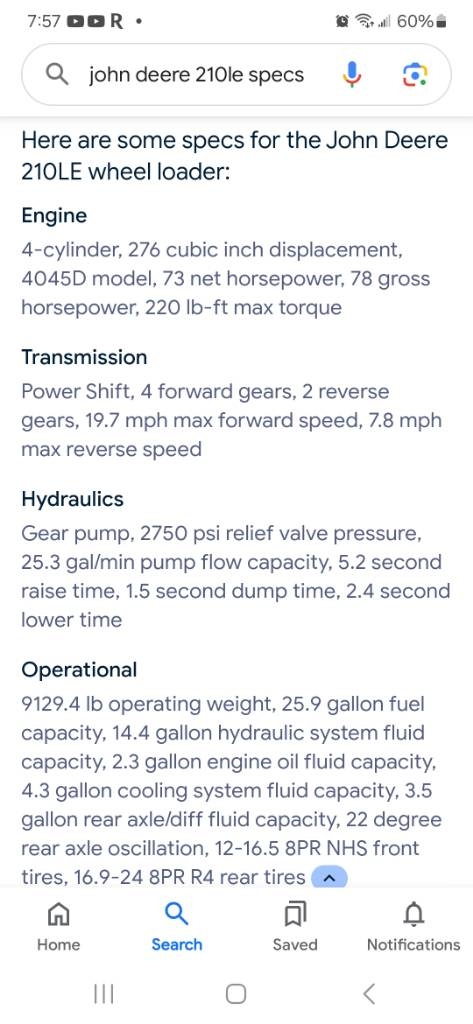

It's not often talked about, but the 210LE, atleast some came with a like 25 degree swivel on the seat to prevent "box blade neck" and had 3 point down pressure. I've seen them starting around $25k, for pretty high hour machines, but these are very easy to operate, and extremely heavy duty machines.

Wow, that John Deere 210le is a lot of tractor for the money $25k-$30k.
