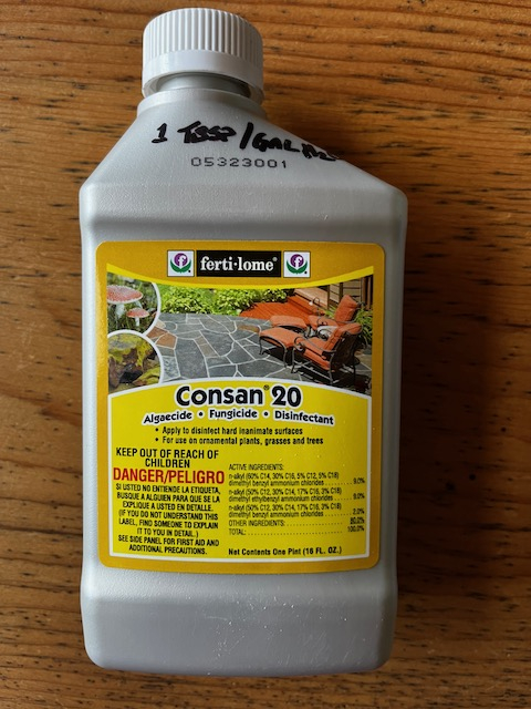

I have these on my place too. I usually get them under or next to my red oaks, but not always. This Consan 20 (see Pic) works for me. 1 TBSP per gallon. Don't get near a pond or other water ... It'll kill fish.

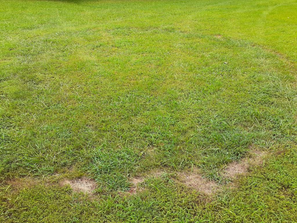

I our front yard is a 20 foot diameter circle of dead grass, about 6" across. It may be hard to see in picture but you clearly see in foreground dead lawn and it's really almost a perfect circle.
I've had my soil tested by agricultural laboratory and it came back excellent except a little high in nitrogen. Rest of lawn (over an acre) is fine. Septic lines and tank is way away in back yard. No underground wires, phone, AC, pipes, etc.
Over the years any bare spot I lightly raked, seeded, then thin layer of potting soil, straw on top & it does great.
I've seeded this, doesn't help. Any idea what causes this? It's weird. (Aliens? ).View attachment 758212

Suspect grubs might be doing that. Can you grab some of the dead grass and lift up a patch? If so, look to see if there are grubs eating the grass roots.
