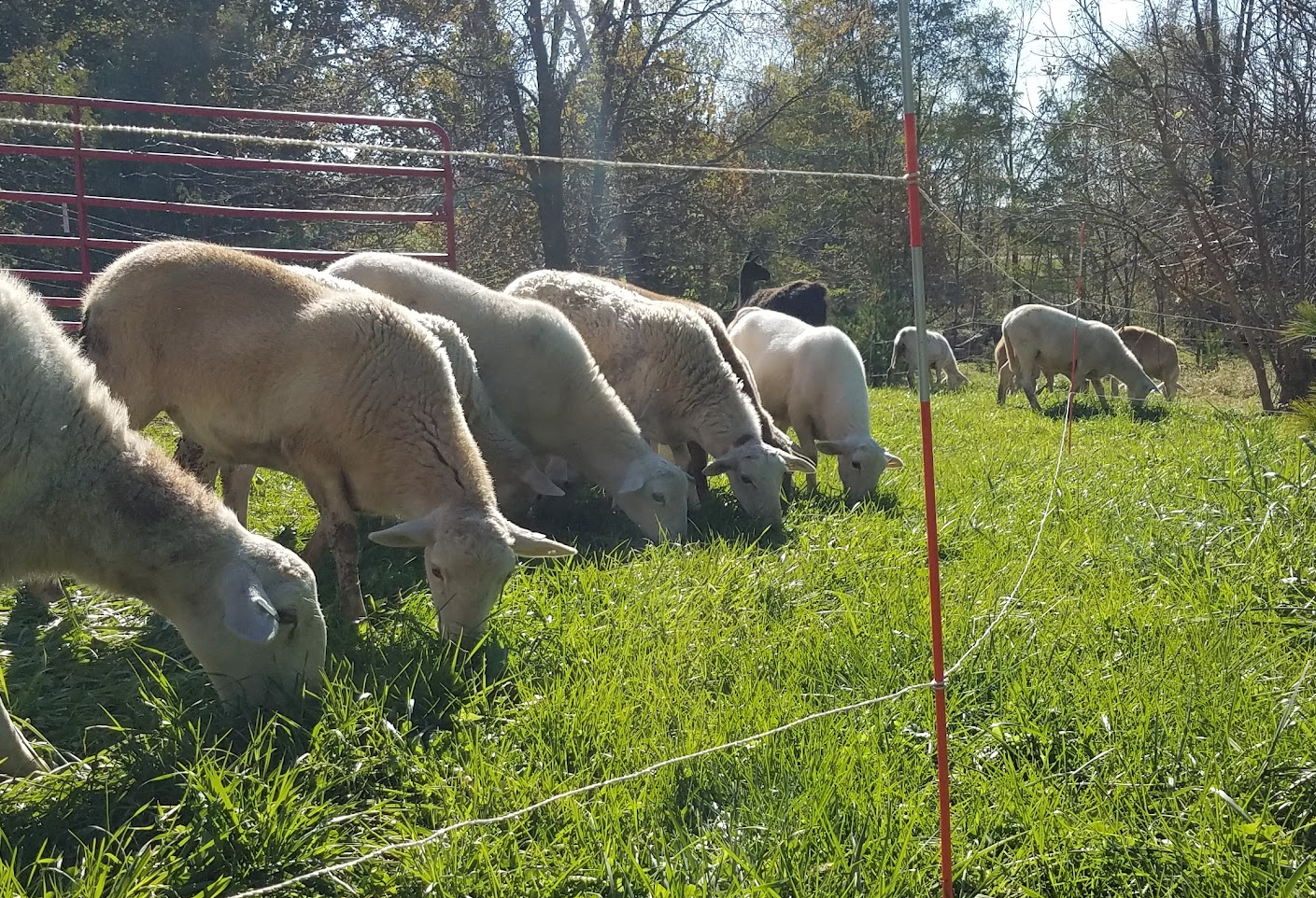

I had goats and Katahdin sheep. Now I only have the sheep. They are so much easier to manage than goats and eat about the same thing. They seek out poison ivy, multi-floral rose and mulberry on my property. I keep them in with two strands of electric fence. If they get out, I yell at them and they run back to where they feel safe (in the fence). The one goat that I kept will push over 10' mulberry trees and the sheep will run over to eat all of the leaves off. Once your woods is cleaned up, just take them to the sale barn and sell them for more than you bought them for (try to do that with a tractor!). I would start with about 4/acre and plan on moving them once a week. That means you need enough fence for 2 pens.
Even if you are using loppers and a saw, the sheep can clean up all of the little stuff and keep the trees from regrowing.
