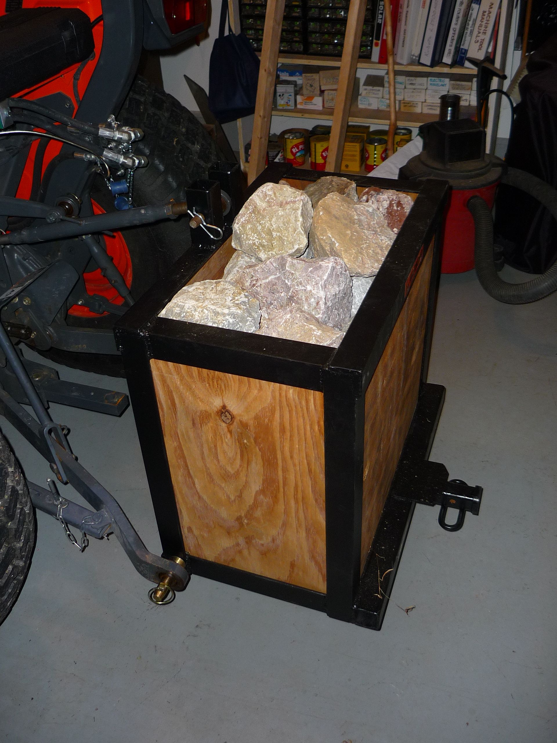

I sold a very clean Kubota L3130 HST earlier this year, with a quick attach 72" HD bucket, filler rear tires and NO issues at all. For $13,700. It would have been a great machine for your work. Not a lot of horse power, but plenty of weight and function. Add a toothbar to whatever you get for digging power. If you need rear weight, build a ballast box, or hang a HD rear blade of some sort. I welded up this ballast box from 2x2x1/4 angle, and filled with rocks, it's easily over 500 lbs. Cost was under $100, but I had the non-angle steel scraps around.
Nice ballast box. Simple, useful, and well made.
