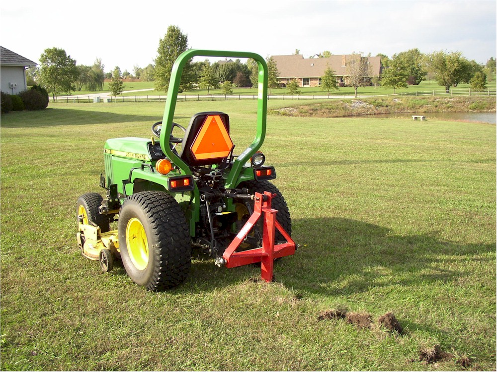

You should be able to do that. I have used mine to bury conduit, coax, and radial wires. Put on your loader for more weight on the front wheel drive if the soil is tough. While there are limitations with these smaller tractors, I have been surprised many times with what they will do. The subsoiler in the video of course is for a larger tractor. I bought mine at Tractor Supply many years ago and it has been more than adequate for my applications.
One operational tip. Keep one hand on the three point hitch control. If you begin sensing the tractor lugging, just a very slight lift of the subsoiler for only a moment will keep you going.

Well I bought a Countyline subsoiler at TSC. It's a full size Cat 1 model, I think. I have the high lift 3PH so it lifts it plenty high. Anyway, I am very satisfied with how the 755 did with it. It didn't go down all the way to the cross bar, but it went down to having the bar running 2-3" above the raised bulge in the soil. The bottom of it was at least 12" below original grade, maybe as much as 15", and the 755 pulled it pretty well. Come to think of it, I had the lift links set as short as possible, so I was probably bottomed out on the 3PH drop. Maybe next time I'll lengthen the links and see if I can pull it fully engaged. If not, I'm still happy with what the tractor can do with it.
Now I will be very interested to see if those low spots drain better in the next rainy spell.

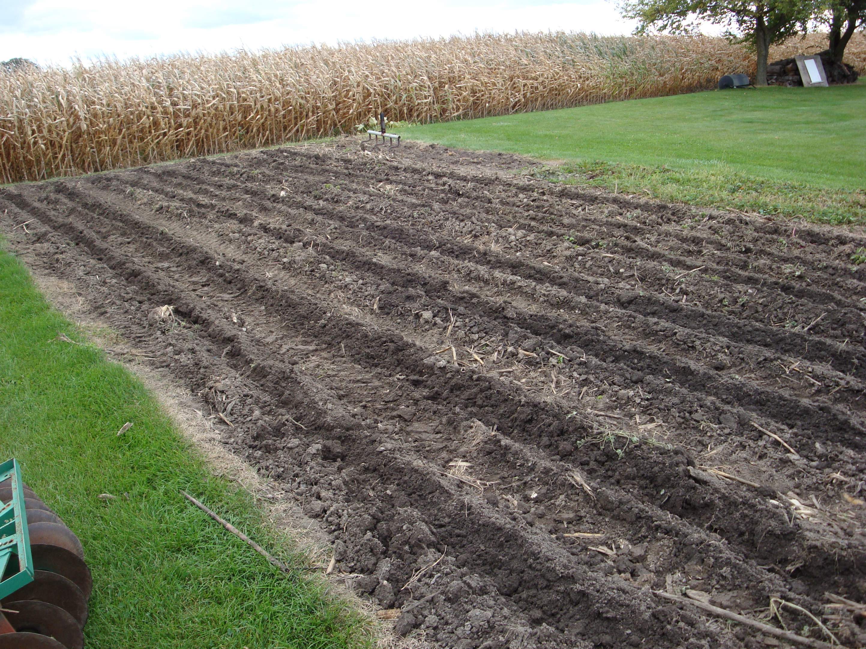

My gardens have been remaining swamped in the spring after the rains and snowmelts, so last fall I decided to rip the gardens and see if they would drain better. Man what an improvement. They dried out faster and the soil worked up nicer this spring. I sunk the sub-soiler down the the crossbar, and I had to raise it to keep from piling the soil up at the end of each pass.
