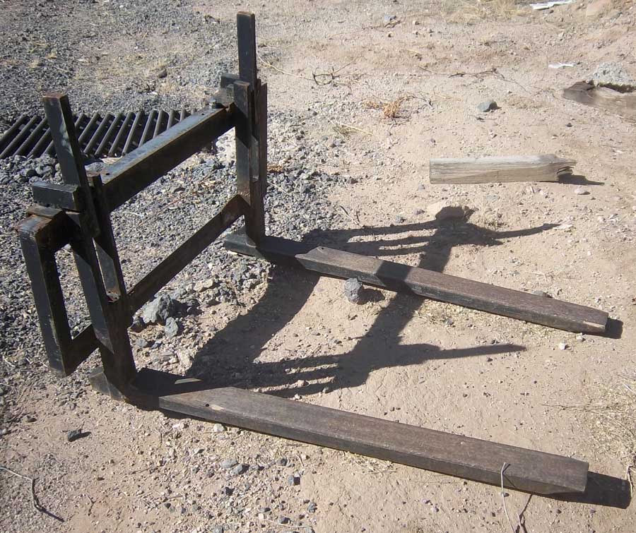

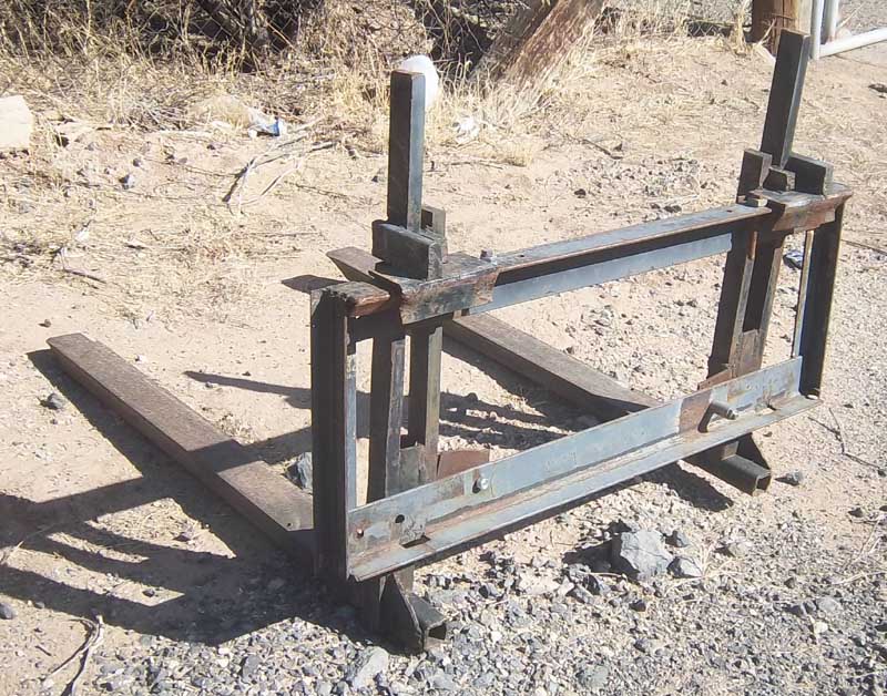

About $50 worth of scrap iron, some welding rod and maybe 12 hours and you got it done. No UPS or extras.
My forks go on and off, including dropping the bucket in less than 3 minuets. Unlatch the bucket, back out, drive into forks, and latch them on. If the job is very far way, pick up the bucket and drive away.
I have picked up 2,000 pounds with these. Load has to be all the back at that weight or the tractor will not lift it.

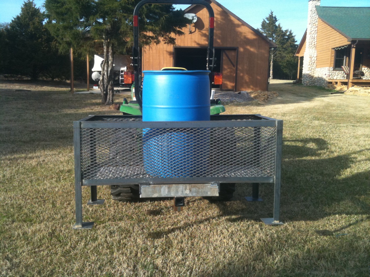

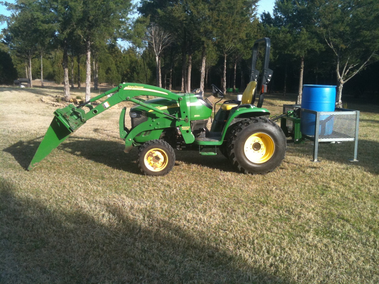

This is what $240 and about 20 hours got me last weekend. I am always struggling with having the right tool with me when I take off across the land with my tractor and also looking for a way to water tree transplants that are not close enough to my water supplies. This should be able to do both and helps me get some welding experience. As you can tell this is still a work in progress but you get the basic idea. It attaches to my iMatch and also has a 2 " receiver on the back.
