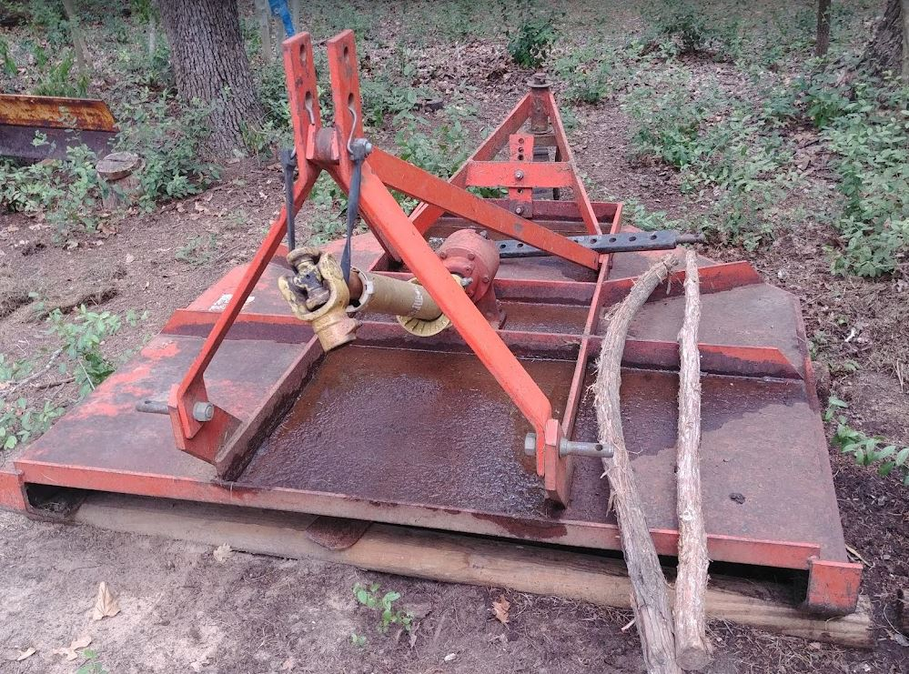

Hi All, I'm new to the forum and have a rotary cutter I need to repair. Does anyone know what brand this is?
   / what brand is this Rotary Cutter? #12
I don't just pump grease in it. Grease will not ever mix with oil if it's just pumped in. Cut off an oil can and mix gear oil and pump grease together and then put in gear box. Gear boxes have a side plug on them and that's the oil level. Make sure the vent is open too. If the vent is not open it will push oil out when it warms and expands. Too much oil and it will push oil out. I just bought stump jumper for a rhino 6' with a 110 hp gear box for $500. Changed it right out. Just loosen bottom castle nut and put cottter key back in and go cut a little bit. It will be loose. Then take it off if you need to. Never Seize is your friend. But make sure it needs to be removed. Make sure oil level is correct and vent is open. If you don't check those easy checkable things, a whole stack of seals will not fix it.
