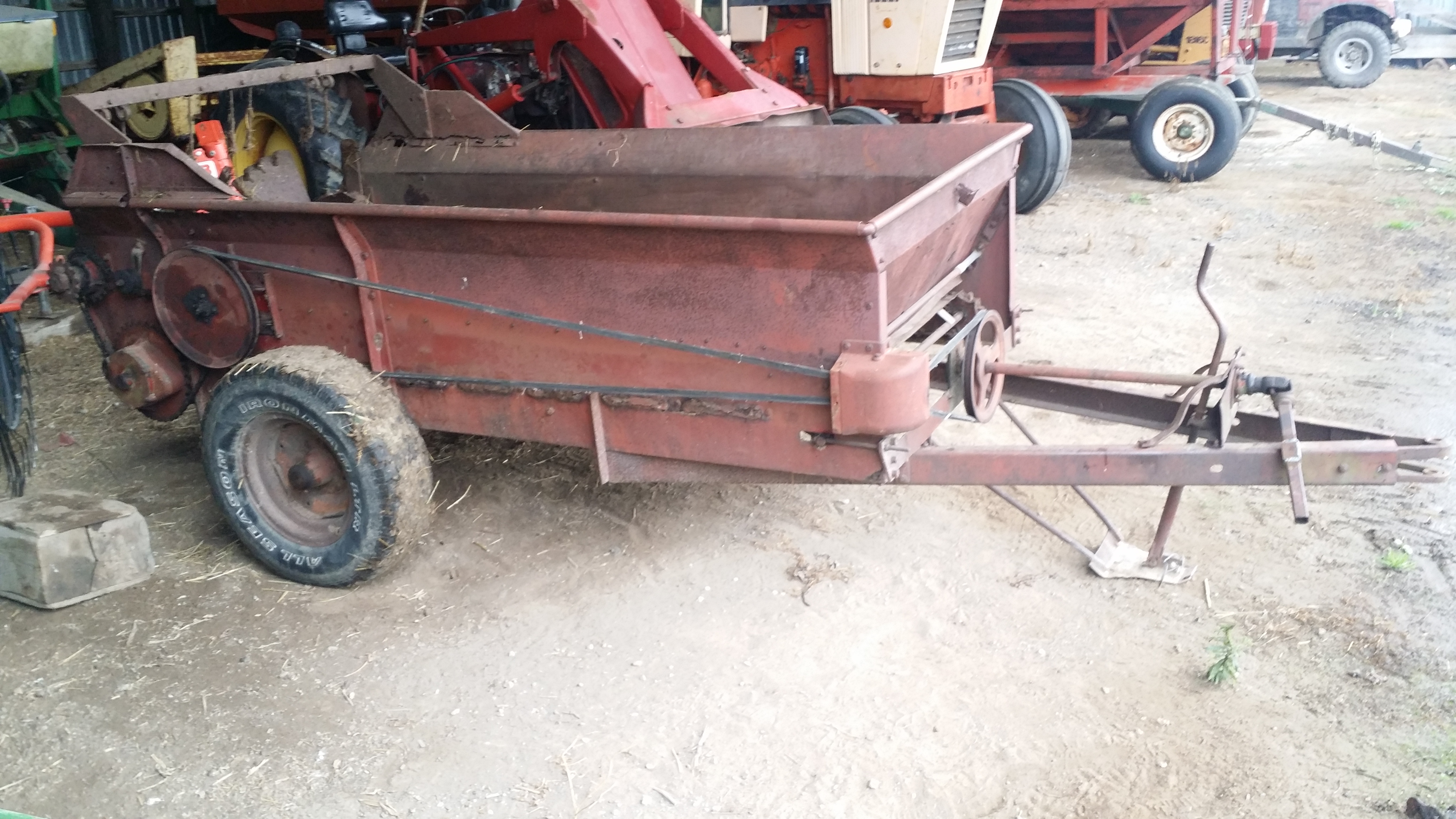

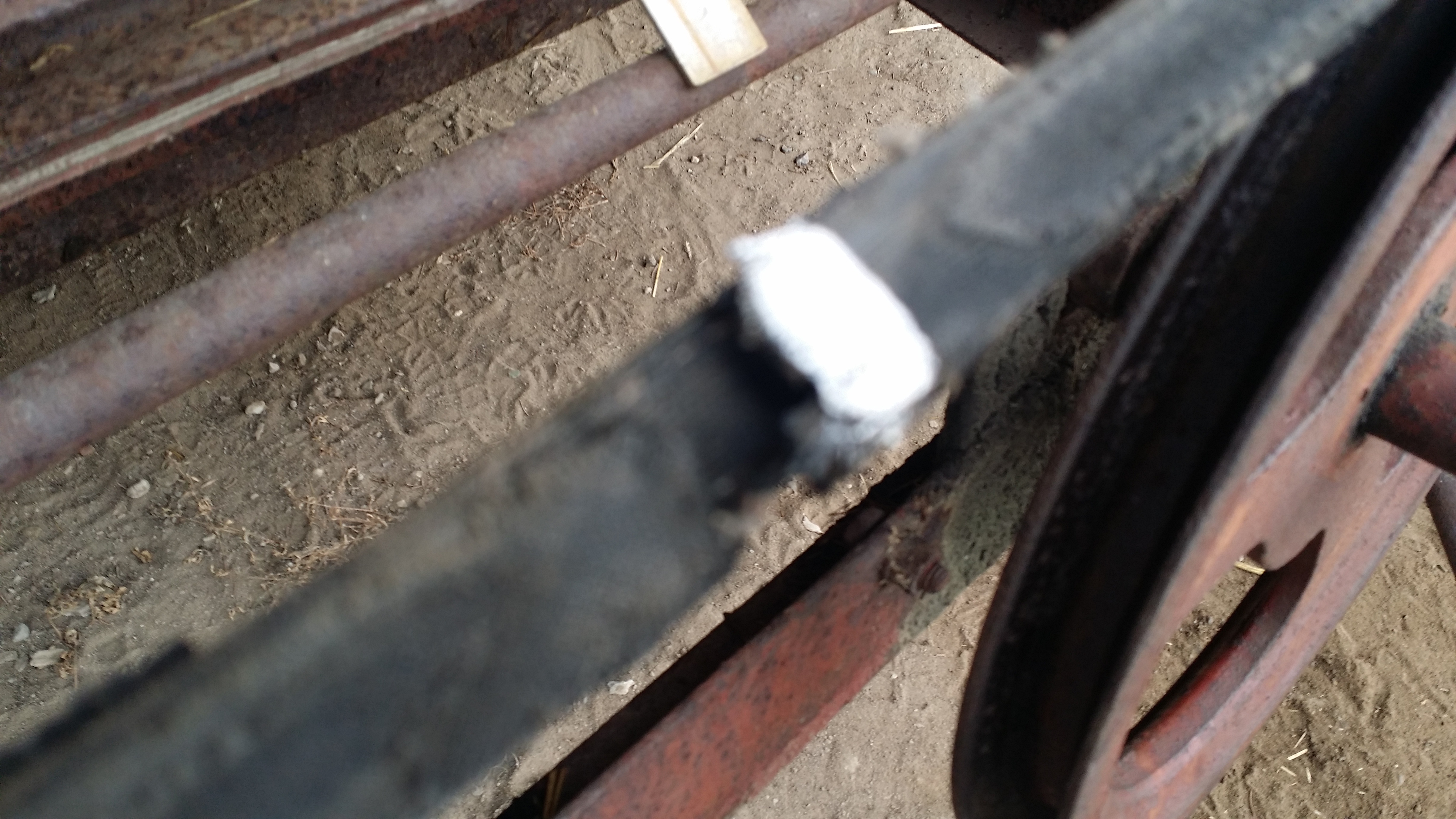

I have an International Harvester 103 manure spreader on which the belt is about to break.
I tried to find the part number, but no luck so far. Messicks has the IH 103 on file, but the belt is not listed.
I can measure the length of the old belt, but I think it has the wrong width and profile.
Does anyone have access to the Case database?

A really long one..... Sorry could not help it.....
This chart may help determine belt type... Length should be easy after that.... Probably half dozen sources for belt once you know specifics...

I have tried the C, the width is right, but the angles are wrong. The sides don't touch, only on the top. The 5VX seem the right shape, but would run deep in the pulley. The 8VX is to wide.
The length is something like 270 inch and it drives everything. That's why I want to be sure I get the right belt.

I've got a big book of belt specs and cross reference, there are a couple belts in the 272.2" OD and .875 TW range that might work. One has a cross section that resembles C above, and another that looks like the VX series. Look at a Dayco, Gates, Goodrich, Goodyear or Uniroyal C270 and see if it matches.

On something that old, you may be also dealing with worn pulleys. That might be why every belt profile you try does not match all profiles.
