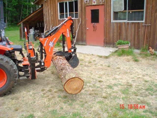

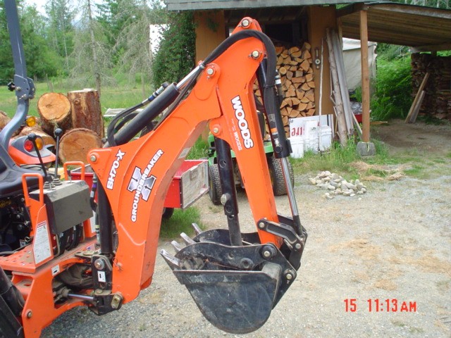

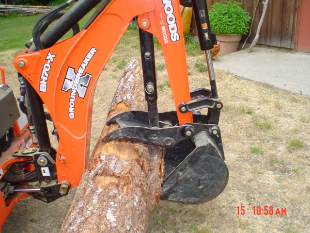

I have the Woods BH70-X on my CK35, it is two bolts and off it comes. As you mentioned the sub frame stays on. The BH6000 is an option for you as well. Respectively 7 and 6 foot. I have colored tape around both sets of the hydraulic hoses and the fittings on the tractor for when plugging them back in the right way. :) As well I got the backhoe with the 7 position thumb as I knew I would be picking up logs, brush and firewood rounds. :thumbsup:
