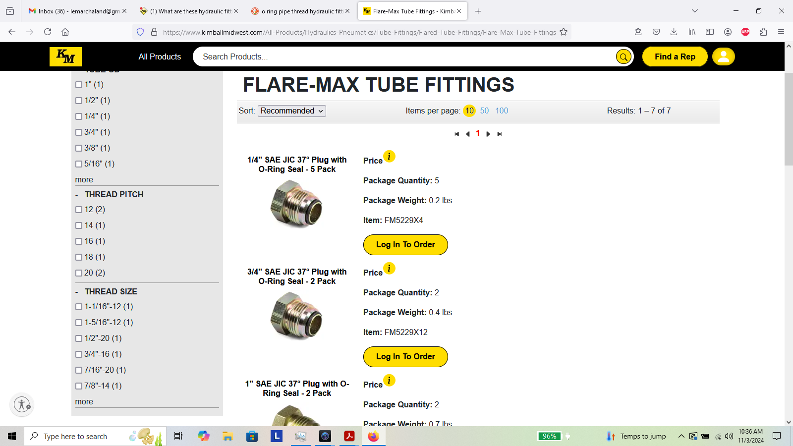

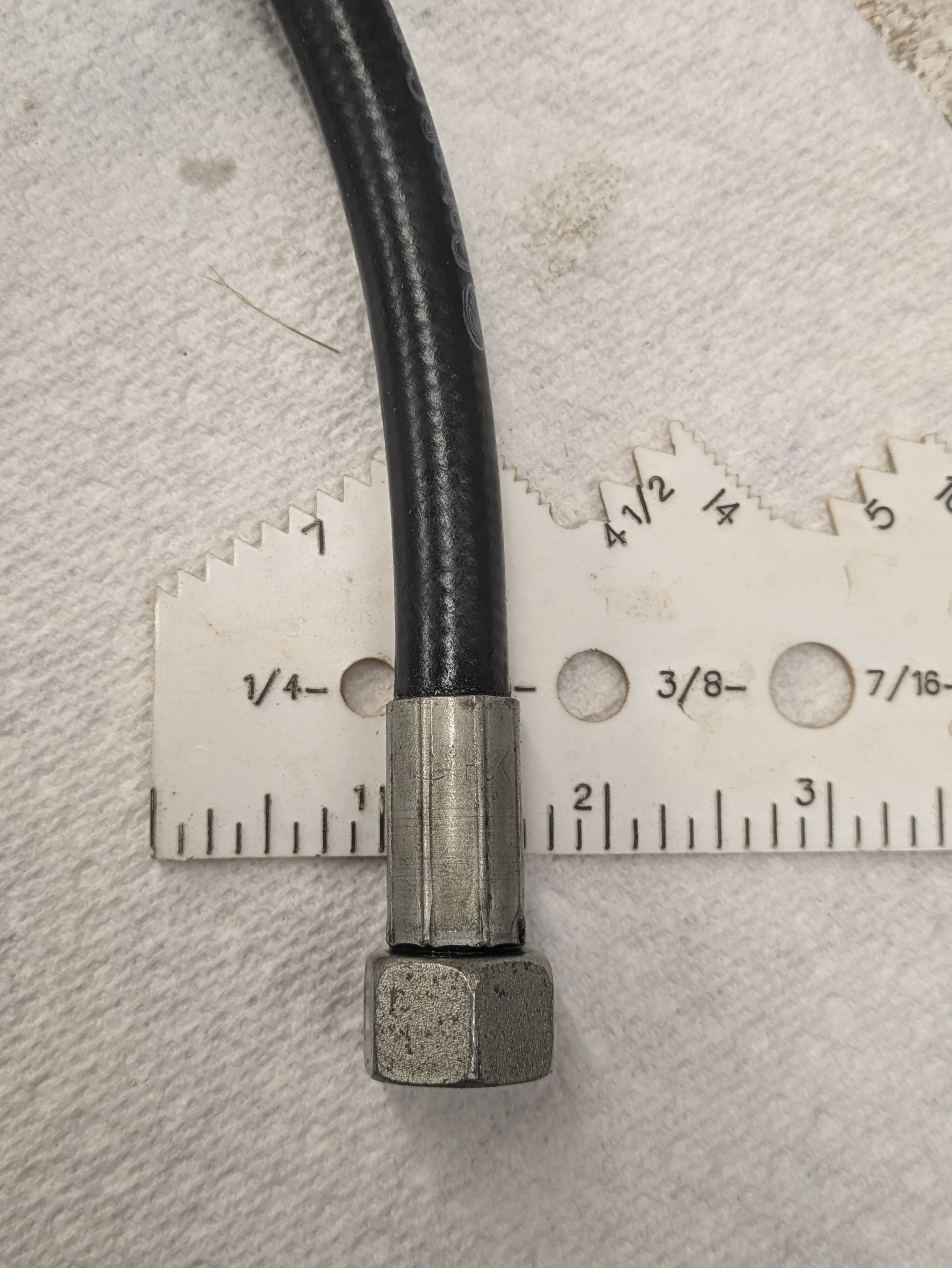

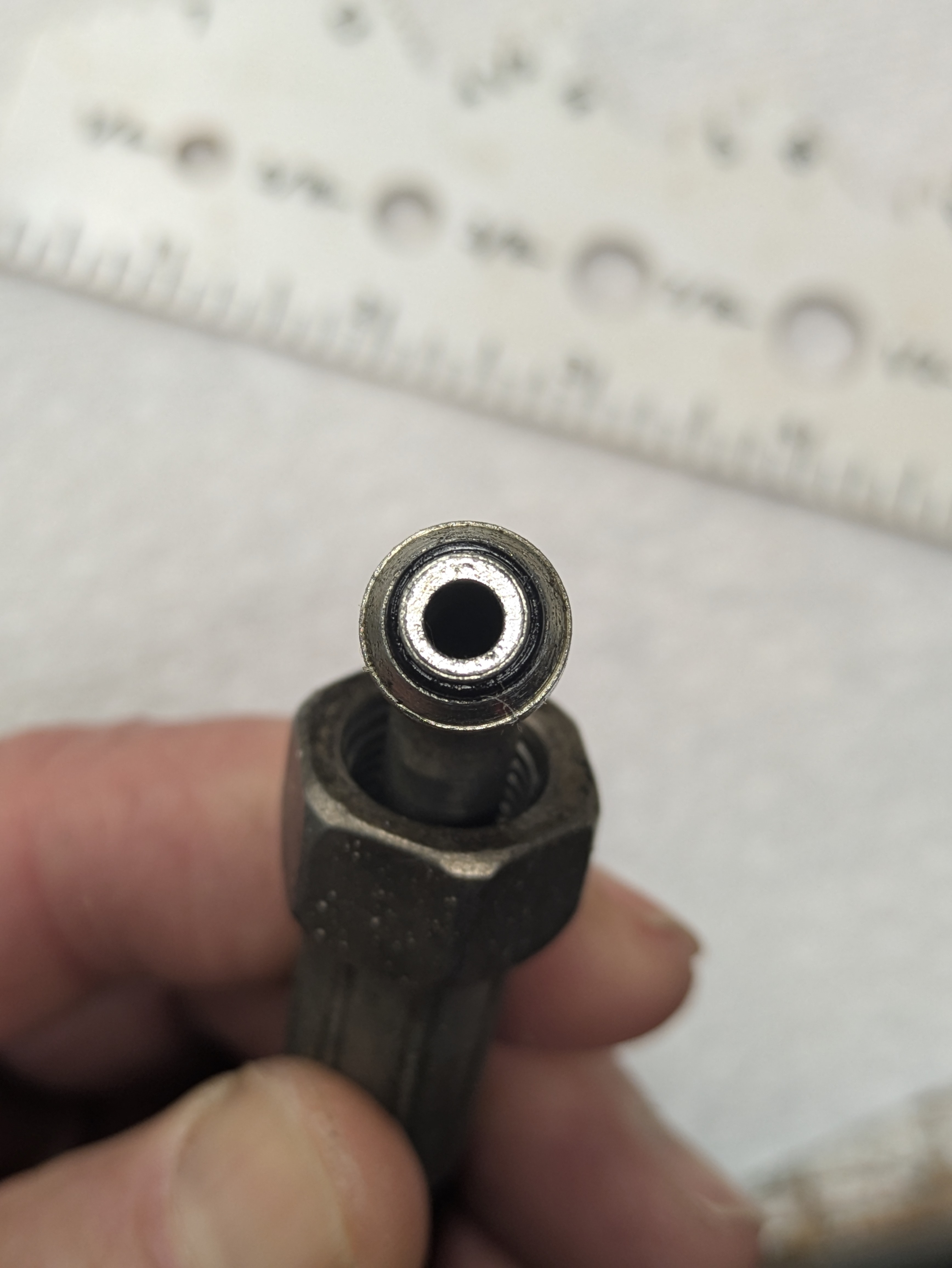

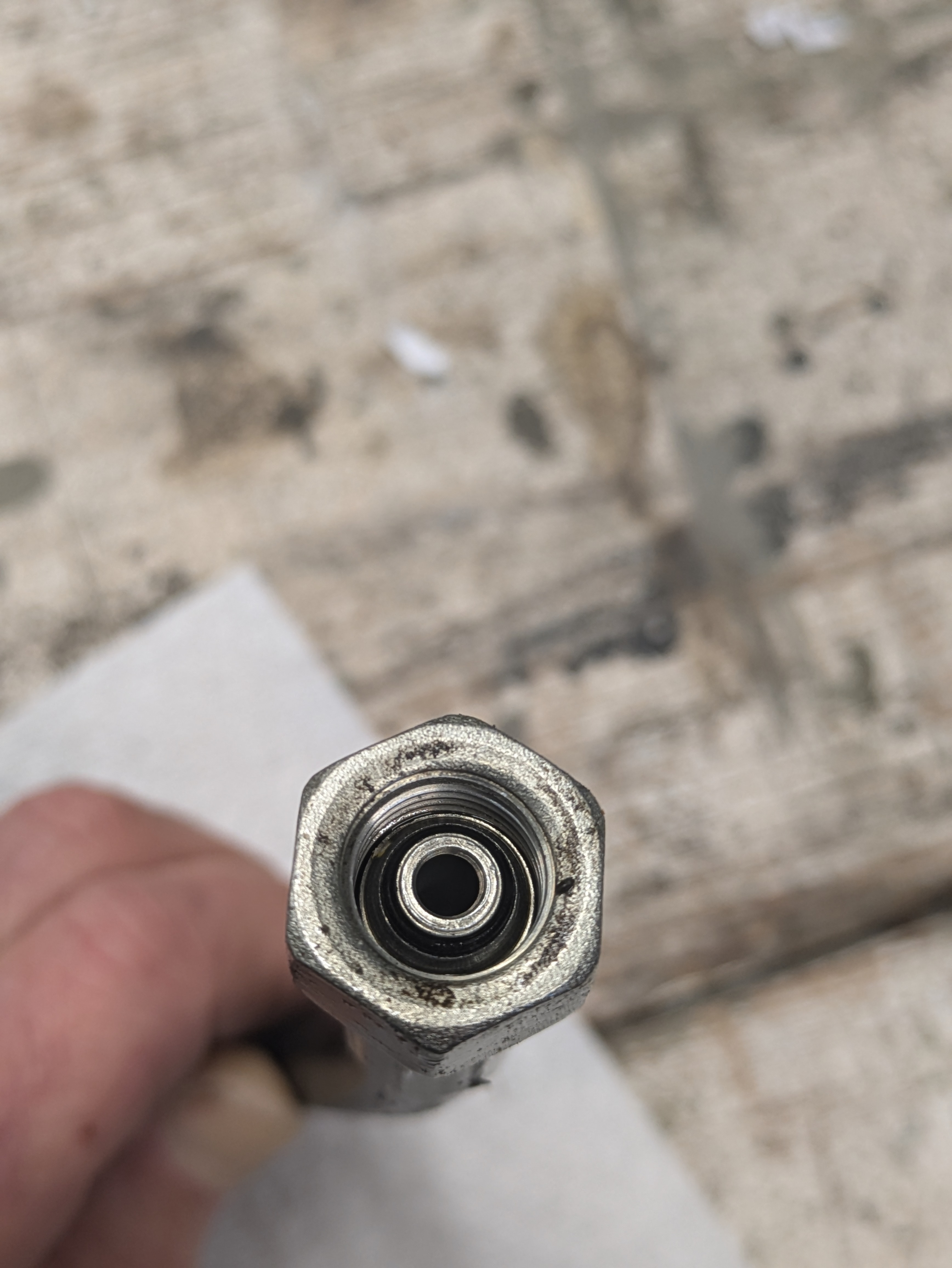

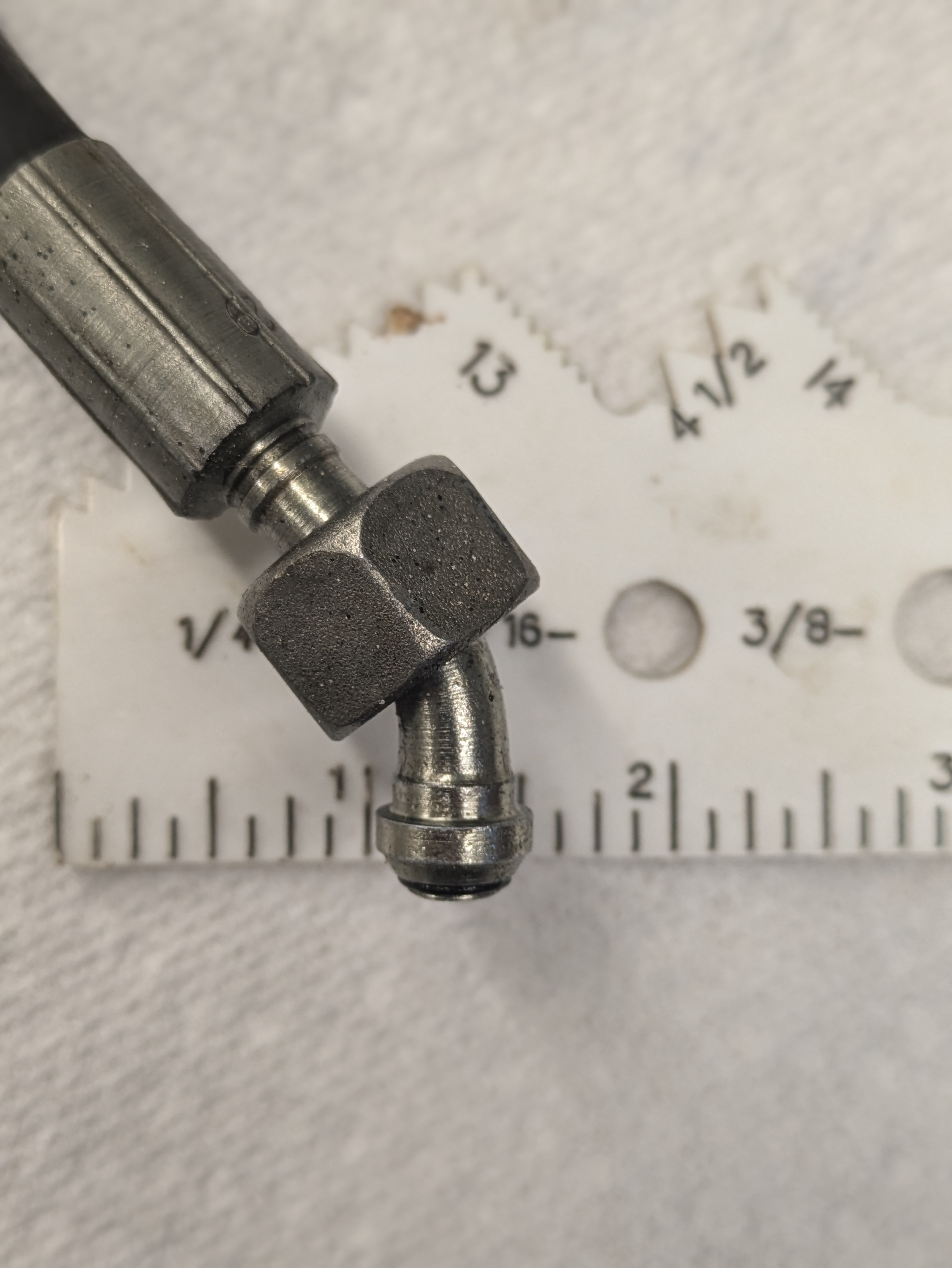

How about BSPP. If you are sealing on the o-ring you don't want a tapered pipe thread.
