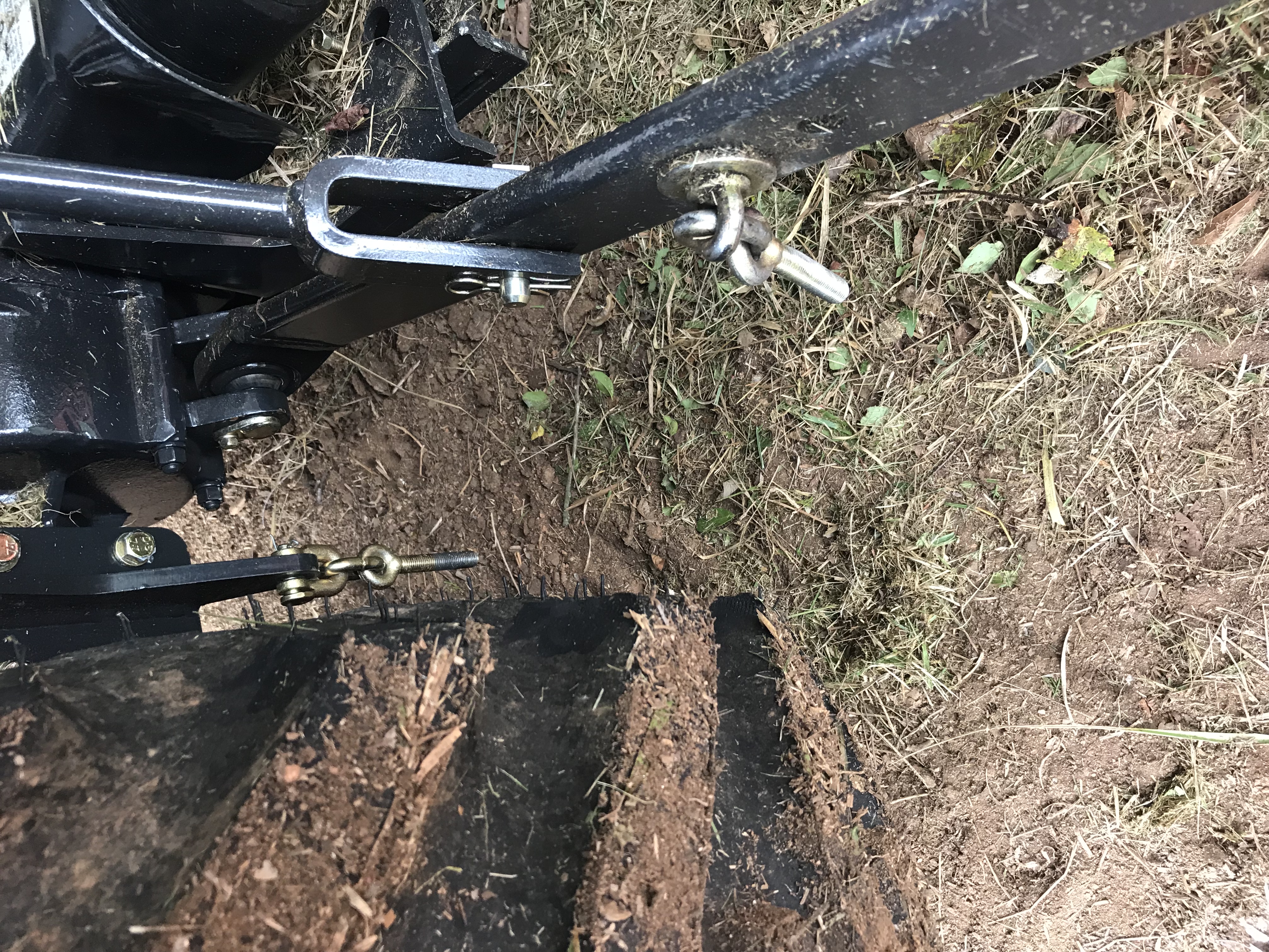

It was quite bad form for the dealer to deliver it like that......
I agree. I don't have him here to chew his ear because he was in a hurry to drop it off as he was heading to a fishing tournament. So I believe someone just got too hurried when they put the bush hog on. I can only imagine but I suspect that they were too tight and they had to pull the clips out and meant to readjust them but forgot to finish that up? All I can think of. But Ill let him fish and give him an earful on Monday. The guy that I talked to yesterday (son in law I think) was incredulous as to how that could happen. Me too. It can only be simple inattention and distraction.
As to the adjustment. I haven't done one of these in maybe 30 or 40 years! At most points you set it and forget it. At least thats been my experience. Its always been the bush hog that set that sort of thing and everything else was fine with it. I had the solid pin type stabilizers on the old 5030 Ford. And before that only chains on a previous 800. So I adjusted them and left some slack. Perhaps on hind sight now I left too much? I thought all you had to worry about was making sure the whole thing could not shift over into the wheels? Thats how I adjusted them. So they would shift over but not come near the wheels. Those of you that noticed and thought it was too much slack were right! Or perhaps I just did not get the jam nut tight as I thought I did? I dunno...
... as predicted! Wait for it!!!
Lost one of the turnbuckles today! The left one. After about two hours of hogging. Even with the jam nut tight it somehow worked itself loose. So perhaps snugger (is that a word?) was in order in hind site. There must be a happy medium that I missed. It would have near the end of my work on making a outside turn on a slope I felt it suddenly start to shake a bit more than usual. Looked back and it shifted way over to the right. The right one stopped it shy of being any danger but it was over more than it should be. So I stopped and shut the PTO off and got off and and looked and darned if the threaded eyes were all hanging there but the turnbuckle had gone missing! I of course stopped work and figured it was close by. But I cannot find it at all. So my bad now.
Darn things. Its like the three stooges for me this week. I gotta find one or get them to give me one. I think maybe i'm leaning towards getting some solid stabilizers. Anyone know a source?
At the moment I just need another turnbuckle. No time to get over to the dealer today.... maybe Tractor supply? Doesn't look anything special?

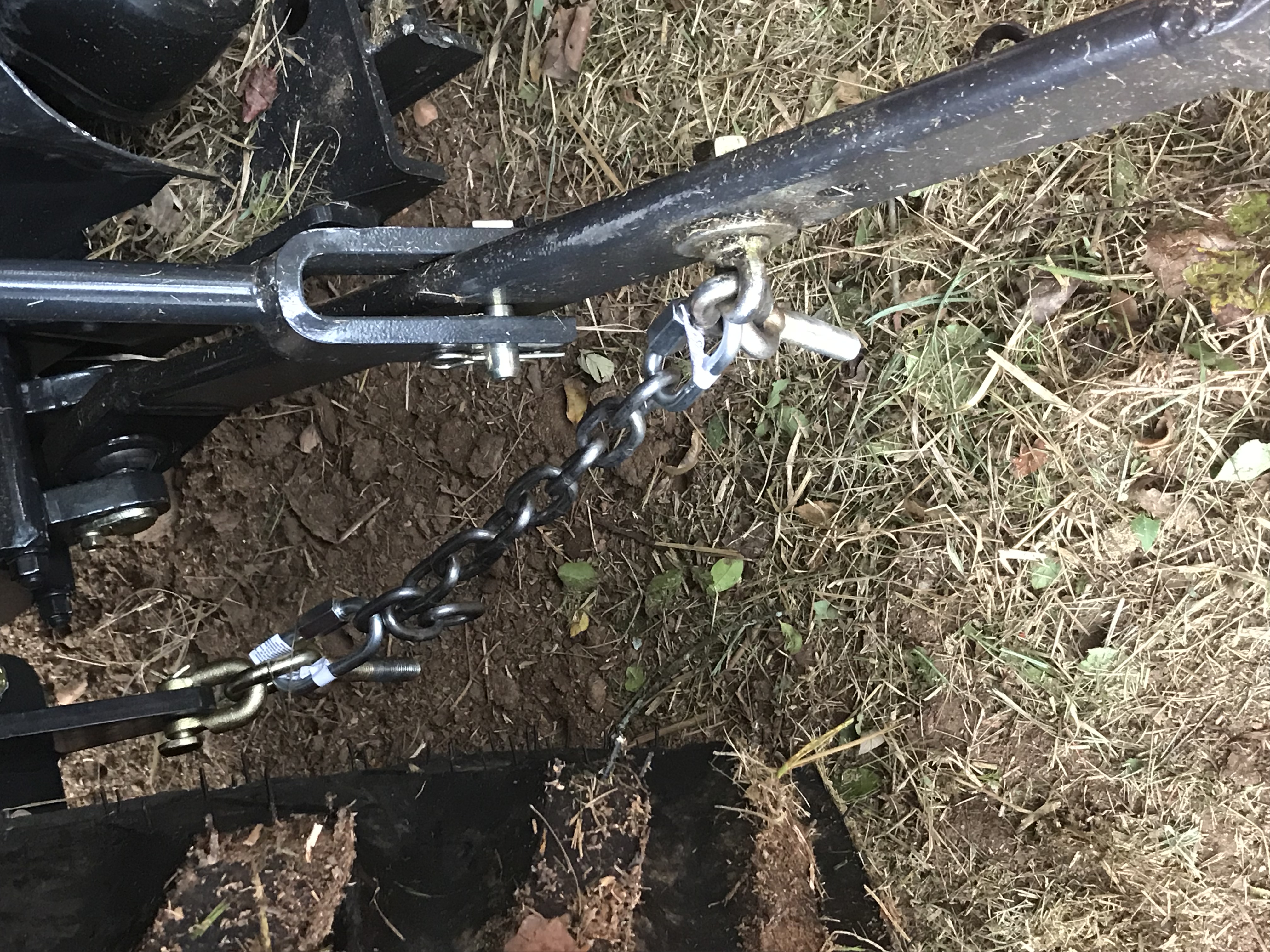

Good luck finding a replacement t-buckle, many brands sizes and threads.
Happened to me also and I used a length of chain bolted at both ends to replace the side with missing t-buckle and then adjusted with the other side t-buckle.
Ended up buying a generic set and replaced both sides meanwhile the 'chain fix' lasted until arrival of replacements.

Here is a picture of how I found it.

So I did the temporary universal fix... seems to be ok for now.
