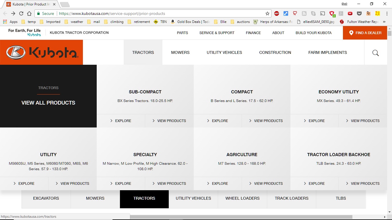

Apparently I wasn't clear in my question -
What is the general rule for what is a subcompact? under 25HP? little front wheels?
Or a Utility? Over 50 HP?
By Kubota's separation of classes Compact tractor covers everything from 17.5 to 62 HP, which entirely overlaps both their Sub-compact and their Economy Utility.
