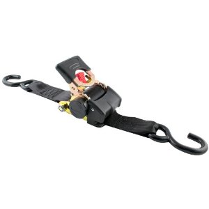

I like Erickson straps. I use their smaller ones when necessary, but usually grab the large 2" Erickson "Tie Down Tamers" when I can. The ratchets are a bit better on the large straps, plus the "Tamer" mechanism makes it a lot easier to deal with those annoying strap tails.
Erickson also makes a small, 1" strap with a mechanism like a seatbelt retractor that looks interesting, but I have no idea how it works in practice.
Have never seen anything like the smaller "seatbelt retractor" type...wondering how it works....gonna do some research now. Oh, wanted to pass along a tip I have for using straps on sharp edges...know that indoor-outdoor low pile grass carpeting? I cut a number of small squares and strips of that from a bigger section, it works just great to protect just about anything.

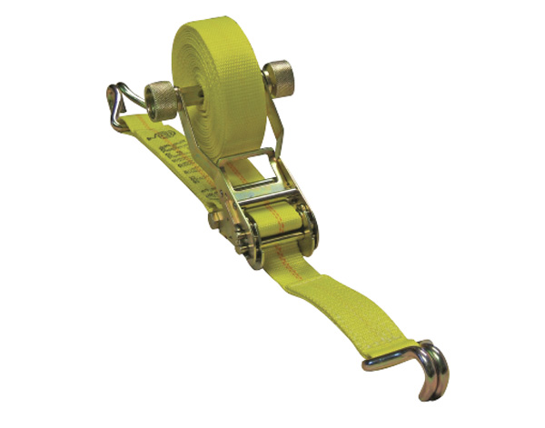

I've become a big fan of retractable straps. In fact, that's all I'll buy anymore. For me, the strap tails are very annoying. Right now I have a bunch of Erickson retractable straps that go on in seconds. All you do is hook, retract the slack and ratchet to tighten.
I just ordered a set of Quickloader retractable tie downs for my tractor. Their more heavy duty and I got them from Northern Tool. Let me know if you want to know prices.
Once you use the retractable, you'll never go back.
