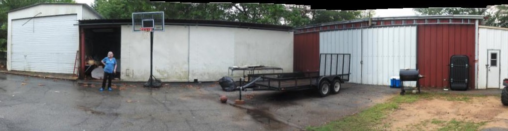

I'm about to get fibered in Mississippi. By this fall the local power company expects to have the infrastructure to my door so I can get 100 Mbps up and down. Compared to the present 7 down/0.7 up.
So I want to start wiring my sheds
so I can put up a bunch of security cams and access points.
Since the sheds are metal I know I'm going to have to do a lot of hardwire. To that end I'm planning on at least. 20 runs of cable so I figure a box of Cat 6, 1,000 feet will get me started. All runs will be exposed inside and there are no tight bends so I was figuring solid versus stranded.

   / What are some good online sources for Cat 6 cable and pass thru connectors?
POE Cameras, access points, computers. I've become addicted to being able to log onto a laptop whenever I have a question. And my need for speed.
Like I wrote, the internet had been limited to 7 down, 0.7 up. That let me stream off site 2 cameras. 100 up will be a game changer.
Plus I've read it's possible to stream movies :)
But again, why run wire?
For starters -
Because I essentially have 4 Faraday cages
To run POE, I've yet to see Power Over Wireless.
so once again -
I haven't had to buy raw cable for decades. Where is a good place to order from?
/edit
POE cameras are the gold standard these days. Wire is required for those.
I'd add a wireless access point inside each outbuilding and be done with that.
Wire between buildings would also be cheaper than wireless if they are somewhat close together.
Yup, and if you looked at the picture the 4 existing buildings (Faraday cages) are only separated in one place by a few feet.
