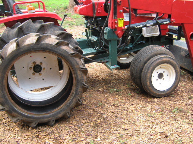

yeah you are a good distance away from each other, I was saying if getting all 4 tires front & rear, I assume would be pre-matched to the gears ration, the 9.5 would be roughly 2" taller then the 8.3 , which would not match the current tires you have on the front, however if the front were upsized as well by roughly 2" wouldn't this keep the ratio the same :confused:
Here is an old photo I dug up, it compares the larger 9.5 x24 <-to the-> 8.3 x24

Actually, going up 2" in diameter in both front and rear tires will change the ratio of the 4wd. For instance, if my front tires measure 24" in diameter, and my rears measure 37", I have a ratio of 1.542. If I go to a 26" front and a 39" rear, I now have a ratio of 1.5. Is it enough to matter? I cannot answer that question. I do know, however, that I want to continue to have roughly the same ratio as the factory provided.

Oh! Ok End of story than,:D
