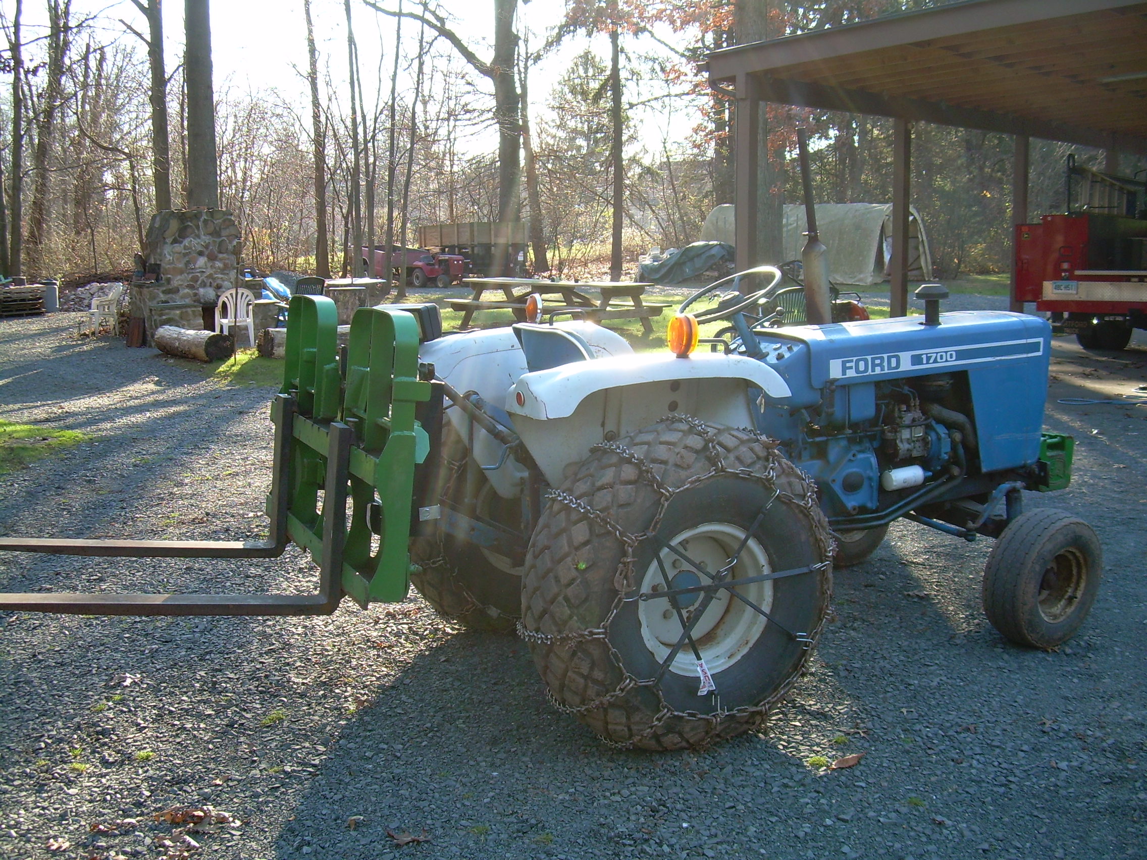

You can also get a 3PH mount, either plain or with hydraulics. The 3PH mount lets you keep you loader function while lifting more weight. Drawback is you can't lift as high. I just bought a used one with hydraulics (not easy to find used) for the back of my tractor. For my little tractor, it is much more functional on the back: twice the lifting capacity. (and I don't have QA either).

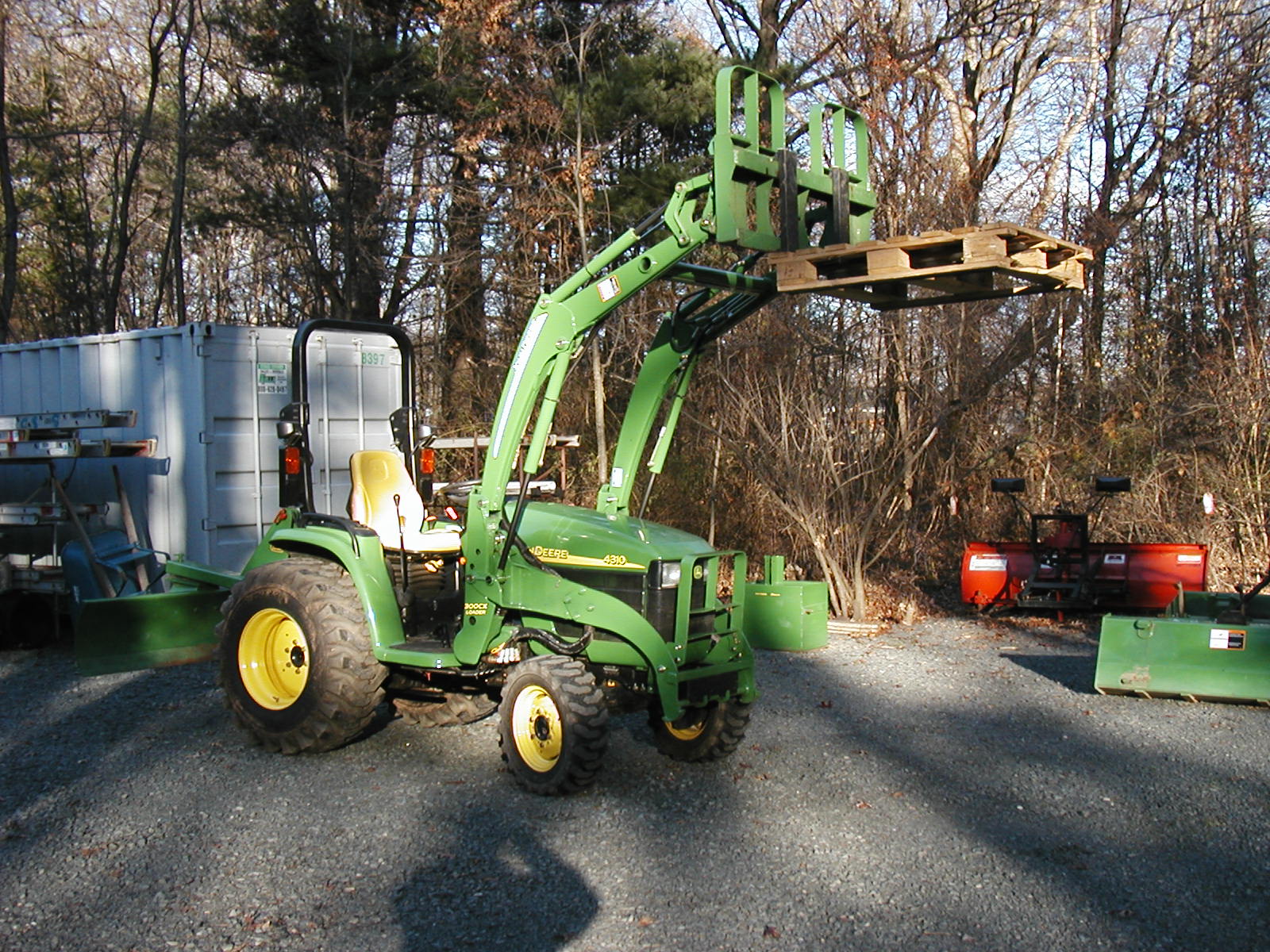

Might be a good idea about the skid steer adaptor, another benefit would be that any implement would be easier to sell since it's so universal, unlike the proprietary JD QA.
If you stick with JD QA, I've got the Horst HD3742 with 42" cast forks rated at 3700#, and think they are one of the best, I compared them to JDs and thought they looked better made, a little pricey at +/- $850. though.
http://www.acidist.com/Pricebooks/horst.pdf
Wow, just checked their site, I didn't know they made this much stuff.
JB.
