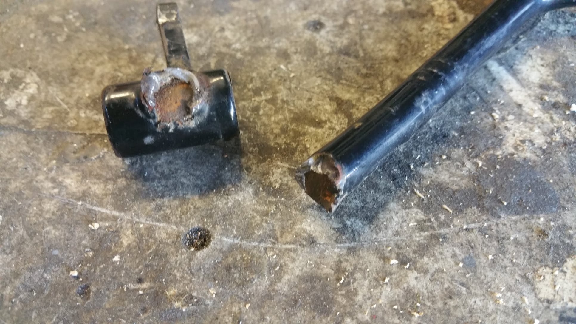

old oak has a point here, if you want to stick weld thin stuff, you really need an inverter welder, thin rod , low amps, (40 to 60) and need to lay 1/4 inch , pull off, let it cool chip slag and start again. this is exactly how i fives my shuttle drive lever yesterday.
