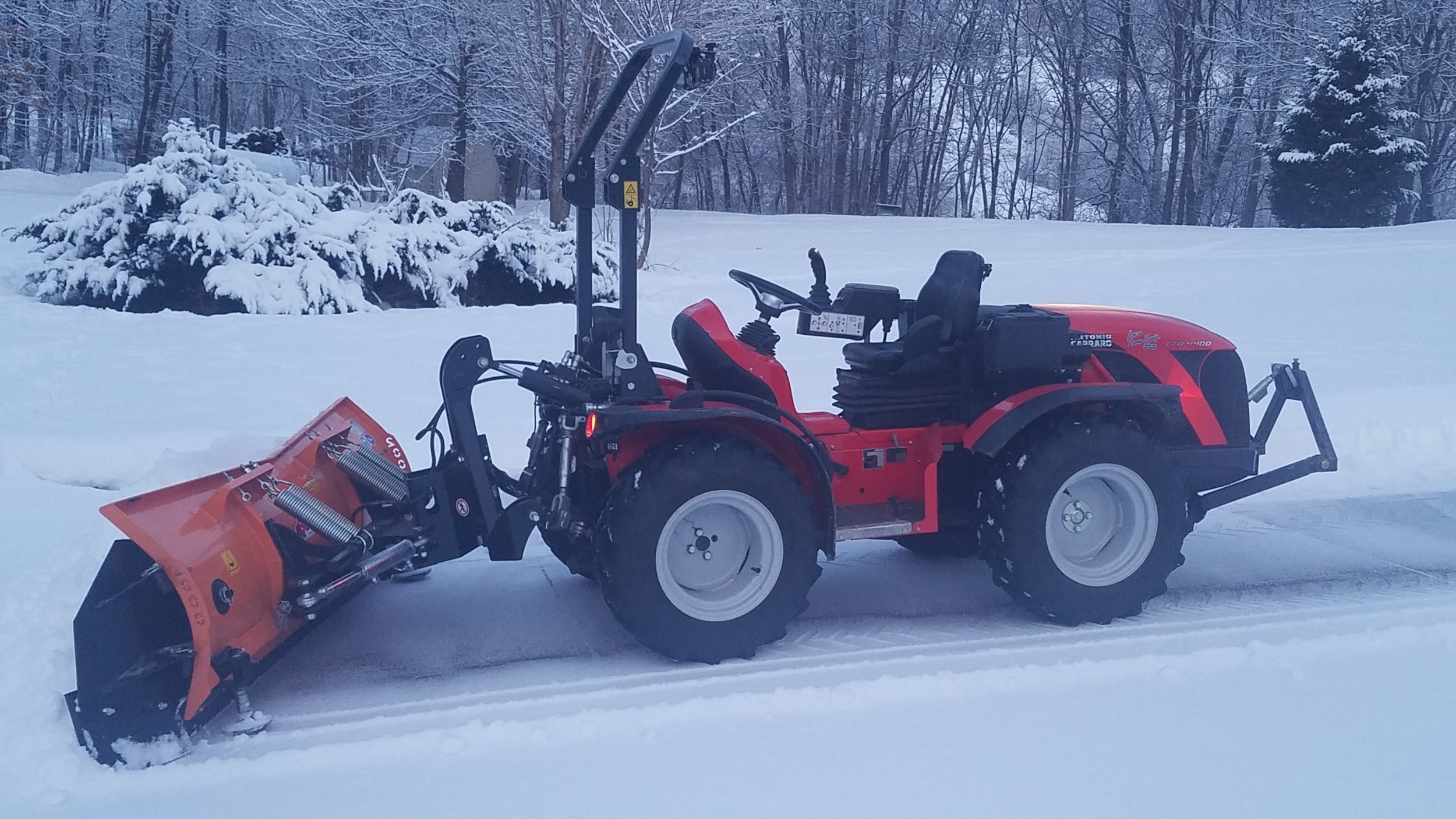

The Bonatti plow that I have does not float like the ones shown first page of their website. Really neat design though. I have a lot of steep and uneven terrain where I live (and plow) so the float has worked well on the 3pt and I know I would miss it. I think the plow will get abused and I will have a lot of gravel on the lawn if I don't make it float. The side to side oscillation (basically a larger opening at the bottom of the pivot pin) accomodates fair amount of float. Pics from the reversible tractor and now on the Toolcat.
