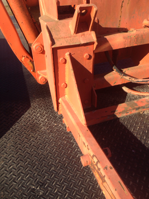

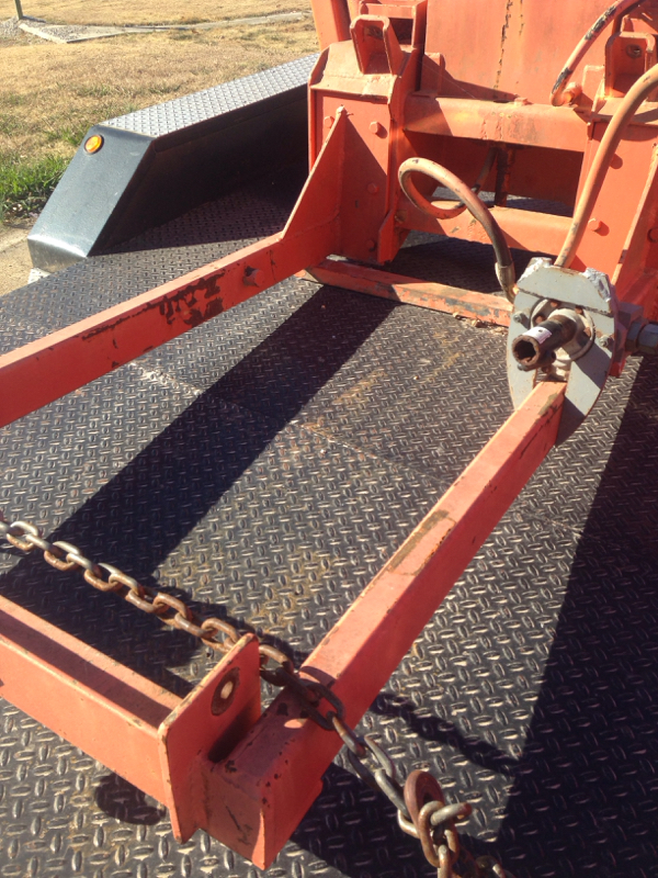

Sorry i almost forgot about getting some pics. These are how they mounted the subframe to the backhoe. It has two brackets that bolted to the rear axles that the pins on the subframe slid into then the front was held in place by two bolts.

thanks....helps a lot. how is the top attached - do you have any pictures of it installed?
   / What about a skidsteer backhoe on a tractor? #13
I'll look and see if I had taken any attached, I don't have the tractor anymore, but kept the backhoe to install on the new tractor.

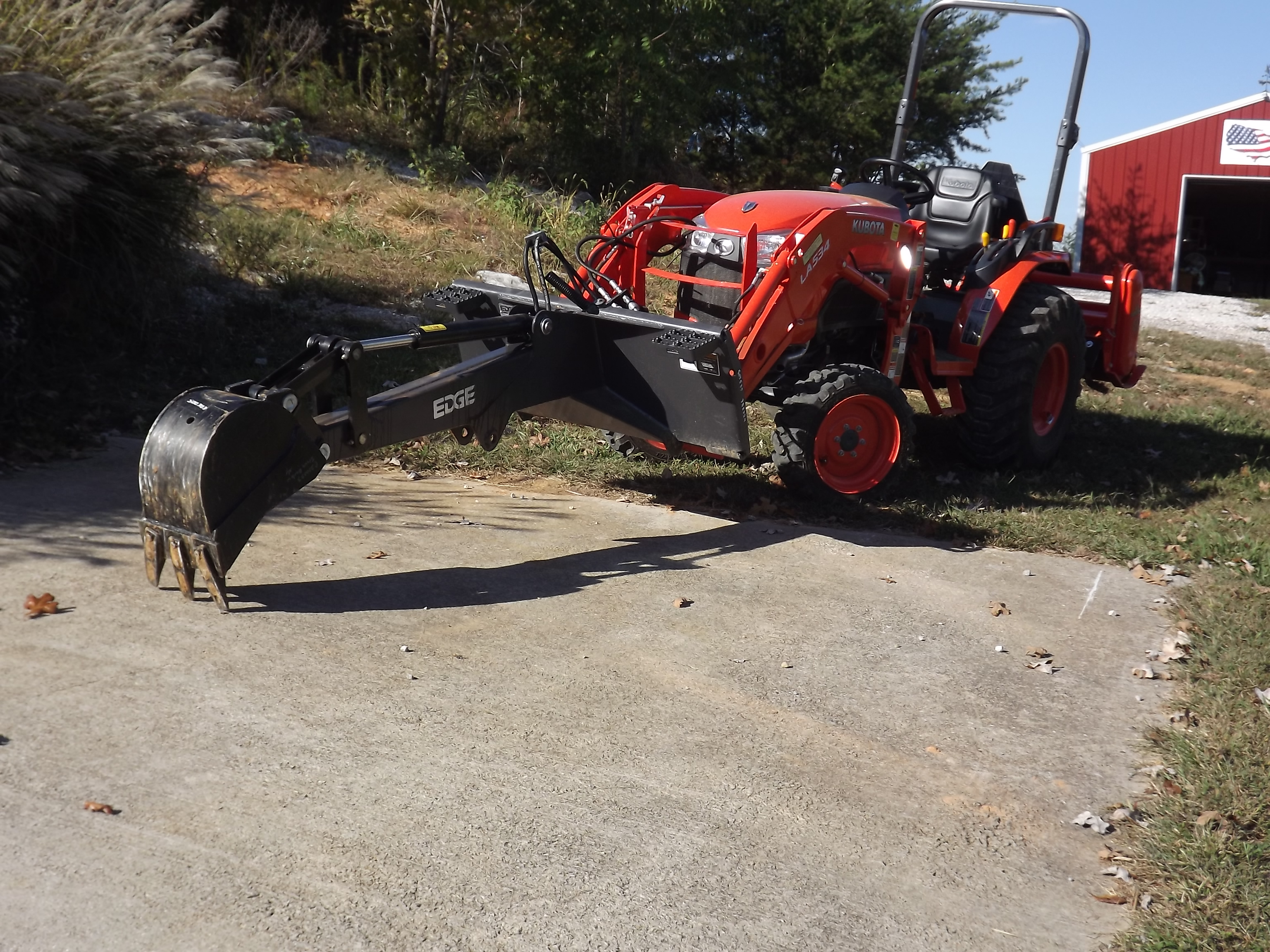

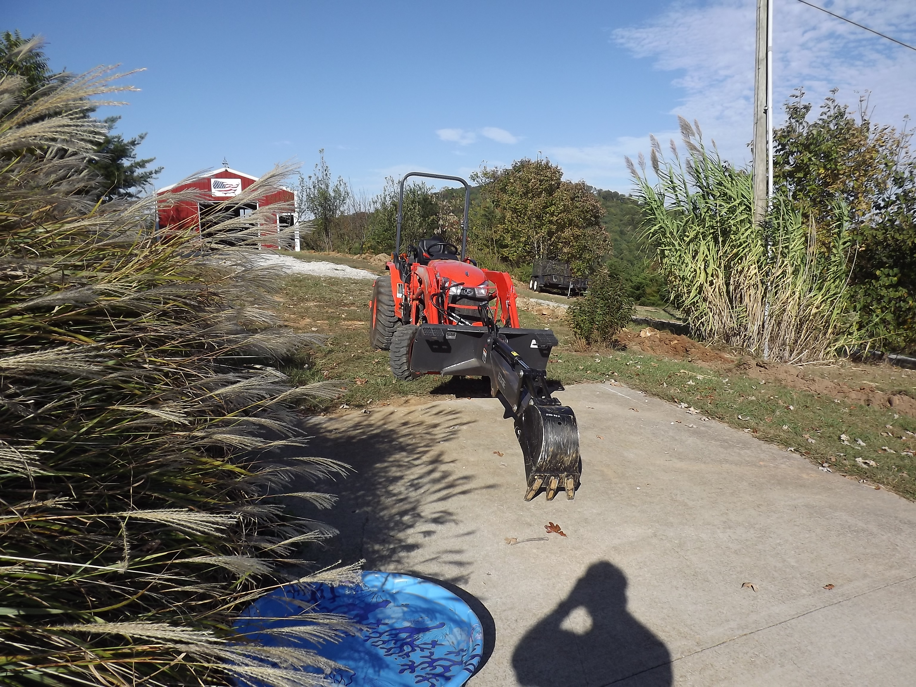

I had bought this backhoe for a skid steer last year. Sold SS and kept for my B2650 Kubota with front hydraulics added. Had offered to sell it for $1500 but mostly decided to keep it. I have one, used it and like it which is my input from actual experience but there are some cautions.

I did sell that front Backhoe for around $1300. Later bought a L3901 and bought another one and since traded the L3901 to a MX5400 and still have the front backhoe but have not mounted it to MX5400 yet to test performance. I had some fitment issues with the "New" front backhoe popping off one corner until I added a piece of steel to the catch point to make it tight enough to keep it on the SSQA attaching plates. Will need to hook it to MX and see how well it does.

I think it works for what it is made for but just don't extend the FEL cylinder arms to far like I did on B2650 when I stood the arm almost straight up so I could see better and had the cylinders all the way extended and bent them. Keeping tractor FEL arms down and extending the bucket and curling the front backhoe bucket should work fine on a solid tractor.
