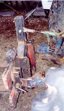

i bult these outa the carraige from an industrail forklift and some flatstock, they are made to fit a category 2 3pt

here is the attachment points for the 3pt, i havent been able to find anything they wont pick up yet, i lifted the front of my ford L600 dump truck with them

Now that is some set up. What was the main pupose of building them.
   / what a real mans set of pallet forks look like
well i built them because i wanted to have something heavier duty to lift things than the loader on our ford 3400,it has a set of forks on it but it wont lift too much weight realy,only about a ton or so,i had the forlift carraige already so i just added the brackets and it can definatly lift alot more than the loader on our other tractor,the tractor i use them on it my ford 8000 which is around 100 hp so it has a pretty heavy duty 3pt,unfourtanatly it wont lift high like the loader but they sure will lift alot,they are handy for moving around pallets of metal and parts as well as moving junk cars and stuff
