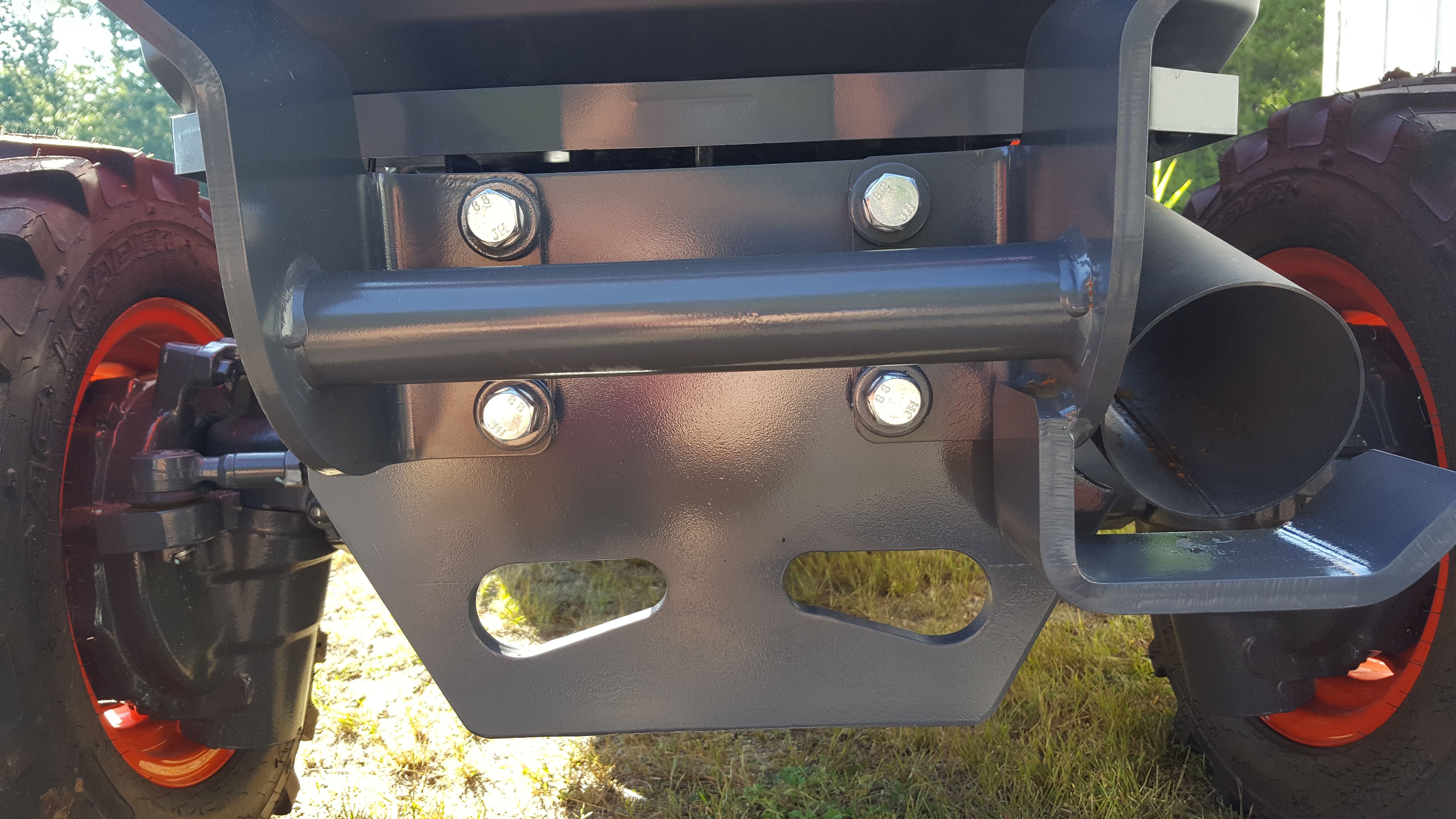

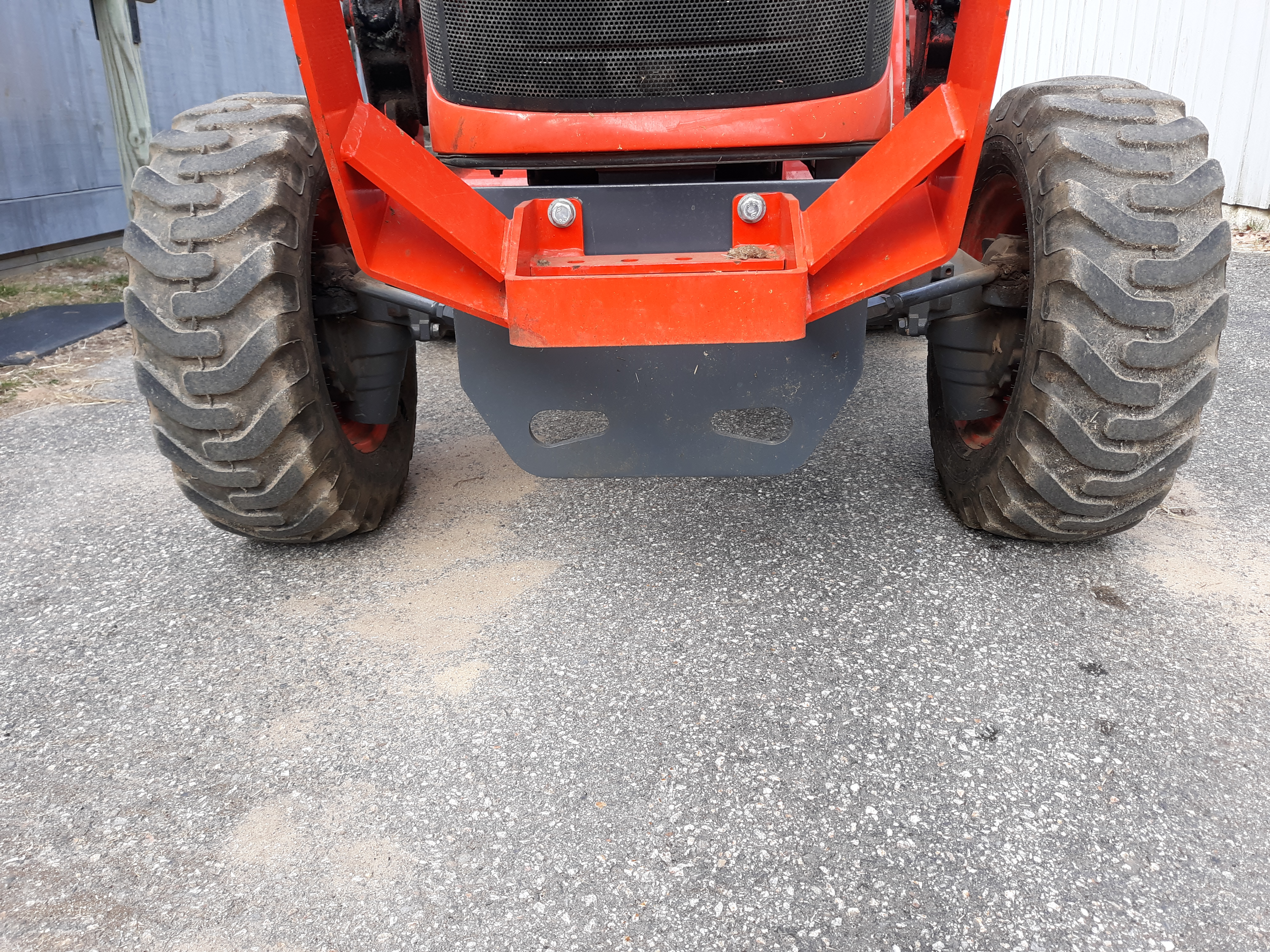

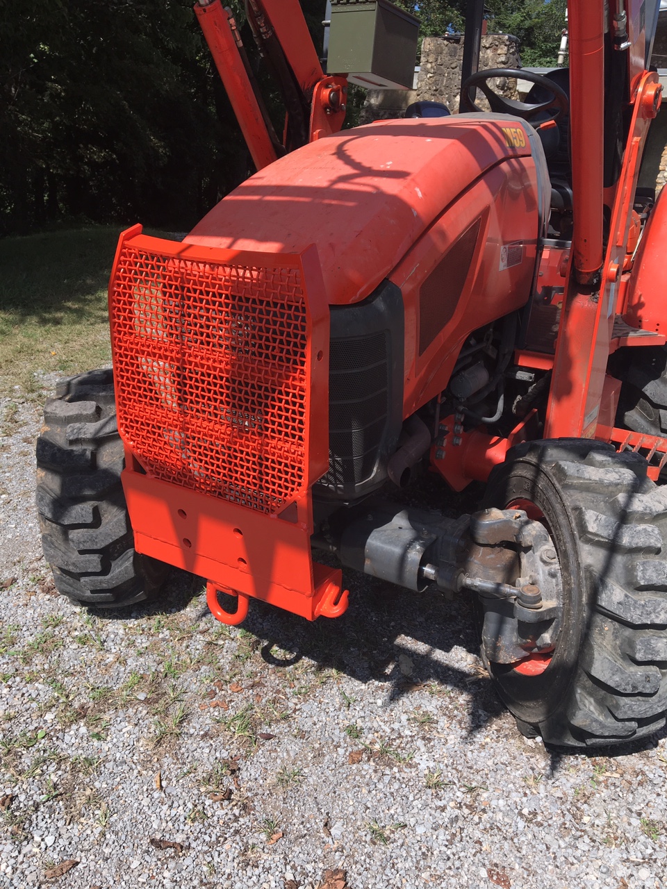

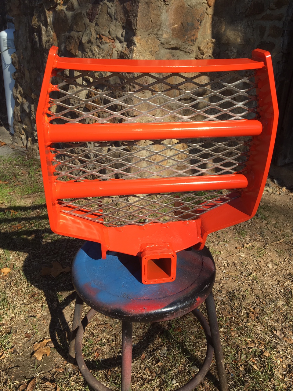

The rear is easy to chain down ,But not the front so I made front tie downs for my tractors.... p2.jpgl3800 front tie down.jpg

Before getting too concerned with the leak I would suggest removing the tie-down chain from the axle, clean the oil, and and work the tractor a little to see if it reappears. The front axle is not a good tie down point and will stress the seals and bearing. The axle being pulled forward like that may be the cause of your leak.
+100 on that. NEVER CHAIN TO AN AXLE, EVER. Always use a clevis on the front weight rack on a Kubota.
