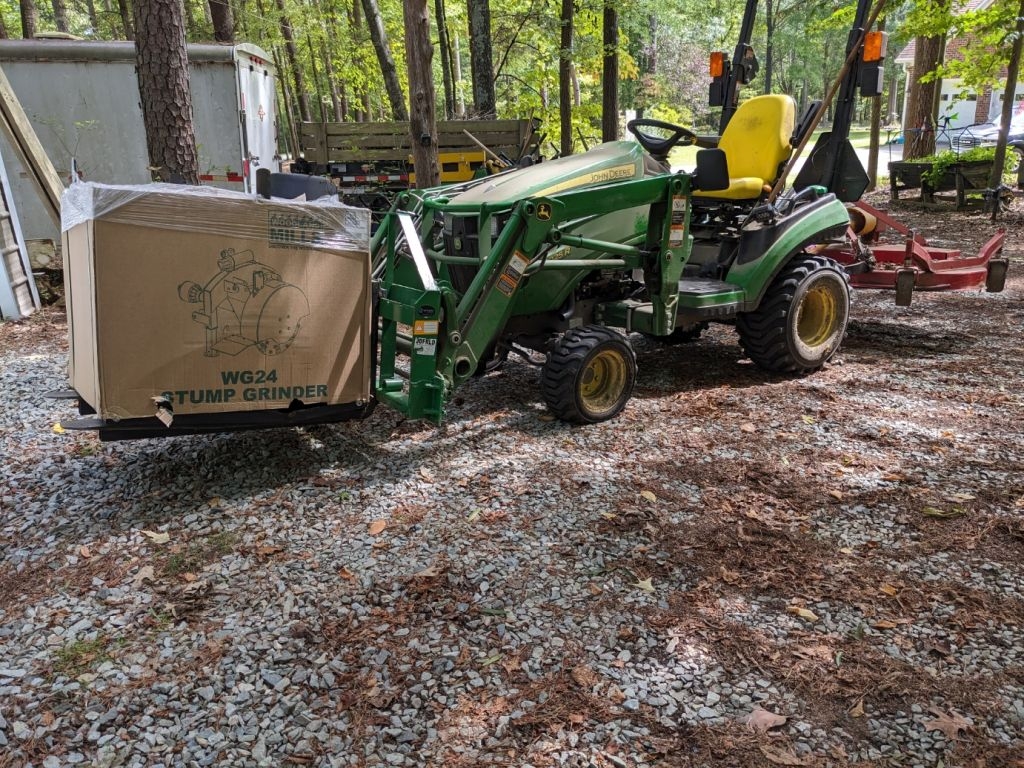

Fedex Freight just delivered a WG24 stump grinder. Big truck, no liftgate. Fortunately the 1025R w/pallet forks was up to the task & lifted it off the trailer deck without a problem.

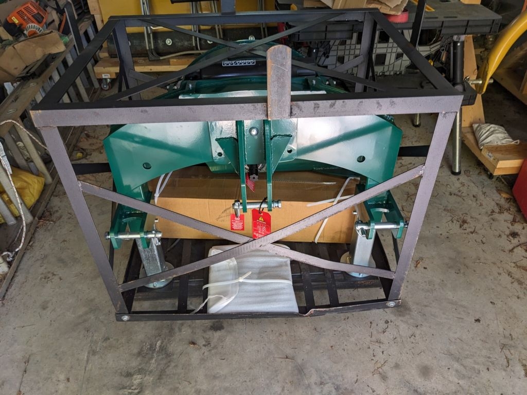

The cardboard is just a shroud around a steel framework & pallet. Everything arrived intact & undamaged.
It'll be a day or two before it gets completely assembled & tested. I'm already figuring on turning the upper frame portion into a table & adding casters to the bottom pallet portion to make a wheeled platform for storing the grinder when not in use.

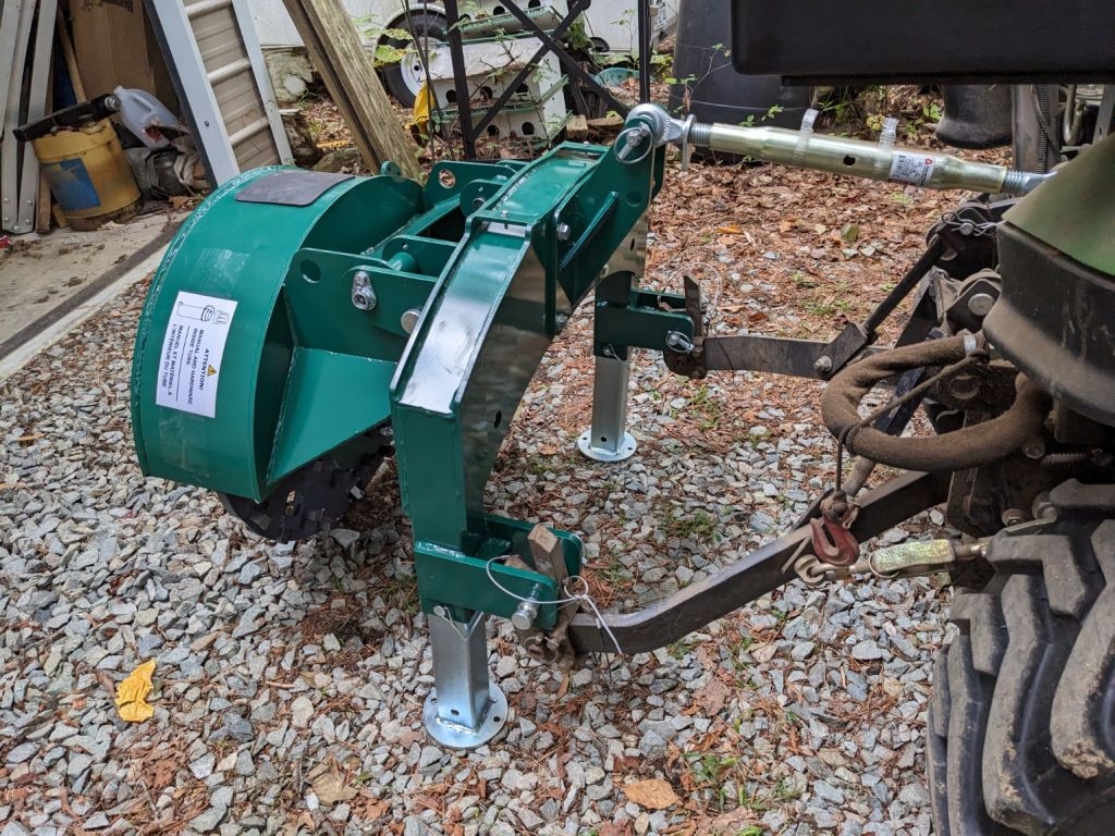

I'll be waiting til next week to try it out. I did the top link bracket install so I could get a PTO shaft comparison measurement. The Carter & Sons EZ Hitch fit fine, so hookup was not a problem. The measurement from PTO shaft detent groove to implement detent groove was 33" for the 1025R with EZ Hitch. That would call for a 2" trim on the PTO shaft (you need a 35"+ measurement to avoid trimming).
Since the chipper is going to be used on both the 1025R & the 3038e (which uses Pat's Quick Hitch), I don't want to trim the shaft. I ordered another set of Pat's for the 1025R. That should show up Wednesday and add enough length to make trimming unnecessary.
   / WG24 stump grinder #3
Make sure that the "ears" make a good fit in the Pat's such that the grinder was little wiggle room....or ....it will be a source of excessive contortion.........Use some bushings if necessary. My WG24 fits on both my B2620 with a Quick Hitch (with bushings) and on the B2650 with PAT's and uses the same PTO shaft on both tractors.

the metal crate makes a decent light duty welding and grinding table.
I broke off one of the zerks on the bearing up underneath and had to replace it, be careful with those.

Getting closer to trying it out. I got the Pat's QH installed. That changed the shaft detent to shaft detent measurement from 33" to 37", so the PTO shaft is good as-is. I did go out & pick up a new torque wrench. My old one topped out at 150 ft/lb & I needed 160 to do the teeth so I picked up a 24" that does 75 - 250. None of the teeth were torqued to 160 except the 4 vertical ones. I marked each bolt end with a yellow paint stripe as I got them torqued to keep things straight. I also have a wired camera set up with a magnetic mount & 7" display that can attach to the hood with a suction mount, so that is ready as well. Still need to back off the clutch springs & slip the disk then retighten.

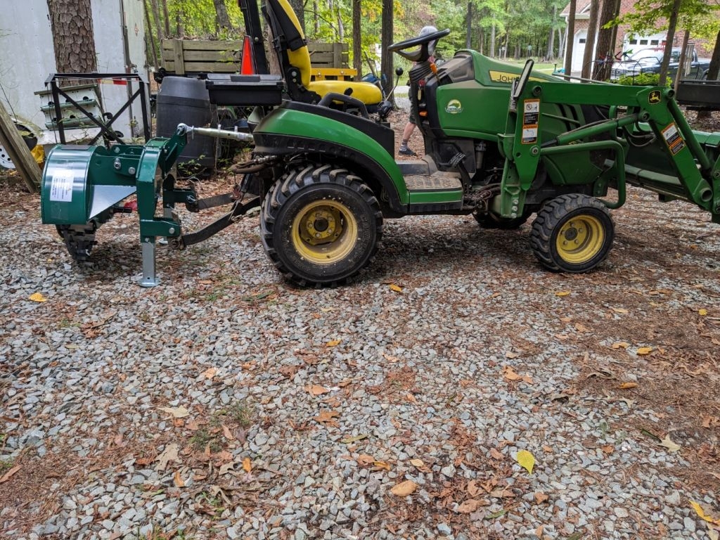

OK pretty much finished up. Loosened clutch springs to slip the plate. Just need to check/adjust slip clutch spring height with some calipers.
Snapped some pics before going in to cool off.
All assembled, Pat's installed, driveline in place..
Magnet mount camera on PTO output shield.
What it sees (mirror view). That can be flipped to normal with a button press.
Where the screen will probably live while grinding. Not making a permanent mount, will remove camera & display when not in use. Both tractors have the same style 12v connectors fitted.
